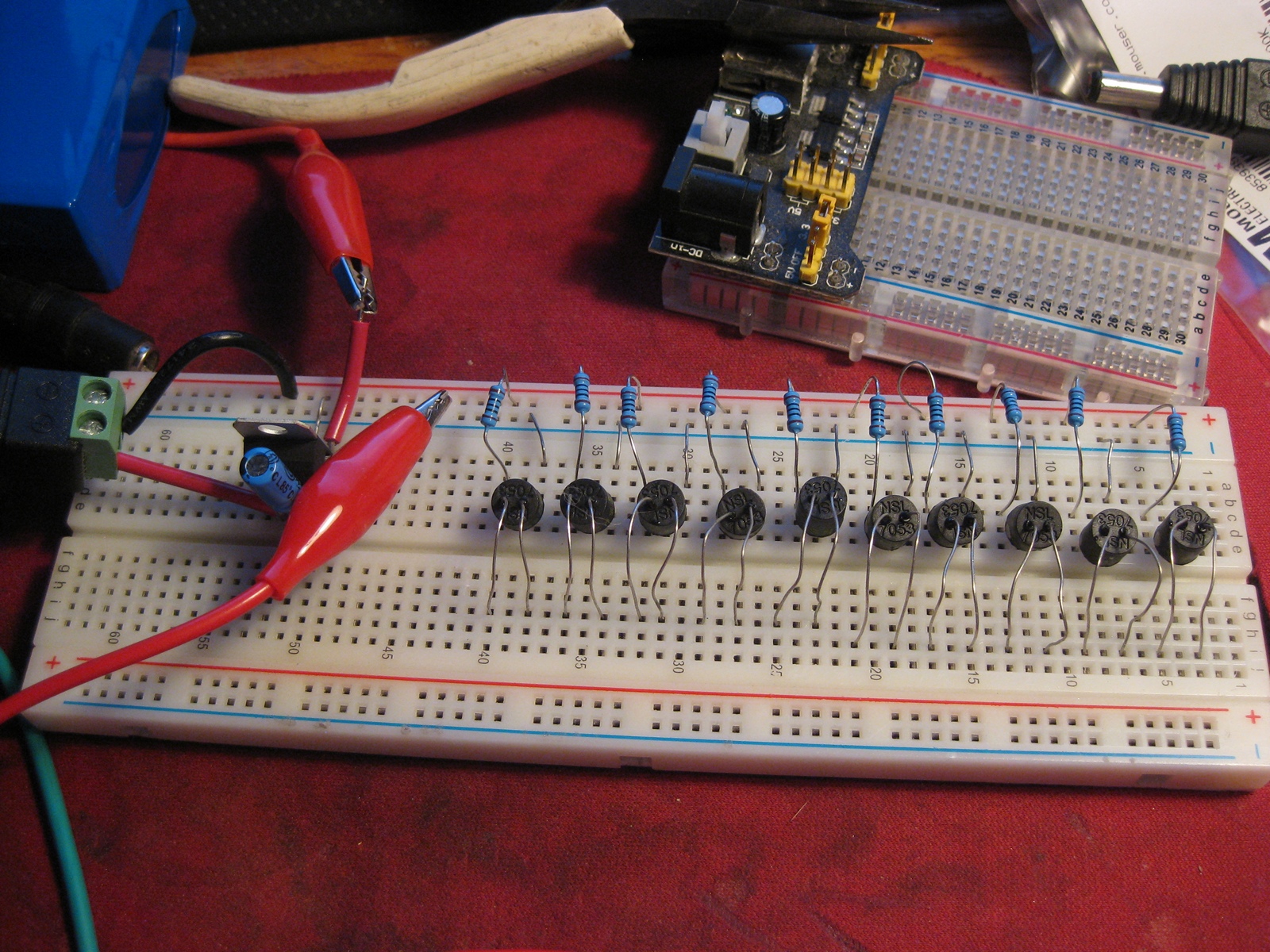

Remember though that some of the NSL's ldrs are not light tight, and any ambient light around them can effect them, you can find the odd one that's not light tight by shinning a powerful torch light on it while matching the resistances up.

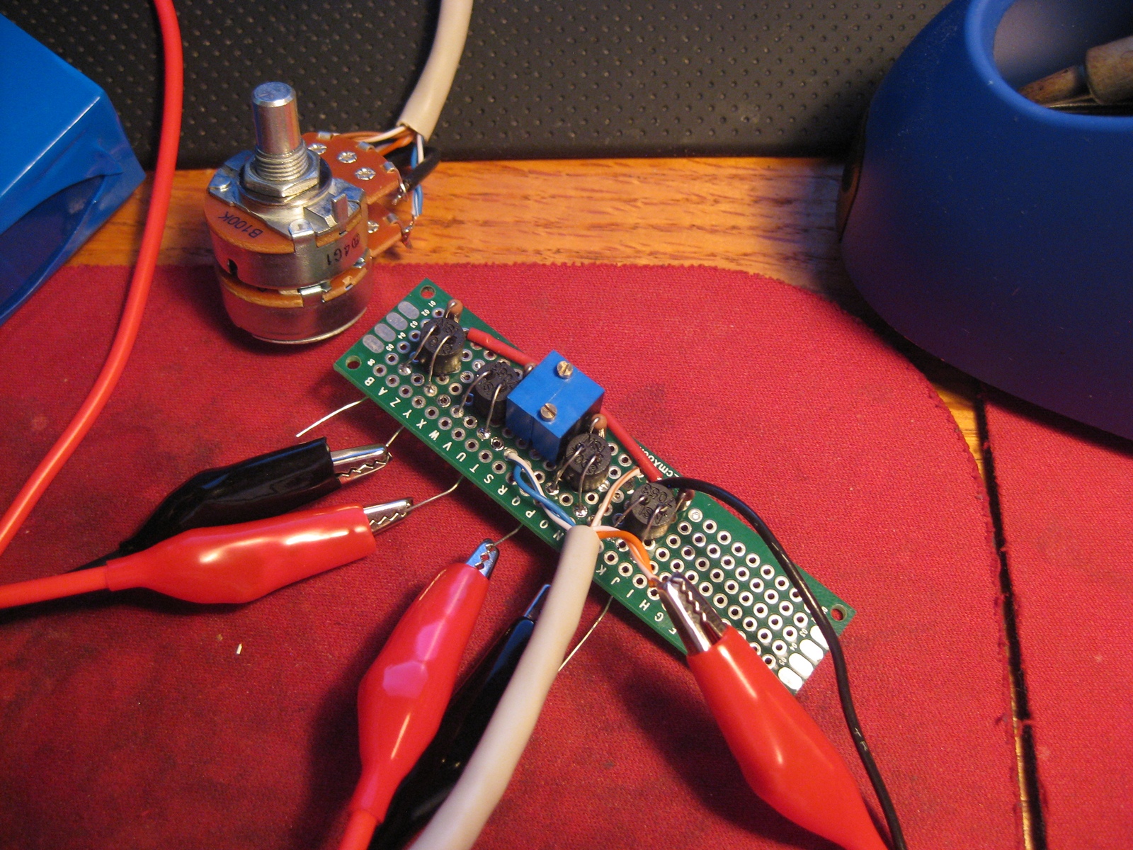

Hi All,
I bought a dozen of these LDR's to experiment with, should really have bought two dozen as i underestimated how much variance they have. I did manged to get four close enough that i can trim them to match and got a board up and running. My question is whats the current consensus in relation to power supplys and bypass caps across each of the diodes?
I've read most of the thread and get the impression 100nf is the norm but i've seen some people went as large as 100uf lytics across them. Would appreciate some insight there. For testing i've just been using a 12v battery supply and 7805, but really looking for advice for the most appropriate power supply to build.
Mark

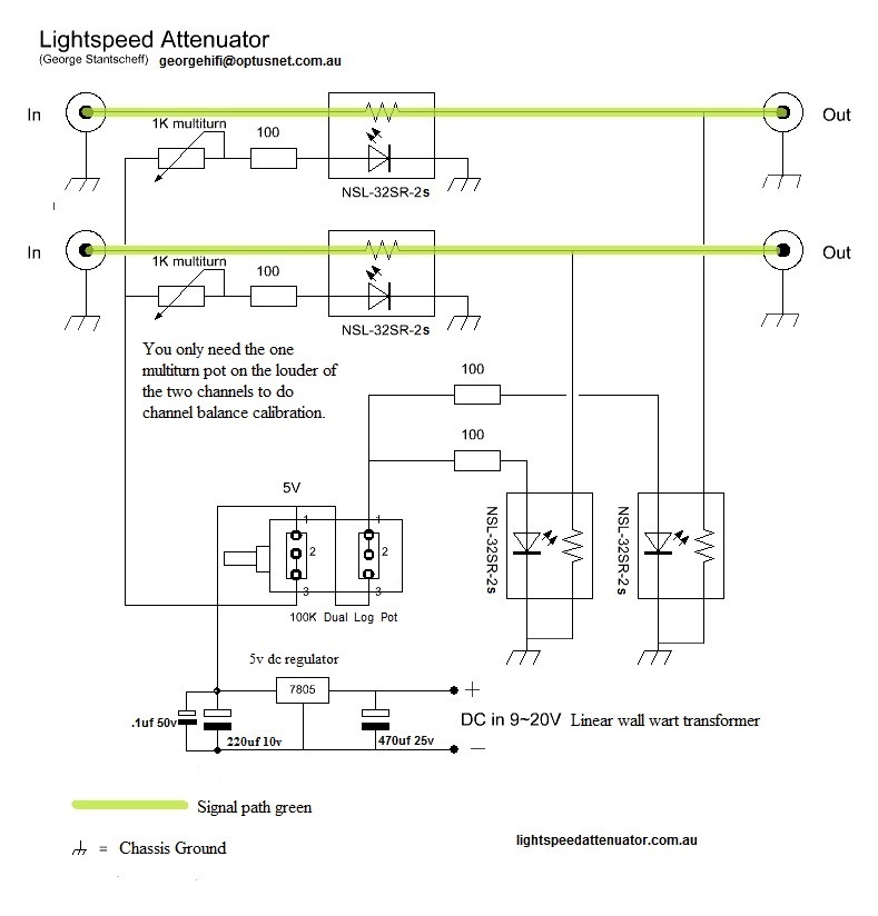

Hi Mark, this is what I use, and never had any trouble with calibration drift, ever!
Cheers George

Thanks George, that looks like a newer rev of the circuit i used to build the board. The calibration seems nice and stable once dialed in, but it does seem to need to run for 20-30mins before everything settles down. This thread just seemed to get lost in elaborate constant current designs which went a bit over my head at times. Is the 7805 good enough, or is there anything to be gained by using more sophisticated lower noise regulators?
Mark.
P.S. Thanks for sharing the design, its threads like this that really make this site :cheers:
It's perfect the way it is, we've done many A/B's with group listens, with expensive elaborate power supplies, and you cannot hear the difference, even with battery power some 10% "thought" they could hear something.
The only time a difference was noticed is when we used a smp wall wart, and this then can be measured with slightly more hf noise on the output. But it's hard to see without a good scope, as it's down around 20uV of hf noise.
Cheers George
I had noticed that as i was changing the volume level with multimeters connected. I actually like the idea of a soft volume change, makes a nice change from the stepped attenuators i am used to.
I also found the tracking isnt perfect between channels throughout the range, but when you think about it you only ever use 1/3rd of the range of a volume pot anyway so i'll just calibrate the two channels to match in that range. I'm suspecting the imbalance is from the 100k pot.
Yes I think it's a nice feel, as you say "soft feel".
And sorry Mark, no the imbalance is not from the 100kohm dual log pot that's impossible, it's because your quad matching of the NSL32SR2S's wasn't tight enough.
Cheers George
