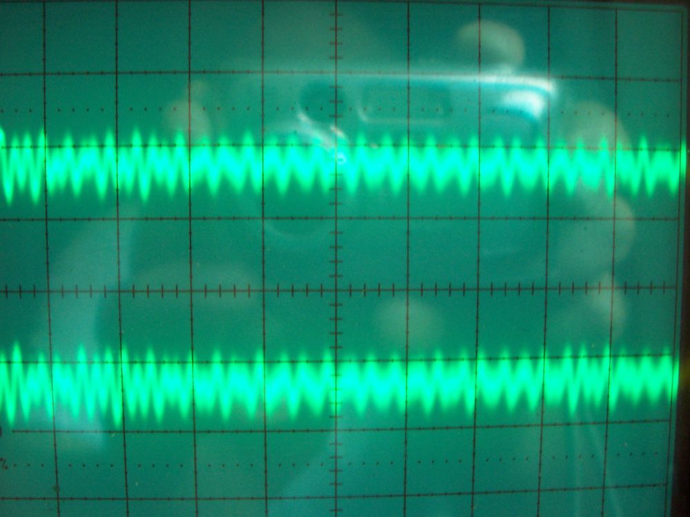

Ok we just did some blind A/B testing of some power supplies.
1 Standard supply that I give with the Lightspeed Attenuator
2 Gel Cell rechargable 12v (Model car type)
3 Alkiline 9v
4 Super Regulated Linear 12v supply that powers medical instruments, about the size of a Besser Block, and as heavy
All 3 three of us could not reliably tell which was playing.
This prompted me to do some screen shots, the Lightspeed is output is terminated with a 50k resistor, volume at 12 o'clock input attached to a muted cd player, three screen shots will follow.
1st With power supply and led - floating
2nd With power supply and led - earthed to rca earth
3rd No power supply at all
In all cases the noise and frequency did not change when the volume was at min mid or full.
The noise is in all cases .02mV peak to peak at a frequency of 185mhz.
I think that these numbers that I have given are the noise and frequency threshold of my Tektronix 400mhz scope and 400mhz probes, not of the Lightspeed itself. Becuse with the probe shorted I get the same figures.
See for yourself the differences in supply confurations in the 3 screen shots all are left channel top trace right channel bottom trace.
Cheers George

All shots were taken within 2 seconds of each other, camera was tripod mounted and my dear wife was doing the conections of the -ve to rca earth and the disconection of the powersupply, 2nd and thrird shot.
What I can now confidently say is that in my setup there is no influcence on the ldr's (noise or hum) by any of the power supplies, conected or disconected, as for hum, it is hum free, and if any hum is detected is is because of system wiring, (loops and such) as the Lightspeed has no hum of it's own.
I say from this that any difference in "sound" detected is of a personal nature, and not because of a change in residual hum or noise in the Lightspeed itself.
Cheers George
Cheers George
