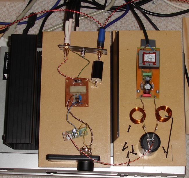

second report on my lightspeed
I have had my lightspeed for about 3 weeks now and I have done various mods to the adjoining equipment and the lightspeed itself so I will tell you what I have found.
My cd player now has a 20 ohm output impedance and I removed the electrolytic o/p cap so I now have about 1V feeding into the LDR's. I put 3.9uF cap on the o/p of the LDR's and this is feeding into my amp with approx 100k i/p impedance.
This group of mods brought more clarity and definition - all good stuff. The only draw back is that if I turn the volume control quickly the speakers leap forward or backward so some care is needed if you adopt this arrangement.
The next group of mods is all to do with power supply and power supply noise. For me this is the area that offers the most radical improvement in quality.
First some philosophy.
for me, one of the biggest barriers to great sound is Power supply noise - both both audioband and ultrasonic. Anything that can be done to reduce this reaps good reward. If RF noise is present ( and most power supplies generate it ) it seems to get everywhere and ruins the sound in the process and I do not regard the "earths" in circuits as being immune for this RF pollution.
back to practice.
First step I took was to remove the power line inside the box from the back socket and power the regulator with directly from a 9V alkaline battery. I you have already tried a 12V lead acid battery I would suggest you try an alkaline - they have the reputation of being much quieter and I have found that LA batteries need parallel capacitors to give half decent results.
The alkaline battery sounded really great - more transparency and detail and also very smooth - but of course this solution becomes tiresome and expensive with time....
So I built a VERY quiet power supply and fed it in to the regulator board. It has CRCRLC plus snubbers at all stages. This sound very nice also - very smooth but seemed to loose some dynamics / detail - just a tiny bit - but noticeable.
final stage in next post ...

The Ultimate Mod ???
For a few days I had been thinking that we are missing a really great opportunity with this design.
That is to completely isolate the LED circuit from the LDR circuit. This will mean that any stray noise coming from the power supply OR regulator will have absolutely no physical conductive path to the - i/p, LDR, o/p - side of the circuit.
This is the last mod I have done and I do not think that this design can get any better than this ( but I would love to be proved wrong ! )
With this mod the clarity, transparency and ultimate refined quality is better than anything else that I tried.
Now the only connection between the LED circuit and the LDR circuit is light.
Sorting this out requires some thought - I did not even want the potentiometer attached to the box - which at present is carrying the earth return signals.
On George's original design this mod involves breaking the earth tracks under each LDR and moving the regulator output ground wire from the terminal block close to the rear of the box and reconnecting it to the two zero volt connection point between each of the LED pairs.
Many thanks for this design George - I hope you, and all here, enjoy the results of these suggested mods as much as I am enjoying them.

Re: second report on my lightspeed
To cure this problem, I would put a 10uf polyprop at the output of cd player and direct couple the Lightspeed to the amp, this will cure two of your problems, no dc on the LDR's and no woofer flapping if you turn up the volume too quick.
And my calcs with the Lightspeed at 7k input you will have a -3db at 2hz which is fine. Certainly doesn't look what I sent you a couple of weeks ago any more.
Cheers George
mikelm said:
My cd player now has a 20 ohm output impedance and I removed the electrolytic o/p cap so I now have about 1V feeding into the LDR's. I put 3.9uF cap on the o/p of the LDR's and this s feeding into my amp with approx 100k i/p impedance.
Cheers George
George - I am just listening some more - this isolation mod is really the business - much clearer that just with an alkaline battery.
It may be that with this isolation mod, even a cheap PSU sounds fine. I will check it out and report later
10uF in CD player ? - yes but I could not squeeze a cap like that inside my player without some more work.
Now back to some music ..
mikelm said:George -
Then you can put it in the front of the Lightspeed
Cheers George
