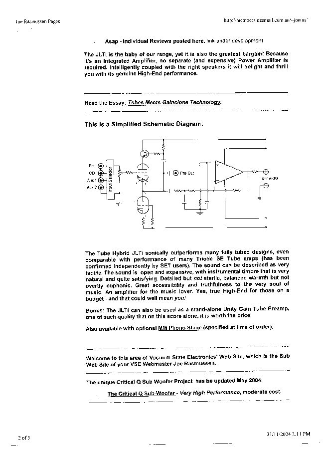

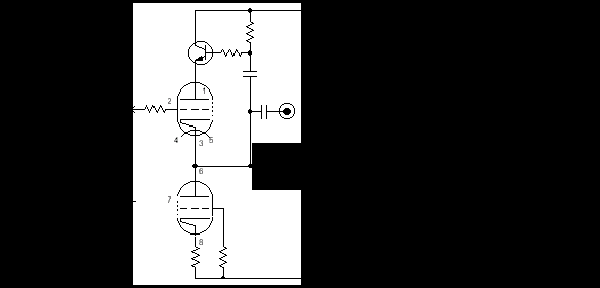

Hi George,
Care to share more details on the parts? That's a JLTi front end for sure. Hopefully Joe Rasmussen does not mind. Buy hey, we're here to DIY. Look how generous Mr.Pass is
Will said:
Hi George,
Cause he won't mind it was posted on his web site, I've asked Allen Wright (I think it's his design) to answer you, to fill in the values as I won't even though I know, it's not ethical, it's up to him now to respond. Here is the page in full that was posted.
Cheers George

Will said:
Hi George,
Will Allen has replied, and this is what he (edited) said, I, get onto the moderator and see if I can sort it out.
Quote> George,
i would be happy to contribute to this thread but the ------- STUPID forum won't allow me to look at or post anything.
I don't remeber the password I joined with, and when I request:
1/ a password reminder I am told my email is invalid
2/ or when I try to join newly, I'm told I'm already a member - so go back
to problem #1
Just flat out STUPID!
And I can't find anyway to reach a moderator etc
Allen <Quote
Cheers George
