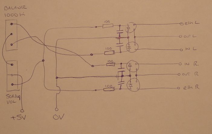

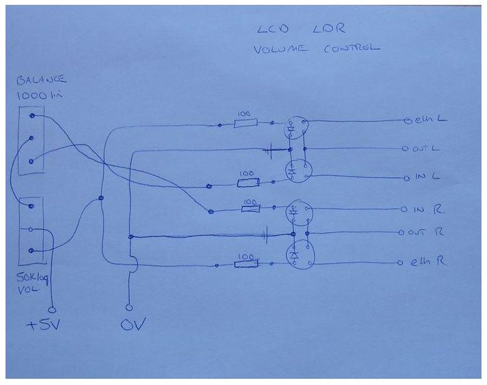

UPDATE on my LIGHTSPEED
I now feel that I have done all the mods that I can think of to my lightspeed - and I am very satisfied with the sound.
I did 2 things since I last posted.
The 1st is just a balance control instead of the trimmers. No positive impact on sound quality but more importantly no degradation - and in those circumstances - handy to have.
The 2nd mod is the earthing arrangement in the signal paths.
I attached a pic & cct diagram in following posts
I insulated the the phono sockets from the back panel and then routed the earths for each channel completely separately so that the only place where the earths are common between channels is in the source. I also soldered the bare 0.5mm copper wire directly onto the phono / RCA sockets for a more direct signal path.
The other factor that may explain the benefits of this mod is that the signals in the earth return legs do not now return through the aluminium back panel so avoiding potential problems with the aluminium oxide ( an insulator ) which I though may create problems with ultra fine signals of a few microvolts.
Between these two factors, of this 2nd mod, ( given the fact that the power supply is floating ) the sound, for me, was much clearer & cleaner
Many thanks to George for introducing me to this LDR concept.
I put my S&B 102mk3 back in yesterday and I know now that I can never go back to TVC's. They sound so muddled and confused when compared to these LDR's.
cheers
mike

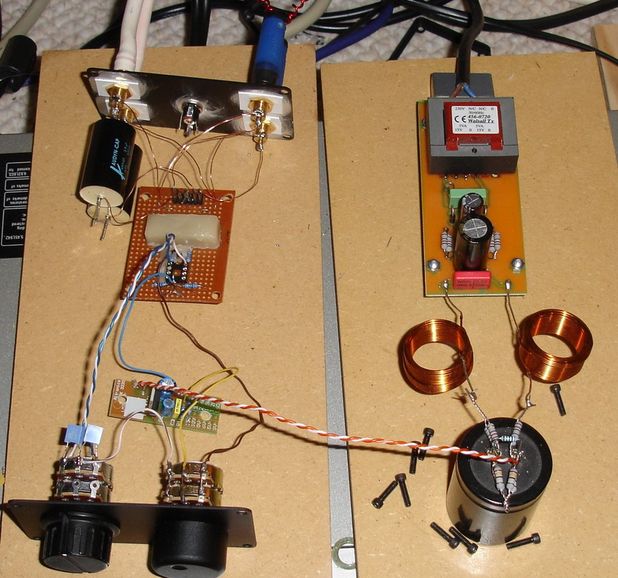

Try moving chokes
Mike,
I t is most likely just in my mind, but I liked the chokes in mine connected directly to pots. This way there is a reg, CL load. Itried running one choke to each channel and also one to hot and another on ground. I could not hear any differences so used one for hot and the other for ground.
I do not completely understand your grounding, but isolating the signal from the power is one of the great things that these allow.

Hi George,
I like your idea with the chokes and will try it. Also the ultimate filtering mod would be some small caps across the actual LED's.
The other things about the power supply that can mess things up is the resonance and RF noise, that the diode switching causes, backing up into the mains supply. A CRC filter on the input to the transformer helps with this. Also snubbers to reduce the frequency of, & damping of, this resonance.
To get best effect from this every piece of equipment plugged in needs this arrangement.
Caps have to be rated for mains voltage.

Ok guys, you have jumped ahead and I need to catch up with you on the inductor and cap mods for the LED's. Please give me the values and schematic location for same if you don't mind.😉
I just finished building mine into a bread toaster.
My inductors are 0.05mH from parts express ( 255-200 ) so they are not dealing with low frequency noise. I am still experimenting with position.
I would suggest about 1uF directly across all 4 LEDs

here is my circuit diagram with caps added.
you can see where my inductors are at present my looking at the picture of my current setup ( a few posts up )
I will experiment and see it other places sound better and will post if I notice ans improvements.
George - ( Houston ) may explain more where his are located I did not quite get it either yet
mike
mike
