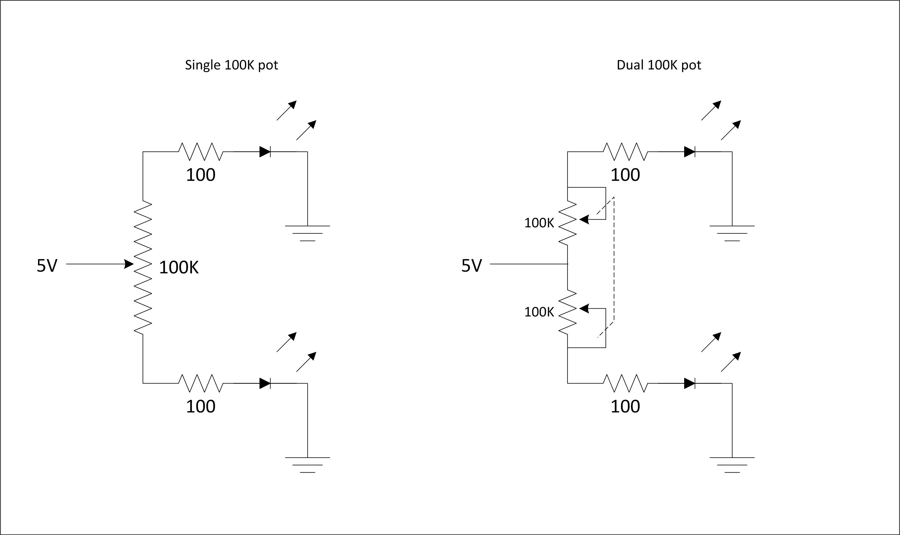

I am getting all the parts to assemble my preamp and I am having trouble sourcing the 100K dual pot.
My question is, why the dual pot? Is the reason to limit any current via the wiper? I have a hefty good quality single 100K pot. The pot is not acting as voltage divider, but as a reverse variable resistor to limit the current through the led. Am I missing something?

The reason for the 100k dual log is to share the current, and to have a nice progressive feel, slow progressive to start all the way to 2 o'clock then ramping up fast after this.
Mind you this only has this kind of progressive feel if the NSL32SR2S are a close quad matched set, if they are only pair matched it can start too quick or way too slow and have nothing/too much in either half of the rotation.

RV24BF-10-15R1-A100K Alpha (Taiwan) | Mouser
Cheers George

Can you elaborate why a single pot doesn't accomplish the same thing? If both are linear then the resulting resistance from both sides of the wiper (or common leg on dual pot) should add to 100K. If one side has 75K, the other side will have 25K, etc... Wouldn't the matching of both sides of a single pot be closer than two opposite sides of a dual pot?
I must be missing something right in from of me.
Thanks for your assistance.
The current of two led's on the dual per track against the current of all 4 led's on a single. You must know that pots carbon or plastic don't like DC on them at the best of times, this minimizes the amount of dc.
Try it with a linear 100k dual and it will behaved very differnet, too much too fast, and you have to remember the NSL's are not linear either in their resistance and led intensity overhaul span, this has a big effect on it.
Cheers George
Cheers George

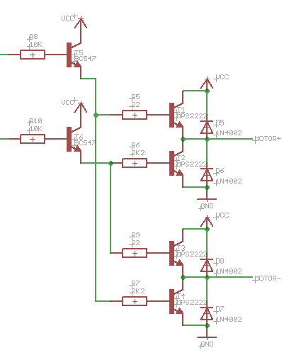

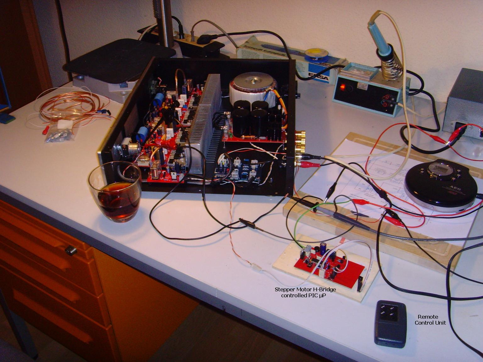

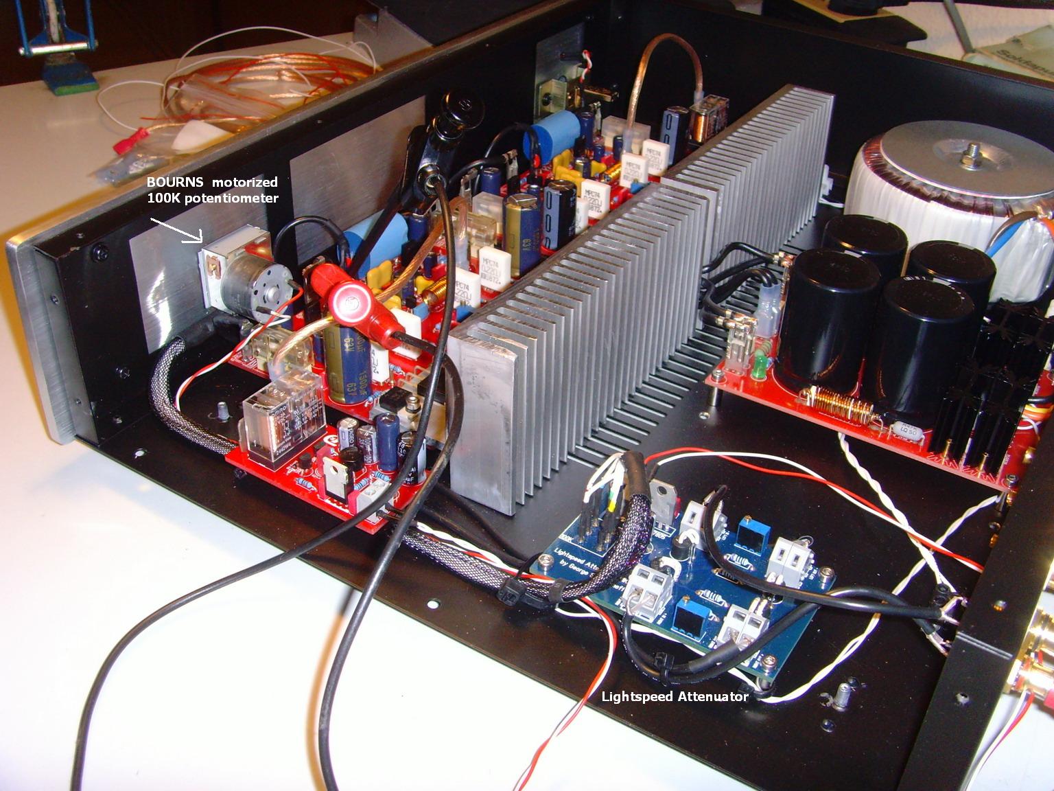

I am currently working on a remotely controlled, motorized-potentiometer version of the Lightspeed-Attenuator (see attached images).
The additional PCB contains a stepper-motor H-bridge and a PIC µProcessor to implement the RC5 - remote-control software and to
drive the stepper-motor H-bridge.
The hard- and software - design is based on an idea / project, presented by FOTIOS.
The prototype - as shown on the images - works flawlessly.
I have re-worked the layout of FOTIOS' original PCB and added a transformer for +5VDC supply and a ICSP-header
to interact with the PIC µProcessor. (This interaction is not necessarily needed!)
I want to order professionally etched PCBs soon.
If somebody of you likes this idea and wants to have as well: please send me a PM.
Best regards - Rudi_Ratlos
