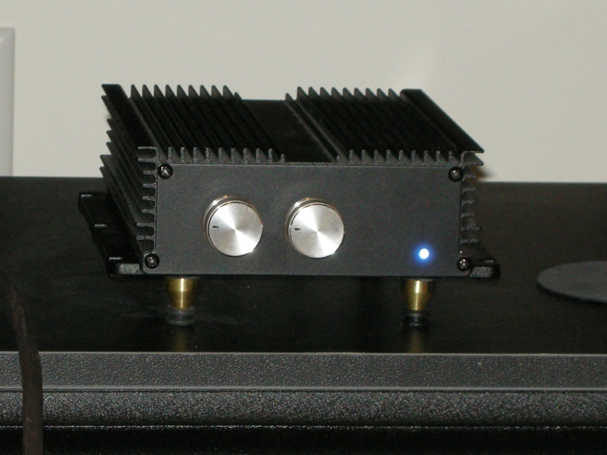

George,
I found a little problem on my volume lately. I had it on 24/7 for several months and it sang for me with no problem, but lately I've found the left channel sounds louder than the right when I turn it up to above 11 o'clock. I have both channels checked and the resistance of both channels are the same when in 9 o'clock but starts to vary from 1100 ohms to 1306 ohms when I turn the pot up to 11 o'clock. The more I turned the volume the larger the variation. I have the 1k pot tuned but with no avail. I then put another 1k pot on the other channel but it doesn't work either. The 5v B+ is absolutely stable. Is something fired or ?? Please do advise.
Albert
Albert
.... Is something fired or ?? Please do advise.
Albert

I have it checked unload - No hookup to anything.
I can't remember Albert did you build this diy Lightspeed inside a pre or poweramp or is it a stand alone unit?
Cheers George

A stand alone unit.
Seems to me then if it was not a fluctuating heat issue, that can happen if instaled inside pre or poweramps.
That maybe you could have had some very strong dc offset or test bench type audio signal come into the input or output that has given your ldr's a bit of a hammering, this can change their resistance character and unmatch them. Time to get another matched set.
Am I right from your pictures that you have separtate left and right led volume controls? And did you say they were 1Kohm?
Cheers George

No, mine is a separated / stand alone unit. I posted it on this thread but couldn't find it.
Don't understand either, It has been playing for me after finished. I didn't touch it until couple days ago.
A single Alps dual 100k pot.
There was only one 1k trimmer on the louder side, but I put another one on to test after I found the problem.
Oh, is there anyway I could try / test it before I talk to Uriah for a new set.
Albert

It is possible that a dual 100k pot can have problems, but this would show in both channels equally, as a jump or lowering of both channels equally. But seeing you have a single dual pot and have wired it as I've shown in the Lightspeed Attenuator circuit, controlling both channels it takes the pot out of the equation because it's only happening on one of the channels.
Before installing another quad set of led/ldr's you could question your 1k trimmers they are far less costly to replace than the matched ldr's.
And btw you only need one trimmer, and it goes on the louder of the two channels.
Cheers George

thanks n I will change that trimmer asap. let U know.
George,
After replacing the 1k trimmer on the louder side, the case remains. I then move to question the Alp volume pot. I couldn't find the dual 100k, but there are 2 single turn Bourne 100k pot, blue in color, sitting on the bench. I make the conversion in no time and it works perfect on test, and I put it to the system and it sings flawlessly well. The only drawback is the pots are not log pots and it's too sensitive to make adjustment. I just have to turn 2 mm to the volume I need. Is there anyway I could make improvement with these pots, or I have to buy new ones ????
Albert
Albert

George,
I brought 2 single A100k pots in local store to replace the Bourne and now I have more room to tune. Everything back to normal as before. I can recall I read somewhere that you mentioned I should put the volume half way when not in use, say 12 o'clock. I'd love to know more since my intention is to keep it on 24/7.
Albert
Albert
Good to see you have got it going again, but you know you still have a damaged/unmatched set of ldr's, but by using separate l & R volume controls you have, band-aid fixed your problem.
Yes volume left at the half way posistion will turn on the led's at only half brightness when your not using it, and hence make them last twice as long.
