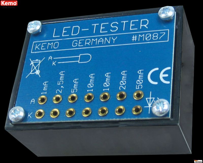

Get yourself one of these led testers and a cheap digital multimeter that way you can match your own ldr's from 1-20mA at 5 different levels.
As for using only 4v insted of 5v naturaly the 100ohm current resistor on all the + legs of the NSL32SR2S's of my circuit would have to be smaller otherwise you won't get enough sweep (low volume).
Cheers George

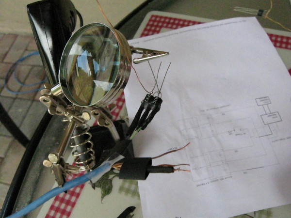

Another approach to Potting and balance tracking
For what it's worth, I took another approach to mounting that has worked very well over time.
I wired the LDRs tight together and in fact glued them together with silicon cement. Then they were encased in some shrink wrap. This allowed me to put the attenuator right on the amp circuit board making for very short signal path. The voltage side of the LDR was run via CAT5 cable to the light speed power pcb where the pots for volume and balance reside.
Result? Perfect tracking. Despite having a balance control, I have never needed to touch it for changes in balance due to volume setting. I do have to touch up the balance for some CD's that simply are out of balance on the recording, so the balance control is simple and worthwhile.
I built this in August 2007, and it is running perfectly providing amazing music ever since. My only changes to my implementation over time was to improve the power supply which does improve the SQ.
I am now building an second lightspeed to serve my new amps.
Cheers

You have touched-on some implementation details that are very important. (And it sounds like you did an excellent job implementing yours.) [The following is just general informaion and is not necessarily directed at only you.]
A short signal path IS important. It helps in not making an antenna. And it helps in minimizing the conductor's self-inductance. It's even more important to be absolutely sure that NO GAP is left, anywhere, between each signal conductor and its corresponding ground, on their way to and from the attenuator. Otherwise, you've made what's called "enclosed loop area". Another name for that is "antenna".
Any time-varying magnetic or electromagnetic field will induce a corresponding time-varying current in the loop (See Faraday's law.), in proprtion to the geometric area enclosed by the loop, and the strength of the field.
So twist the signal and ground wires tightly together, with at least four turns per inch, or, better yet, use shielded twisted pair, with the shield connected on one end only, to chassis ground (NOT to signal ground!). Hopefully, the AC Mains pair will be tightly twisted, as well as the secondary pairs, and the pairs connected to the inputs and outputs of rectifiers, and the output pairs, and the heater pair if it's a tube amp, and even the DC power and ground pairs, because all of those can and will act as transmitting (and receiving) antennas! (With PCBs, either use a ground plane everywhere possible, or put the pair's traces exactly overlapping on opposite sides of the PCB, or, if single-sided, keep them very close together, everywhere. RF (Radio Frequency) signals can also cause insidious effects, which are sometimes very subtle, which can make them very difficult to even identify, much less determine their source or eliminate them.
Your idea to have close thermal bonding of all four LDRs is a very good one. Encasing them then helped greatly, too. They could even be surrounded by a small metal box, perhaps with a resistor to act as a heater, so that the little oven's internal temperature would swamp-out any changes in the temperature outside the box. But you correctly understood that the main important factor is to not have changing differences between the temperatures of the LDRs, i.e. relative to each others' temps. Combining them all into one physical mass, with large contact areas between them, gets you most of the way there. Also then wrapping or potting or boxing them all inside of a single enclosure gets you almost all of the rest of the way there (and is probably more than good-enough). Doing that well-enough would enable you to place them almost anywhere, and there would be definite advantages to having them located as close as possible to the original signal path.
