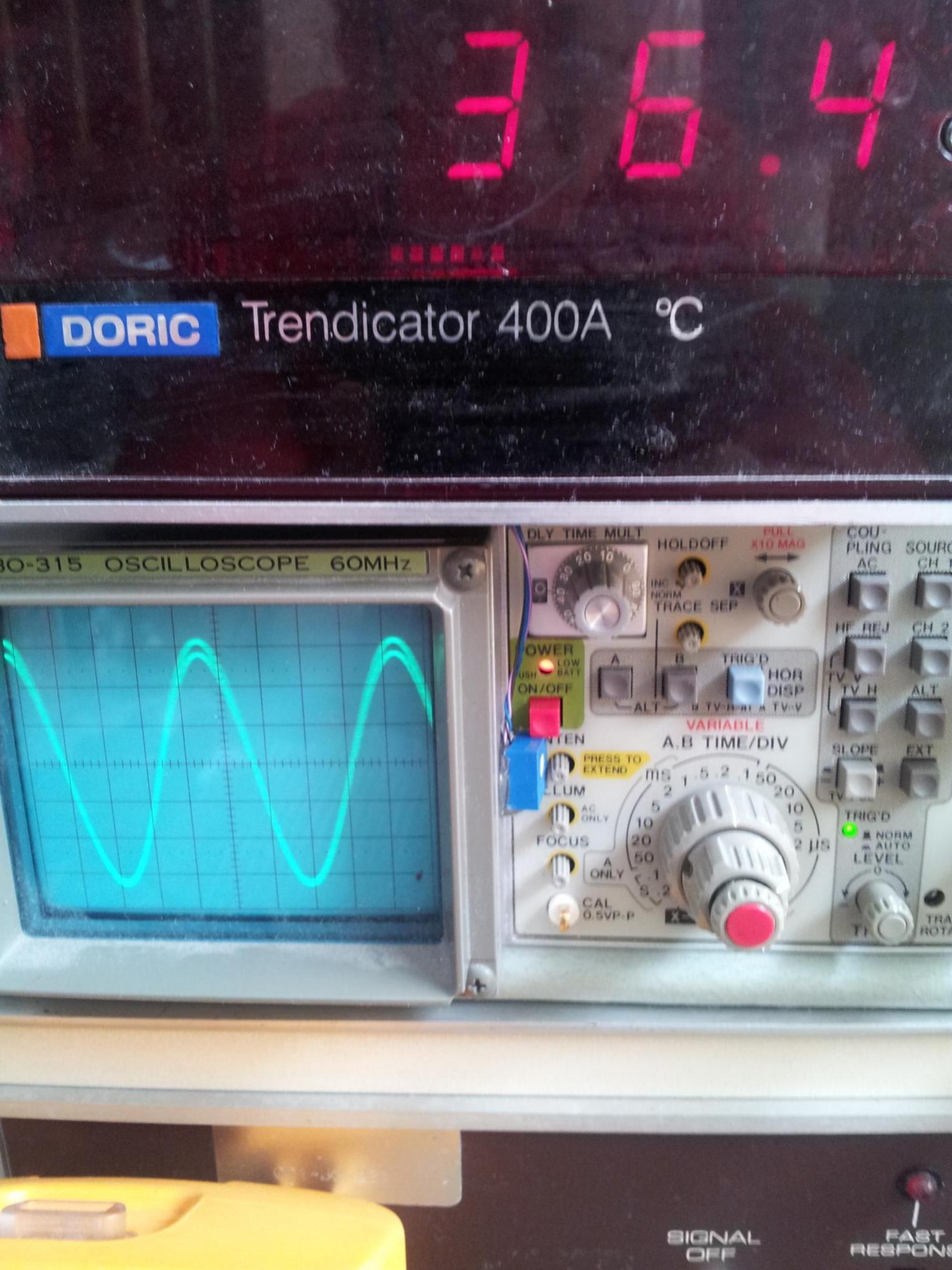

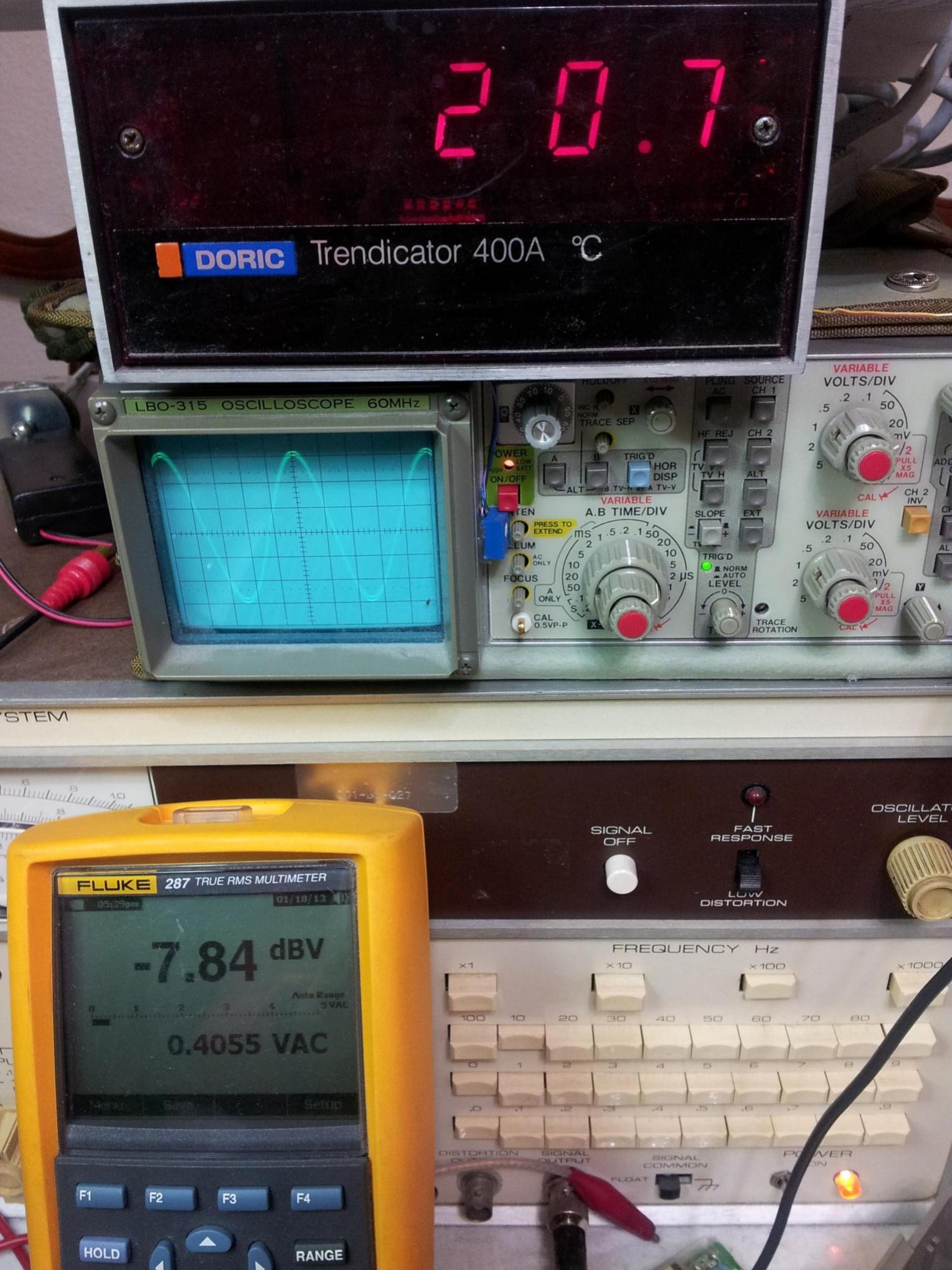

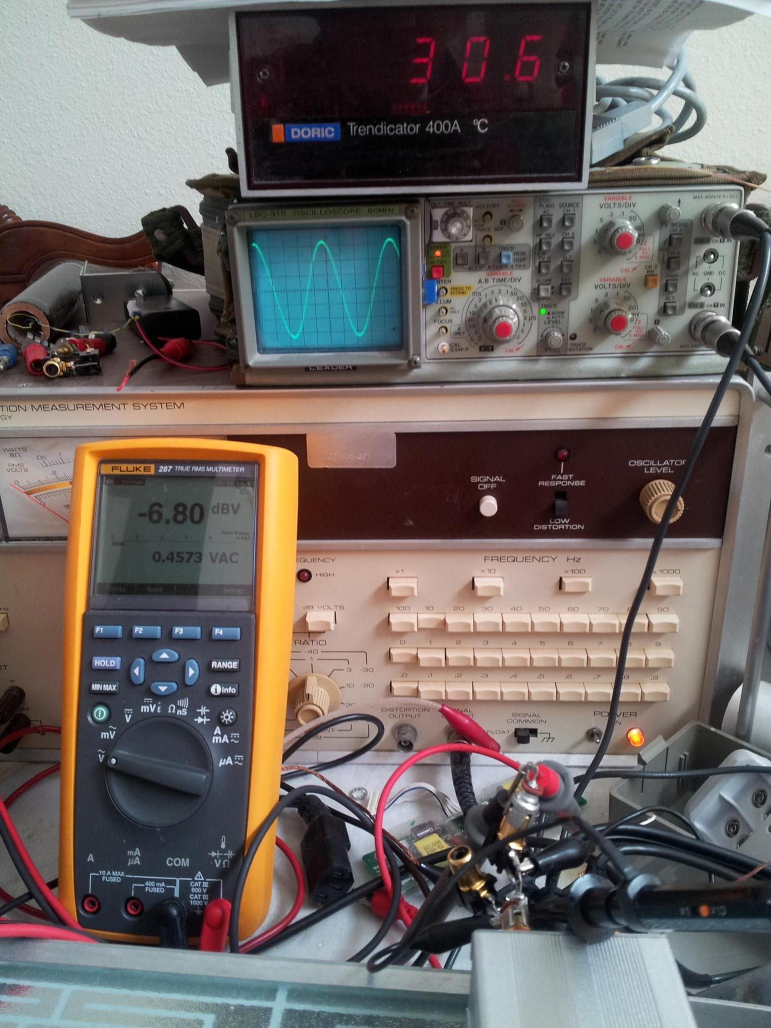

Yes, the LDR are so sensitive to the temperature changed, after many tries, I had built one with temperature compensation, I can used any LDR as it can go to 50 ohm or below, I used four pots to adjusted each LDR, I can calibrated it from 5k to 50k ohm ranged. I had put the attenuator on a hot plate, heat up very slow from room temperature to 36.4C and the channel balance changed less than 1db. Set up as: input signal 1 khz 1.5 vrms attenuator=20k
volume set at 12 O'clock. At 20.7C L channel = -7.42db R= -7.84db
at 31.1C L= -6.59db R= -6.80 at 36.4C L= -6.83db R= -7.40db
Thats pretty "COOL"! 🙂 How do you compensate for temp? Are you using something similar to the temp comp on a LM334 or are you using thermistors in parallel with the control pot? I suppose that would only work in higher resistances.
I am not used ccs or fix 5 volt, my designed was variable the voltage to
the LDR led, I used thermistors to compensated the voltage to the led.
It only need to compensated uv/degree, with variable voltage I can used a switch to changed the output voltage to the LDR's and the resistance will changed, this design the attenuator can had multi resistance value.but I found two is good enough high or low resistance, high/20k for my tube amp,low/10k
for solid state amp.
