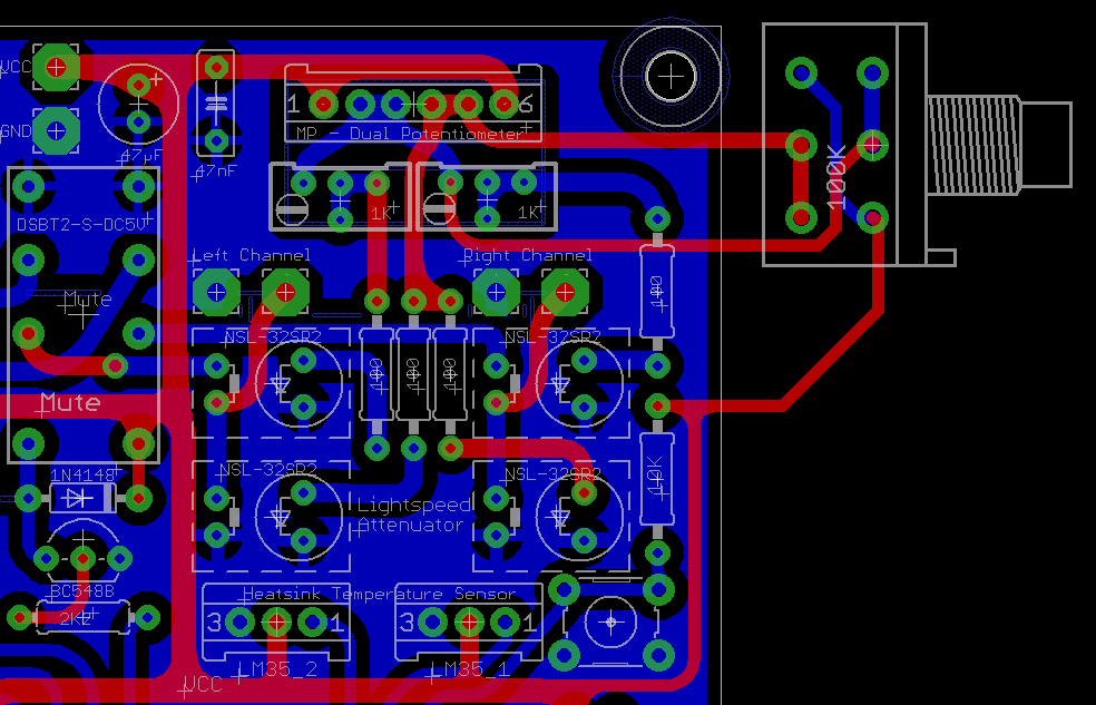

Hi
I overtook some old project from a friend. I dont know what GB it came from, not how it was matched (or not) and in fact I knew little about the cards so I started to investigate them.
My plan is to investigate if I can use them for an 8 channel DCB1 build. As you can see on the pics one card has bridged pot-holes, and the other varies. The left two has red 2 k variable multi turn resistors, and the one to the far right has 1 k singleturn variable resistors.
I hooked it up on a 5 V supply with a dual 100k pot for starters, and then I hooked up a signal generator and my scope on the in and outputs.
I putted the 2 k variable resistors somewhere half ways and also the 1 k (on 0,5 k) and started sending in 1 V squarewave 1 kHz. It seemed like the outputs has signal to the left and gnd to the right, looking at it from the top. But the channels also seems mirrored so one has input to the left and output to the right and the other one vice versa.
My measures says that the two card with the red variable resistors put to 1 k "works", ie they give an increasing signal when I turn the main 100 k pot. The bridged card and the one with blue pots seems so give very low and not increasing values.
So, some first questions to give me a push on my investigations:
Anyone knows what GB it came from and if there are documentation somewhere?
What suggestions do you have regarding main pot and card mounted pots? Shall I keep the 2 k pots on the boards and try find similar? Shall I decrease value on main pot?
That will be enough for starters
Best regards
Staffan

Thanks George. Shall I stick to dual 100 k? Any wattage to talk about over the board mounted ones? I have some 1 k laying around, I think I read somewhere that its the recommended setup? Unfortunately the once I have is with solder pins in straight line, boards are made for pins with offset on the middle one. I guess theyre 0,25 W or so.
best regards
Staffan
best regards
Staffan
1k .25w is fine but you must use a several watt pot for 100k as long as its running all those boards. See AndrewT's comments a few years back on pot ratings. Assuming 5v at 20mA per ldr is not going to result in a long life for your pot. Maybe a wirewound pot of 3-5w would be a good selection.

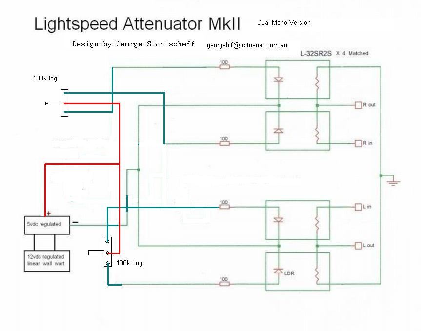

Hi all,
I've just completed my second attempt at building a lightspeed thanks to 4 LDR's that arrived the other day courtesy of Uriah.
It plays at low volume, sounding quite thin, but neither the volume pot or the trimmer pots are having any effect unfortunately. I followed this diagram - just wondering, is the wiring for the pots correct?
apologies for the crap picture
Any advice appreciated. Thanks.

Just saw you are using dual mono volume control (led controlers) this is the circuit for that.
Cheers George
I think that's certainly different to what I've done. I'll give that go. Thanks George.

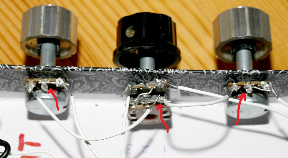

It plays at low volume, sounding quite thin....
hope you got it fixed
but gosh.... you really need to look closer at you soldering quality too
please use magnifying glass and check everything carefully

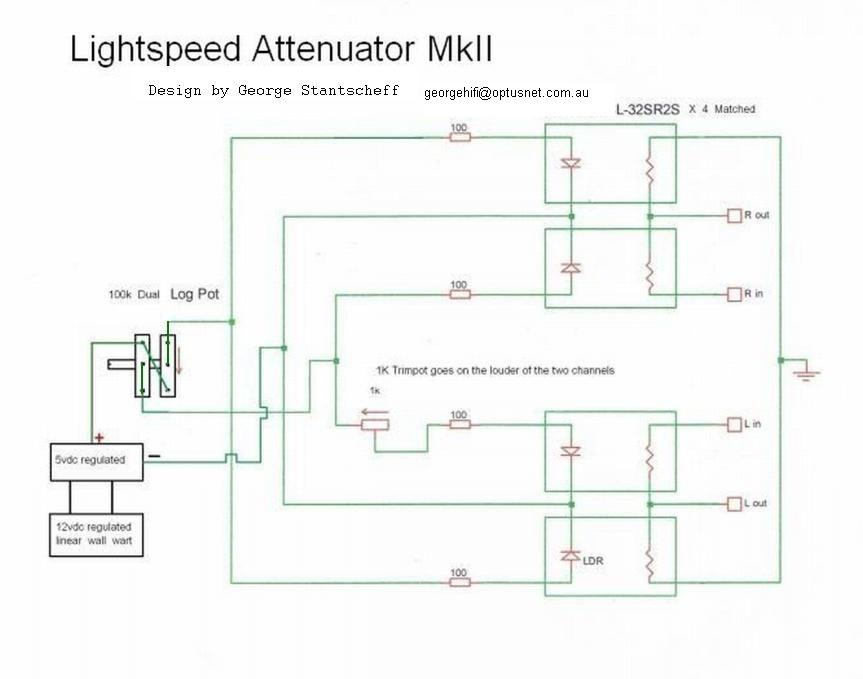

got some time over the weekend to get back this. Uriah is right, mine is a 3 pot configuration as in the original schematic posted.
This is what I tried to build:
Uriah, when I originally questioned if it was 'wired correctly' I was referring to the schematic above, but I understand what you're saying - I'll post some more pics of the full build.
I realized George's schematic wasn't quite the same soon after he posted it. I might try that design if I can't get this to work. But for now I'll go back and recheck my build again.
tinitus, yes I know it's a bit of mess but those pots were 'donated' to me from another LS amp and were already scruffy. I'll recheck everything, just wanted to check I'd wired it up correctly in relation to the above schematic.

The "schematic"/drawing I posted years ago that you show is correct. It was made for folks who have trouble with schematics. The Lightspeed is often a first project. If you rewire anything please use your thinnest wire to be kind to the pots and ldrs. Heat is bad for both and thick wires take more heat. Please make sure the ldr dots are going to negative/0V. Also make sure that the ldr long/round leads go to signal and short/flat go to power. These are often the reason for thin sound because the ldrs are at megohms.
