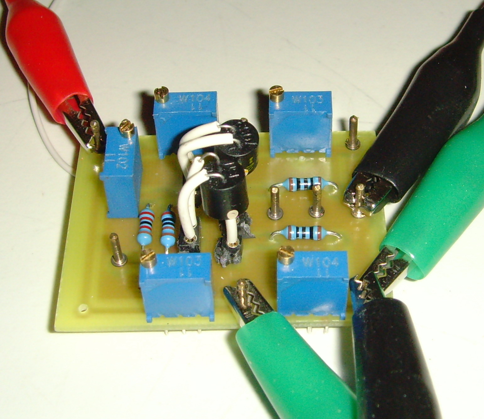

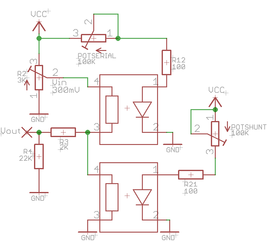

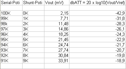

I want to add the level of attenuation of the Lightspeed Attenuator on my LCD-display, etched a little test-rig and measured Vout in relation
to the position of the wiper of the 100K potentiometer.
Since I do not own a precise 100K potentiometer I "simulated" it by 2 x 25 turns trim-potentiometers.
The reference input signal is 300mV. As a load I used the resistor input network (2K / 22K) of my FC-100 amplifier.
After 10 measurements I noticed that the LDRs behave very linearly.
A 1% decrease of the potentiometer's value (going from 100K -> 0K in 1K steps) results in a 1% increase (3mV) of Vout.
Is this really so? Do I have to measure any more?
Is my 300mV input signal a recommended value for any music-source?
Best regards - Rudi_Ratlos

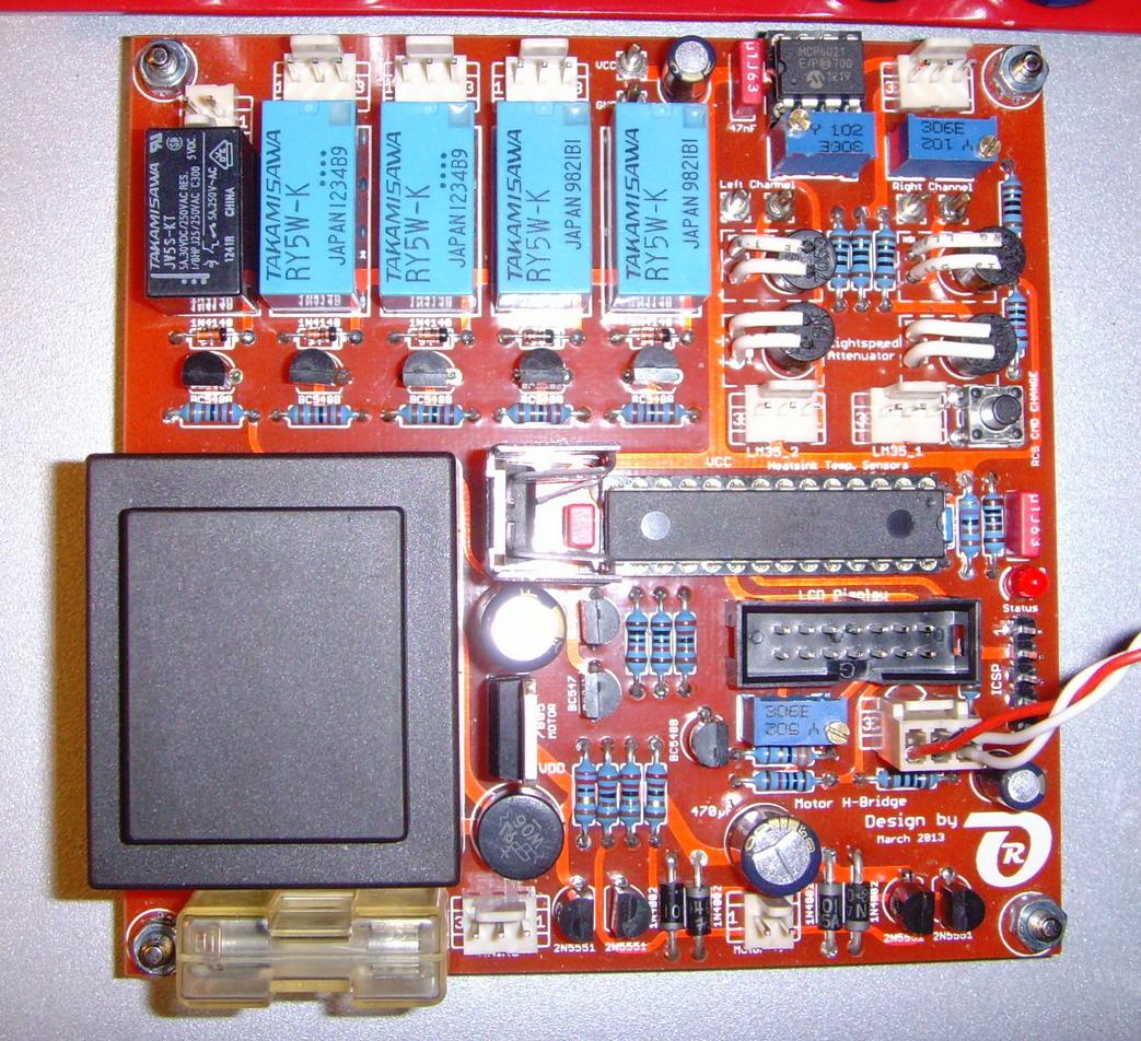

Hi Rudi, planning to offer your pcb board for sale. Thanks.This is my Lightspeed Attenuator PCB.
I have connected an OPAMP MCP6021 to the 100K potentiometer section wiper's output that drives the linear LDR.
aeonsys
Rudi, I am looking at your photograph and the MCP602x datasheet. I guess the 8 pin DIP in the upper right corner is your 6021, but I can't visualize the function of a single op-amp in a circuit where there are two pot sections and four legs to be controlled. If the purpose was to offload managing the current from the pot onto the op-amp, I would think you'd use a 6022 or 6024 with two or four amps, so that can't be it. Could you tell me what that single op-amp does, please?
