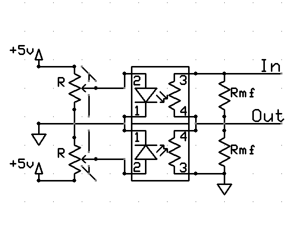

George, I'd like to ask your opinion about using metal-film resistors at the output of an LDR potentiometer as pictured.
I understand that they will affect the response curve of the pot; however, I'm mainly interested to know if you believe that they would adversely affect the sound of the LDR pair. What do you think?
Not only the respones curve but also the min volume achievable, and the nice log feel to the progression of the level control, this is why it is as I have found always better to quad match all the LDR's and not try to short cut with buffering ressitors.
As for the sound of resistors, some think they all sound different when in circuit, and some believe that the unique sound of the Lightspeed is due to the composition of the LDR itself, as well as no contacts in the signal path.

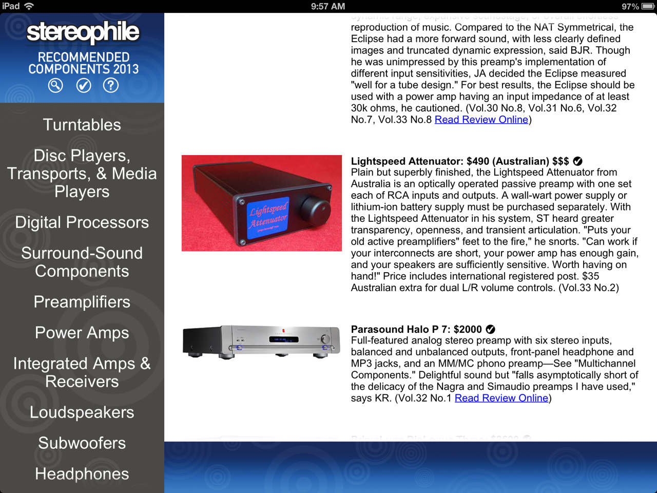

Lightspeed Attenuators owners and diyer's, I've just been informed again by Stereophile, and you'll be happy to know that your Lightspeed has just made it again into the Recommended Components with the highest 3 x $$$ rating for sound and value for money in the next issue.
You can download it free via Apple Ipod from the Stereophile website or wait for the hard copy to come out.

I downloaded the app, but not sure what to make of it. Have not found the light speed on it.
Someone who downloaded the app sent this to me, as I don't do Apple myself.

Even the layout of the app looks different.Someone who downloaded the app sent this to me, as I don't do Apple myself.
Its a Screenshot of the Stereophile Recommended Components 2013 App. You can get it at the App Store free.
