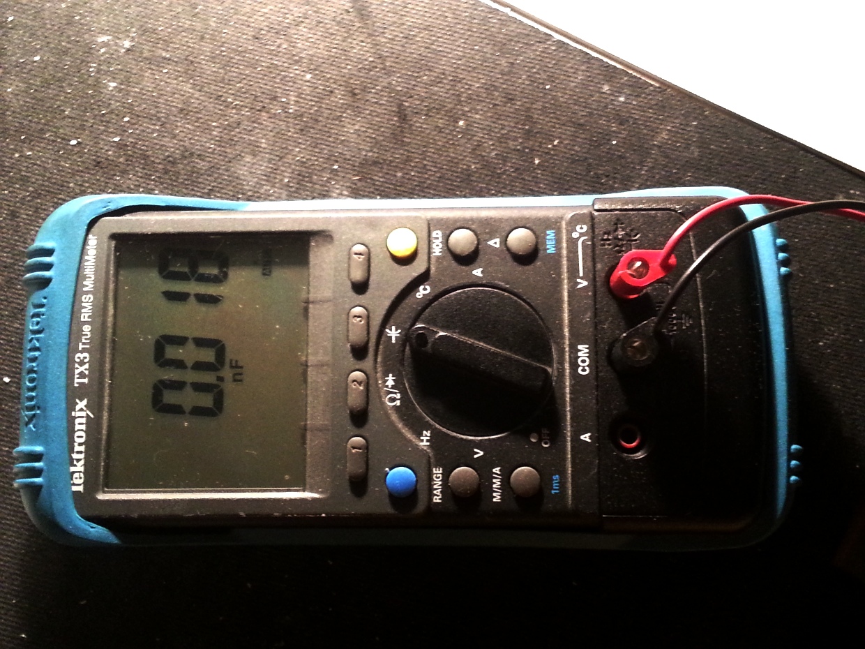

You need to have a capacitance meter, some high end digital mutimeters have them built in.

I pulled the pair of interconnect and measured with my DDM, and it was read zero.
I took another pair of silver interconnect and again measured with my DDM, it was also read zero too.

Cannot be zero Albert, are you measuring from center pin to shield at one end, other end open?

No. I measure from one end of center pin to the other end of center pin.
Did I do something wrong ??
Yes, measure from center pin to outside (sheild) at one end, the other end not pluged anywhere.

OK, the one I've been using is 0.157nf/157pf with ofc. The one I'm trying is 0.082nf/82pf with 22 awg pure silver. The 82pf one sounds open, will report after serious listening.

Hi Albert, I recommended to you in the return PM that you should have no more than 1.5mt at <100pf per foot.
The Lightspeed is flat from dc to over 300khz it self.
Then determining factor becomes the interconnect capacitance for the hf rolloff.
And any source coupling capacitors will determin the bass rolloff, none if the source is solid state dc coupled then bass rolloff in not an issue.
