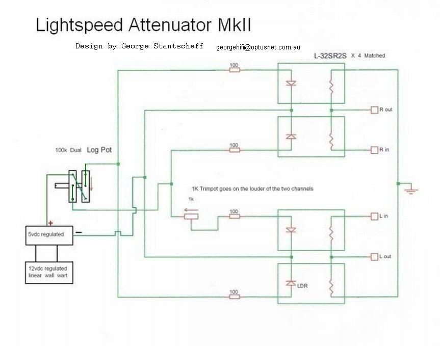

Still series ldr with shunt ldr to ground. Powering by 12v rechargeable Lithium battery seem to be a popular second option by my customers, but it's so close to the standard wall wart way of powering it doesn't seem worth the hassle
I have attached the stereo version and also the dual mono version.

PS: For all the owners of a Lightspeed Attenuator, you will again be pleased to know that it has once again been listed in the Stereophile Recommended Components (October 2012) list with highest value $$$ rating.
Cheers George

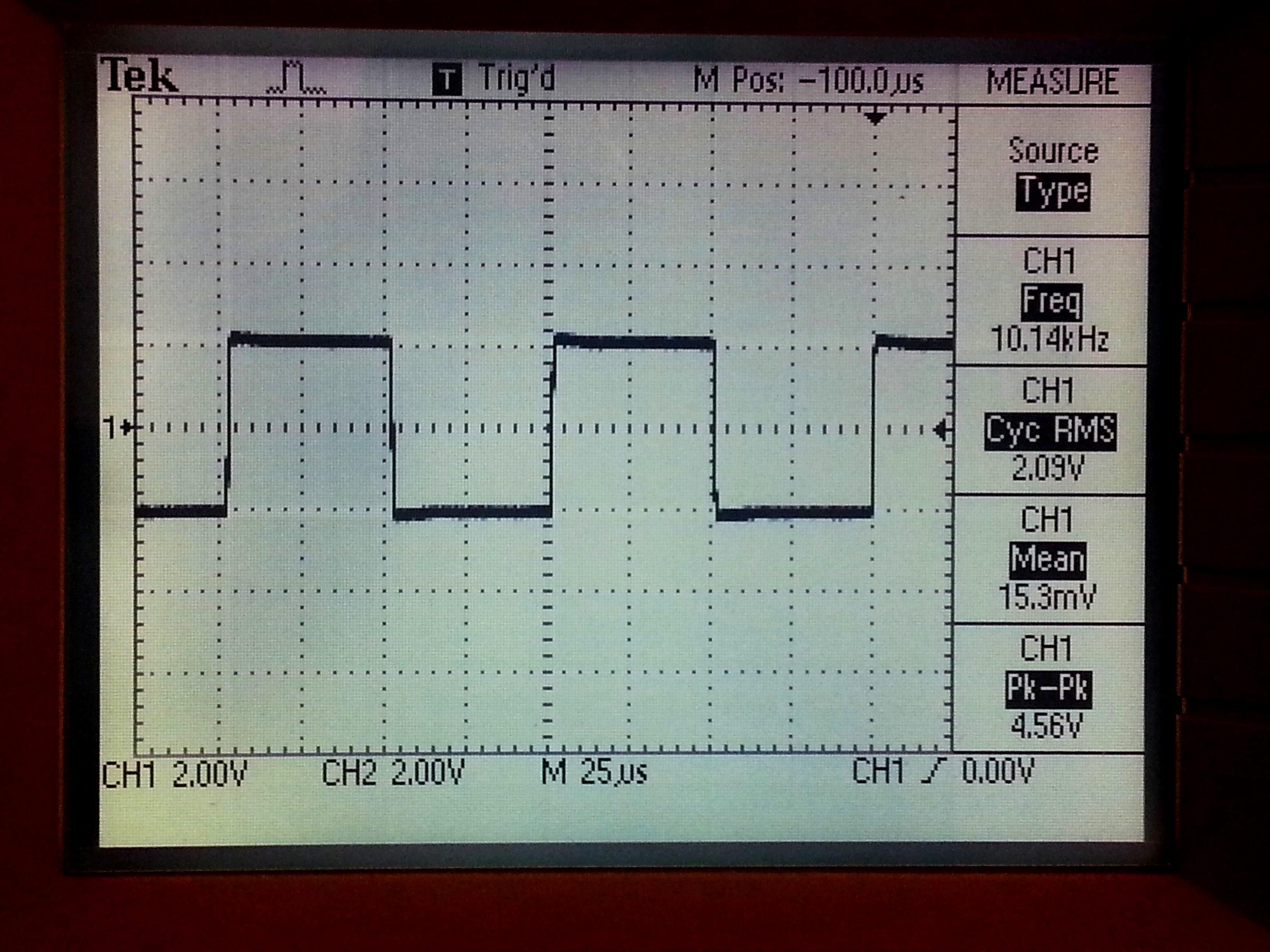

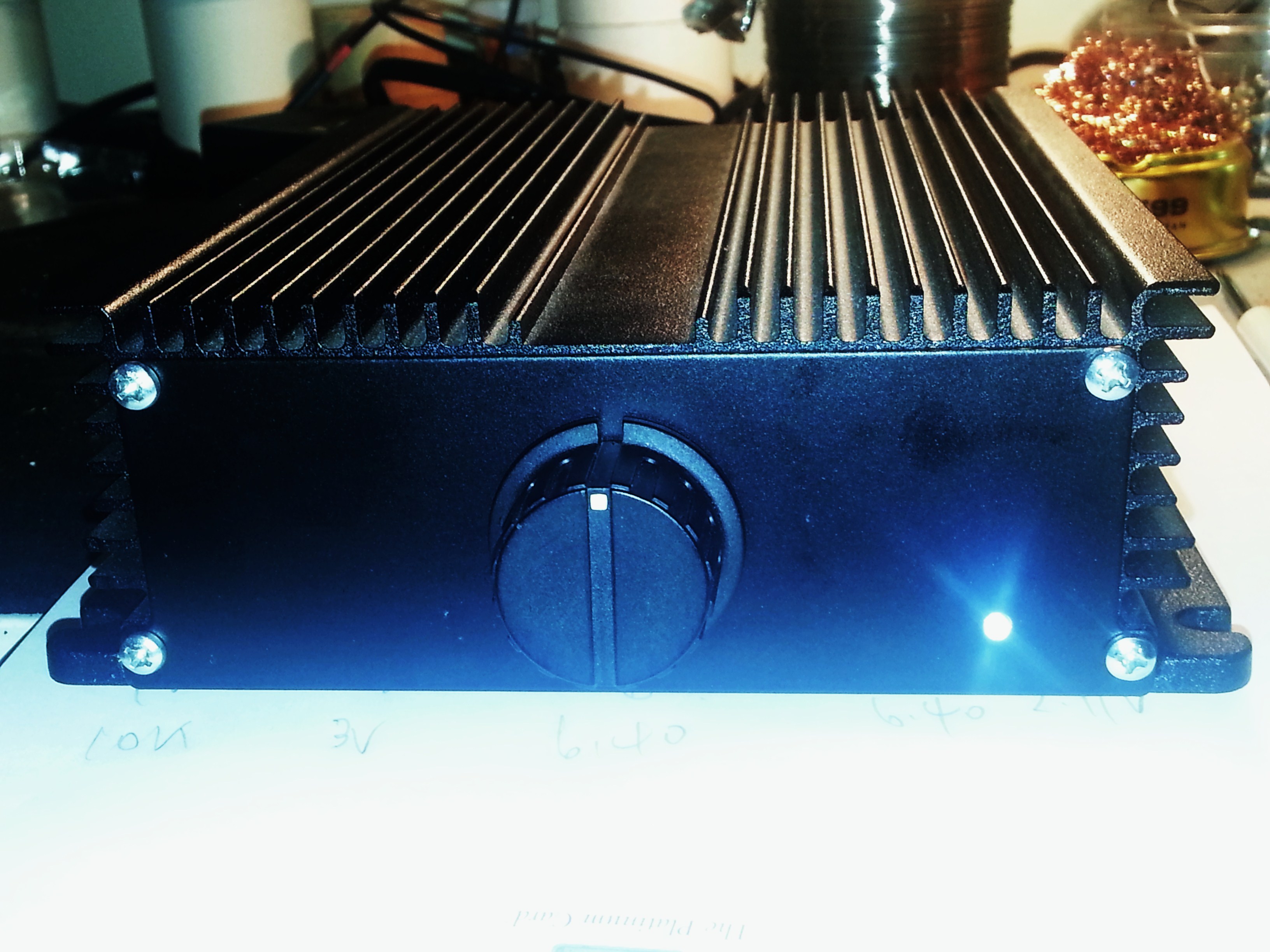

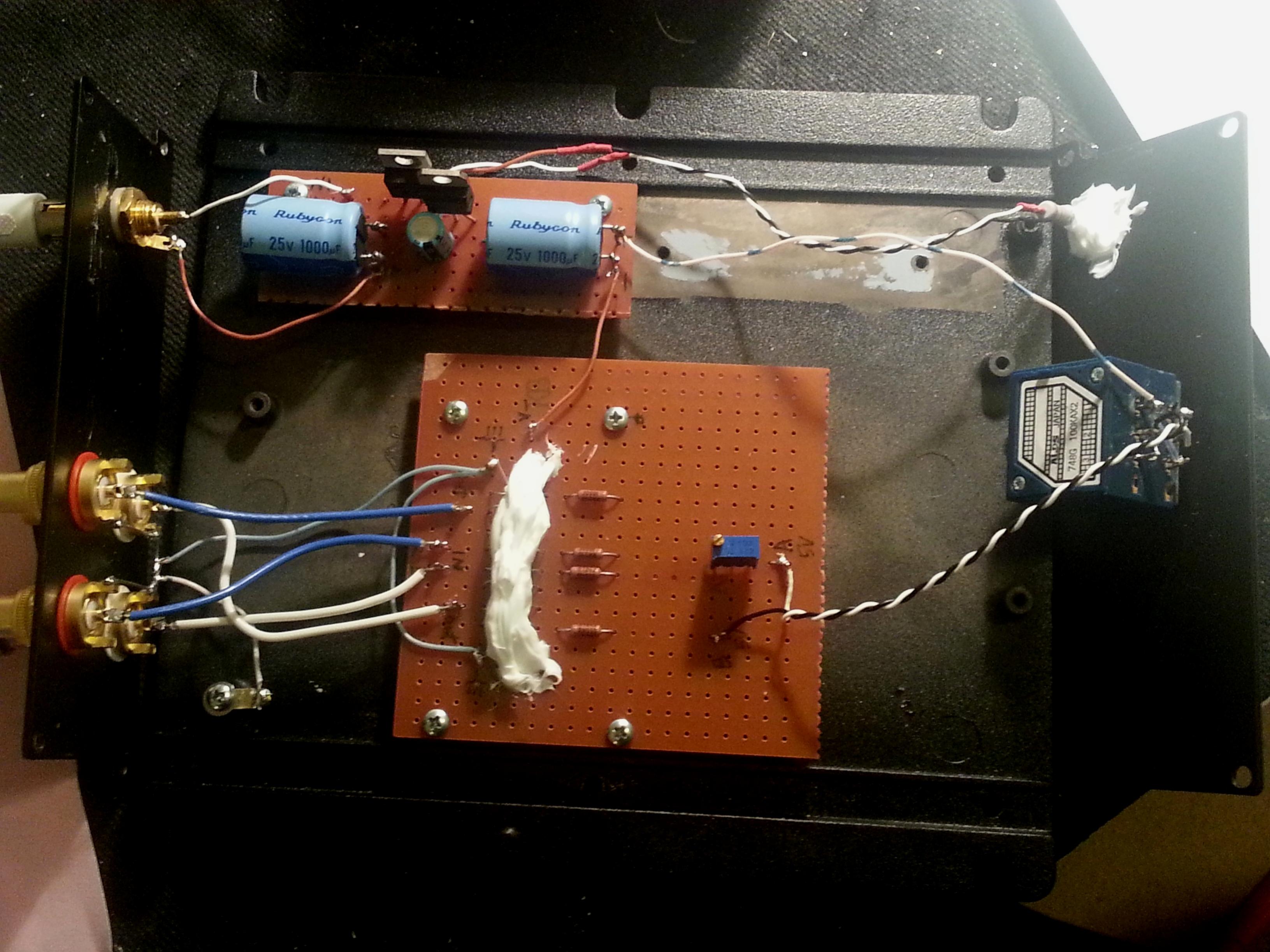

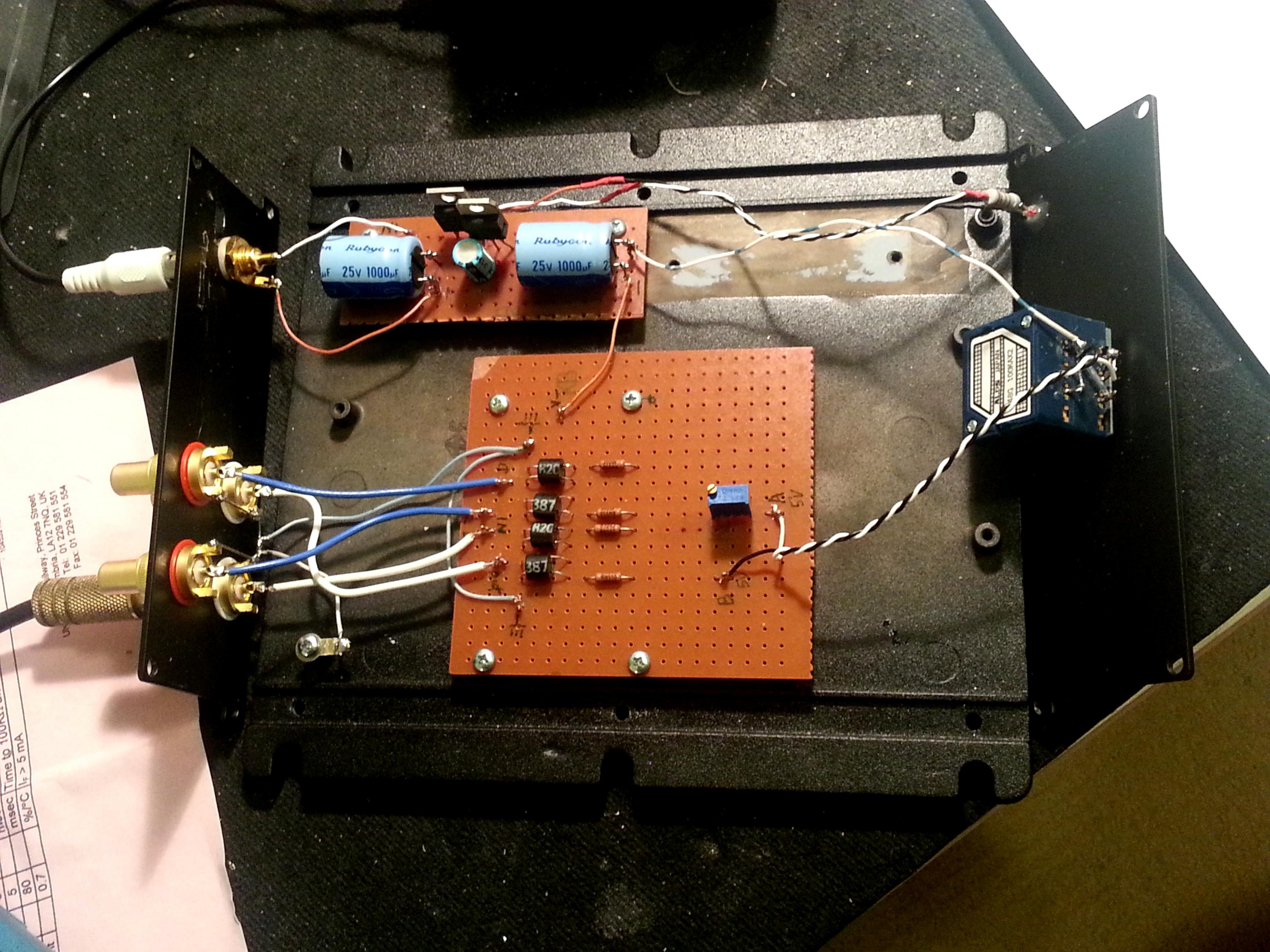

The second one up after 3 years
I finished another one for my second system on my bedroom. Nothing special but surprisingly found couple pairs the specs are really close. This one I go with the original design with dual 100k pot. Measure extremely good and didn't try on sound yet. Will report after serious listening.

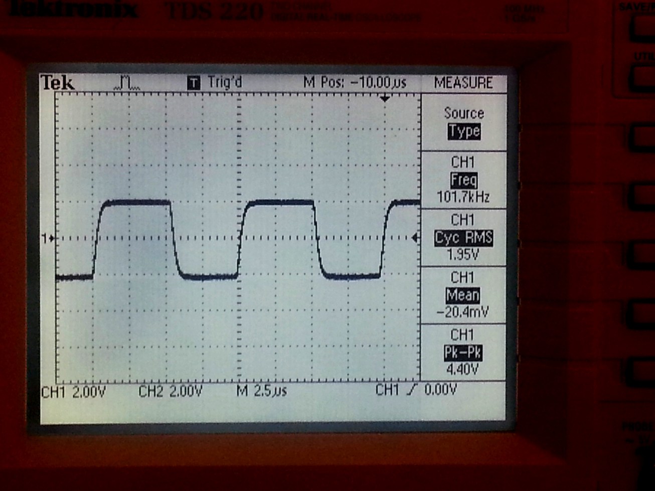

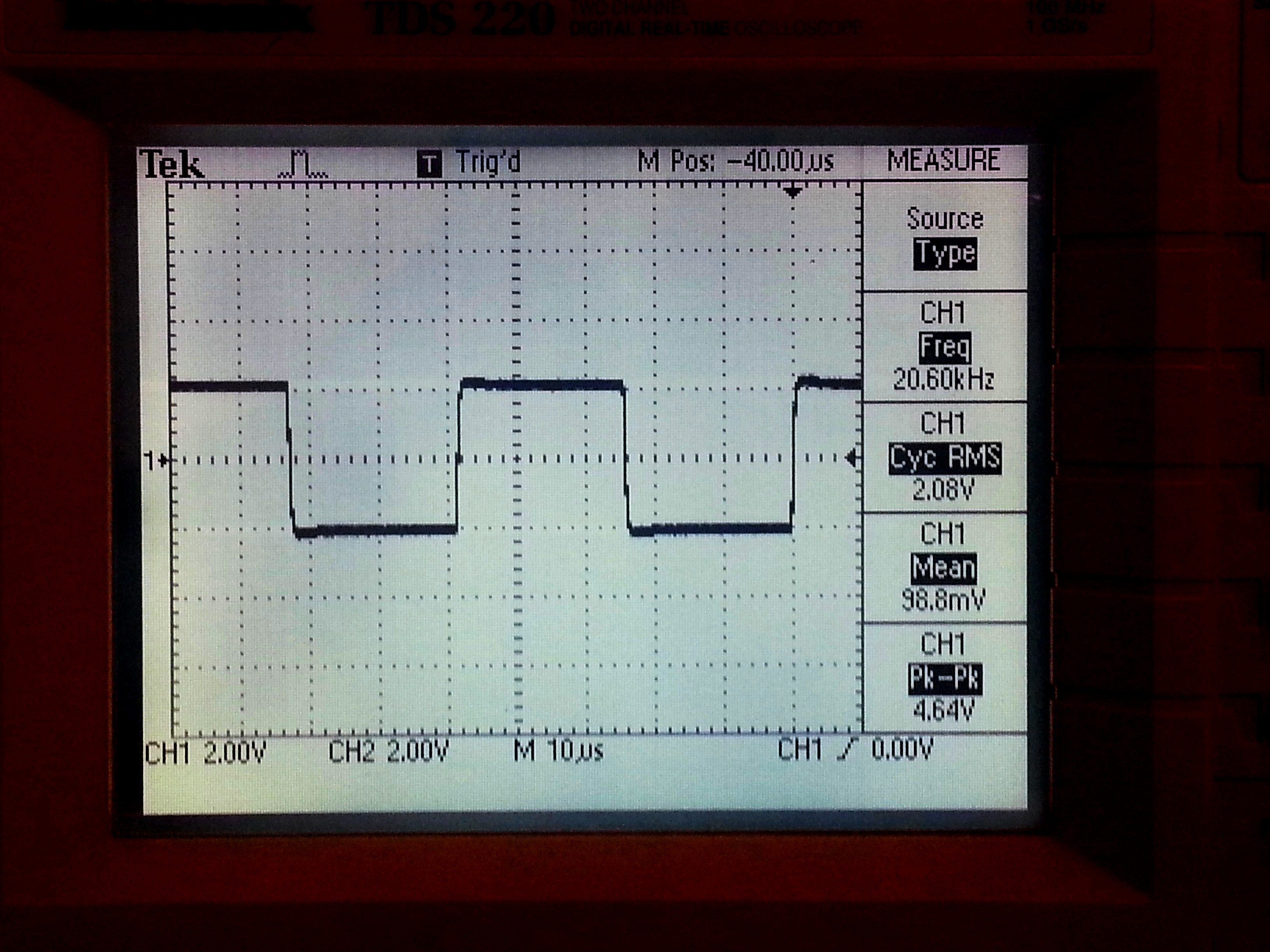

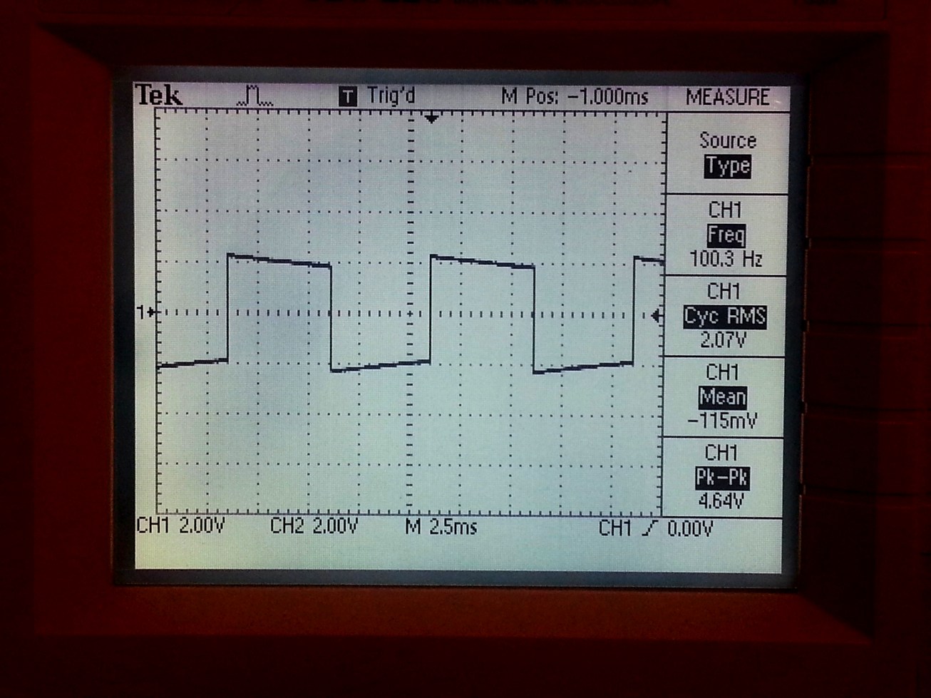

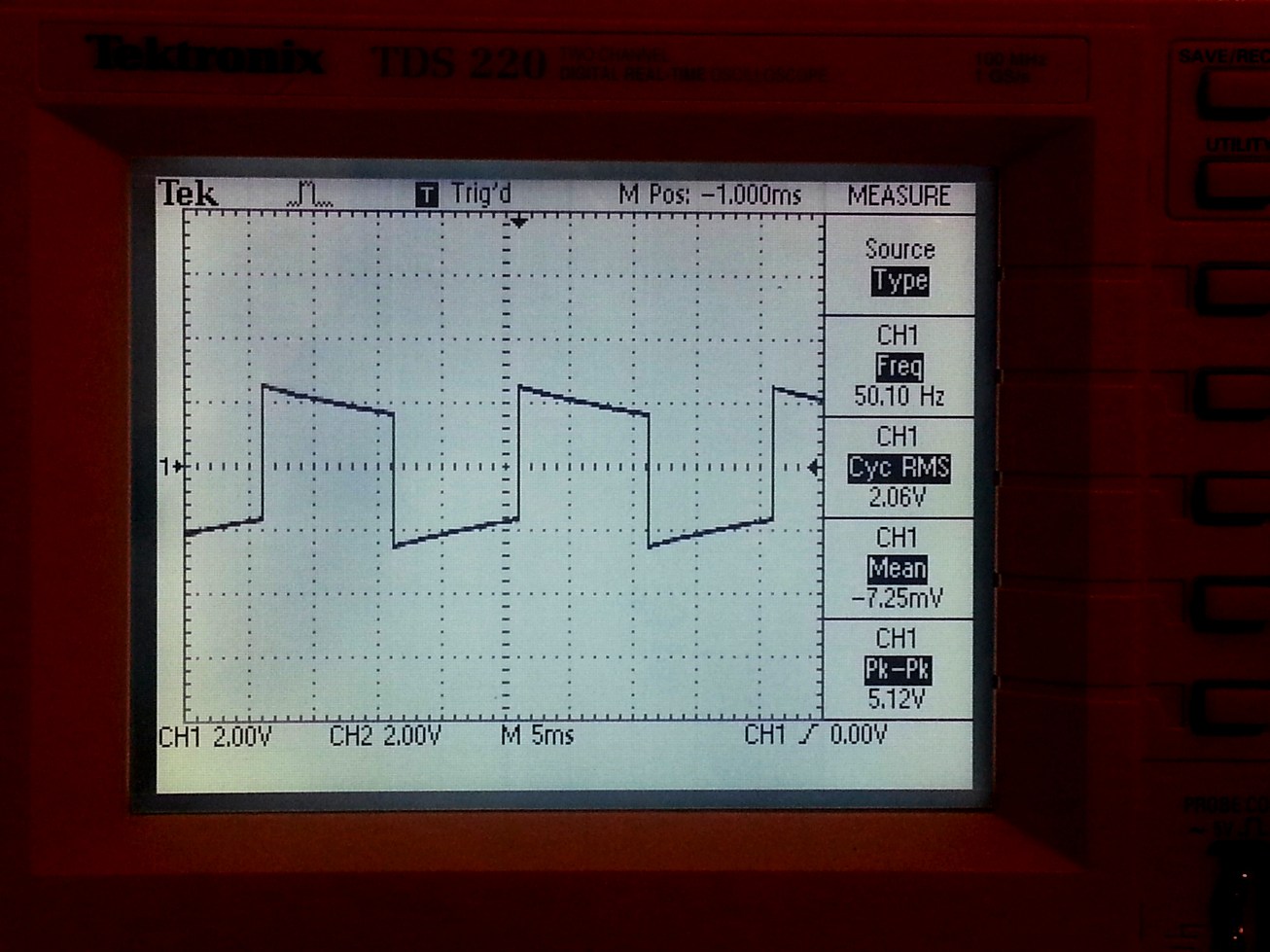

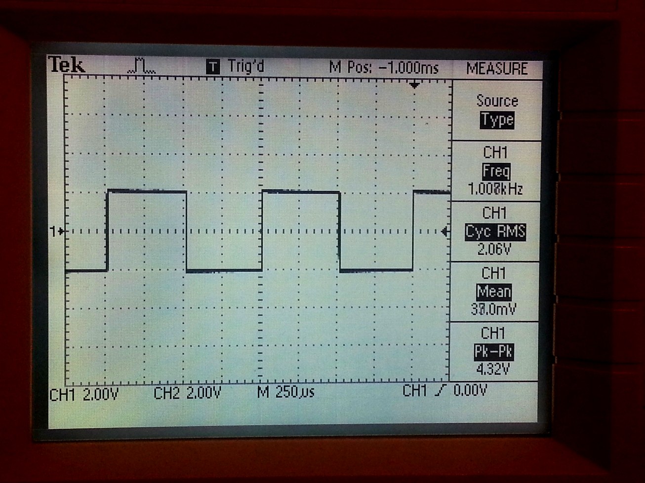

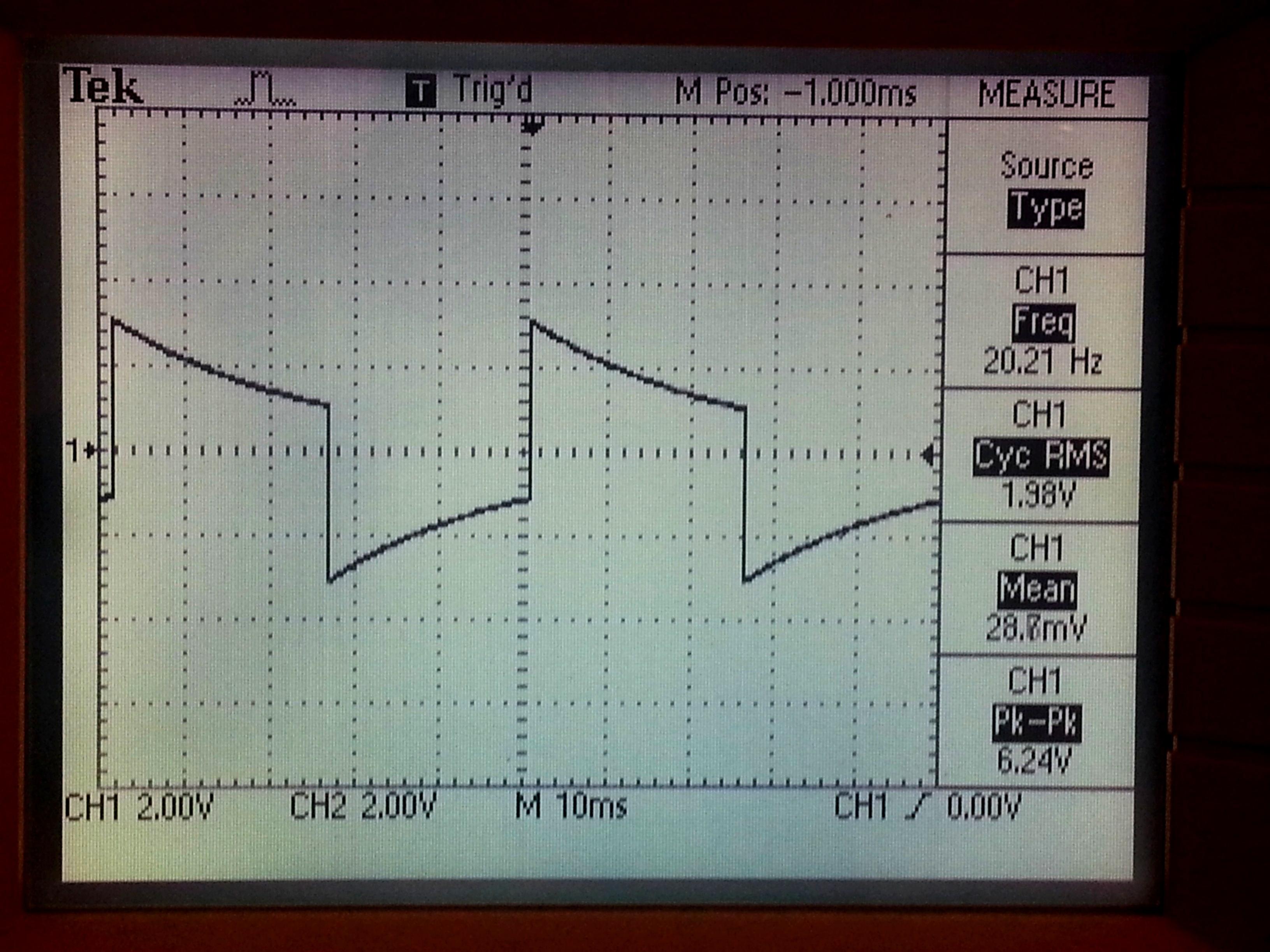

Oh........forget the measurement photos, from 20hz to 100k. Here they come.

Hi Albert, you must have had your scope switched on AC coupling and not DC, or your source/generator is not dc coupled, as your square waves from 20hz to 100hz should have looked just like the 1khz to 20khz ones, absouletly square.
And I would say the slight rounding of the 100khz wave is most probably the scope probes capacitance.
Cheers George
Cheers George
I have my machines checked and found this is the problem of the signal generator which gives the same wave form as posted. So I presume the wave form on the lower octaves should be all square.
Time to buy another S/G, or does anyone knows how to repair the machine ??
Albert
Dear Albert,
It's the impedance of the lightsppeed attenuator is so low that the Sig Gen output impedance is a bit high to provide a perfect square waveform. The CD player or DAC output should have much lower impedance that the low frequency drive shouldn't be problem at all. Give it a try and try it in your system.
Johnny
He was using a signal generator for those LF square waves anyway and it should be fine driving into the 7k-10k load of the Lightspeed unless it's faulty or has too small coupling cap, or the scope was not switched to dc coupled, the dac is something else again.
This is why I never advocate the use of tube output dacs or cdp that have pathetic high output impedance, some are ok like the (SLCF) super linear cathode follower that's 100ohm output, but there are many that have up to 7k output impedance that have trouble driving may preamps passive or active.
Cheers George
Thanks guys for the help.
I only use my analog out with op amp from my transport. There is only 110 ohm and I thought it should be fine. What I really want to know is the capacitance of my interconnect cable to the power amp. How I can measure it with the multimeter.
