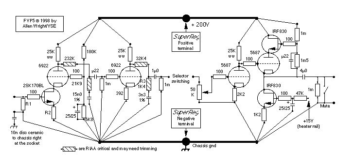

Nearly all phono leads that come from a turntable have an RCA on the end not an XLR.

Yes you are right, 99.99% of cartridges end up being single ended when they get to the rca's sockets on the phono stage.
I have myself only come across one early (Mark Levinson Phono Stage) that had a true balanced input but this required a rework of the cabling inside the tone arm and the flying leads leaving the turntable.
Unfortunately Decca cartridges with their 3 pin output did not work balanced successfully with this, also a lot 4 pin cartridges which have their blue and green pins connected internally inside the cartridge.

Actually, every tonearm I've seen has twisted wire in the arm-tube, so that can be left alone. All that needs to be replaced is the coaxial interconnects (easy). Some Shures need to have the strap cut- every other cartridge I have had on hand (Grado, Stanton, Audio Technica, Panasonic/Technics, Linn) separated the blue and green so were balanced-ready. The only cartridges I've seen that don't work balanced are Deccas.
I checked and indeed Vacuum State's preamps are balanced in on the phono, so it's not just Morgan, me, and a few others. But whether or not that's popular commercially (and it isn't!), it's the right way to run things, it's pretty easy to do, and since we're all diyers, we can do it.
No misconceptions.

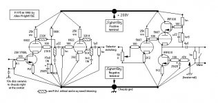

Allen is in minority with his later balanced phono stages, but even he used for a long time the standard way (attached) single ended circuitry that 99% still use today.
Cheers George

Didn't quite get the point? You said
And don't think for a minute that cartriges are balanced because they have 4 wires, 2 of the wires are earthed to the shielded cable, and only have one hot per channel not 2 +&- like balanced should be, otherwise they would have 6 wires.
That's incorrect. And I think you've now moved to the correct statement that most phono preamps do NOT take advantage of the inherently balanced nature of most cartridges, and are configured with single ended inputs. NOT the same thing as saying that cartridges aren't balanced and that one needs six leads to make them balanced.
