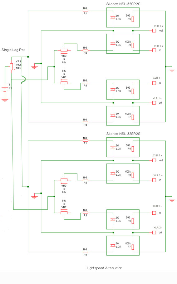

How hard would it be to make a balanced version of an LDR attenuator?
Wish you luck on the matching, and have some Valium handy.
Cheers George

That solution would certainly be easier. I dont think George was recommending the solution he posted but simply giving the guy what he asked for. Its really hard to perfectly match up as many LDRs as are necessary for balanced, the reason for the Valium. Your solution might be worthwhile of course impedance is all over the place that way, but with a powerful CDP output and a real high input impedance on the amp it might not matter much. Why not use LDRs as the set resistance resistors?
The series LDR must match very accurately.
This could be done with a switched resistor stack. A two pole 6 position switch each feeding a fixed resistance into the respective LEDs would achieve the separation that could allow for very accurate trimming of the LED resistors.
The shunt LDR is the continuous Volume controller and does not need to be matched.
However, I proposed something very similar in another thread and was referred to D.Self for why this shunt version of a balanced volume controller is not as good as it can be. I can't recall the details but the argument against seemed valid to me.
If you can accept or overcome Self's argument, then this would be very simple to implement.
Well, there are two possibilities here :
- if no match at all is performed, a separated left and right control could deliver the correct balance,
- if a stereo control is used, a balance correction is mandatory.
As for all LDR, the major drawback is to ALWAYS deliver the CORRECT current to LED to be sure to get the correct value for the resistor. This remains true for all series and shunts components. Using resistors to control them may be one solution, but it is a "fixed" method (excepted if the resistors could be replaced by real adapted values). A best approach is to be able to correct the currents for any divergence of these resistor values, from time to time, either manually or automatically, ...
