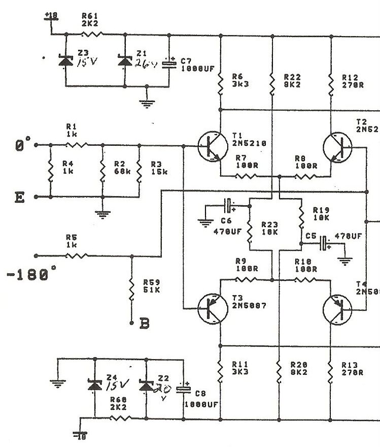

Only if you are running 10-20mt interconects, and then it's only to stop noise/hum, your not gaining any sound quality. The true balanced input of a power amp attached is found on very few balanced amps, most just implement an opamp to do the balance input job and then after revert back to single ended, it is at this point the single ended rca is wired in, and in this case the single ended will sound better because it bypasses the opamp used for the balance work.
And then there is dacs/cdp's with so called balanced outputs, very few are balance all the way from the dac chips outputs right through to the xlr connectors usually they are single ended from the dac chips through the I/V stage then through 2 opamps to give the balanced output where the same but single ended output goes through 1 opamp after the I/V stage
Cheers George

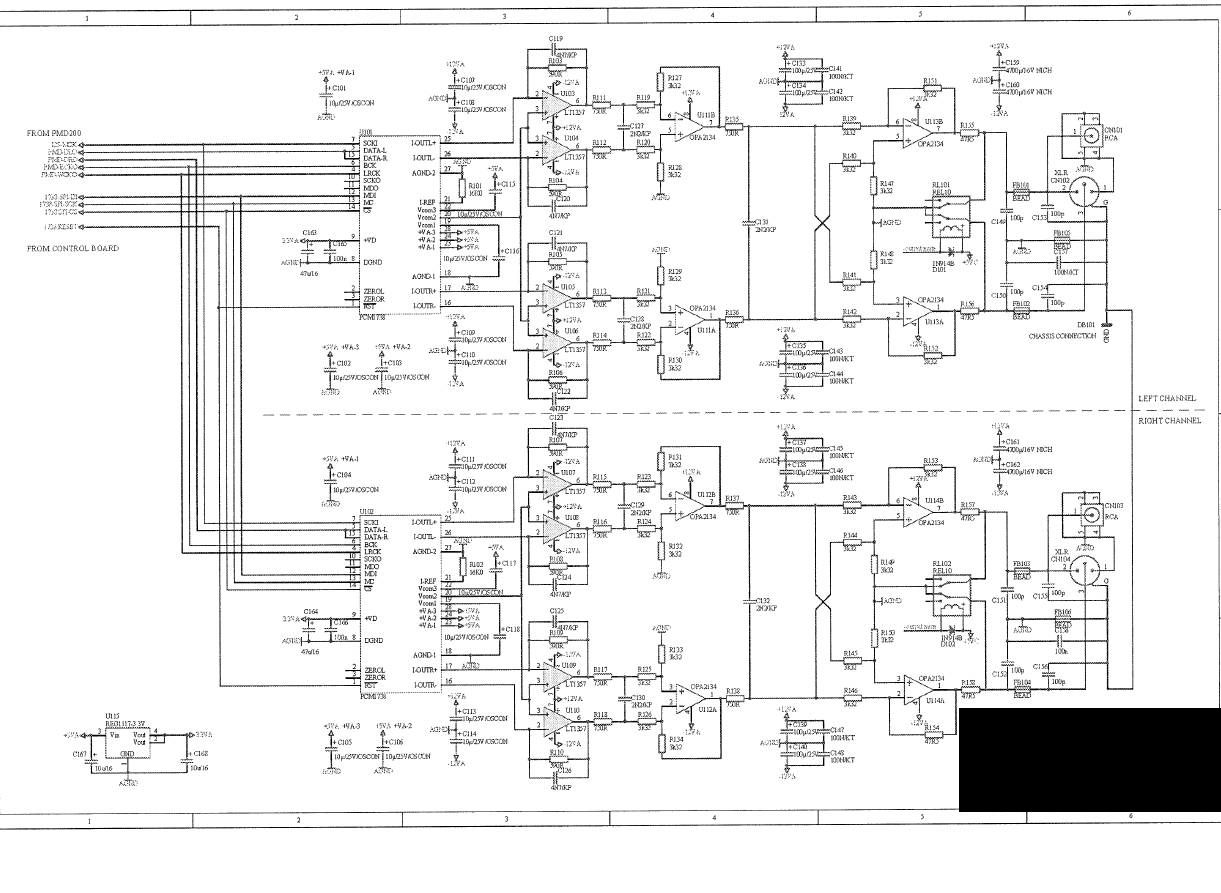

And here is a true balanced dac, from dac chips right through to the xlr outputs.
And don't think for a minute that cartriges are balanced because they have 4 wires, 2 of the wires are earthed to the shielded cable, and only have one hot per channel not 2 +&- like balanced should be, otherwise they would have 6 wires.
Cheers George

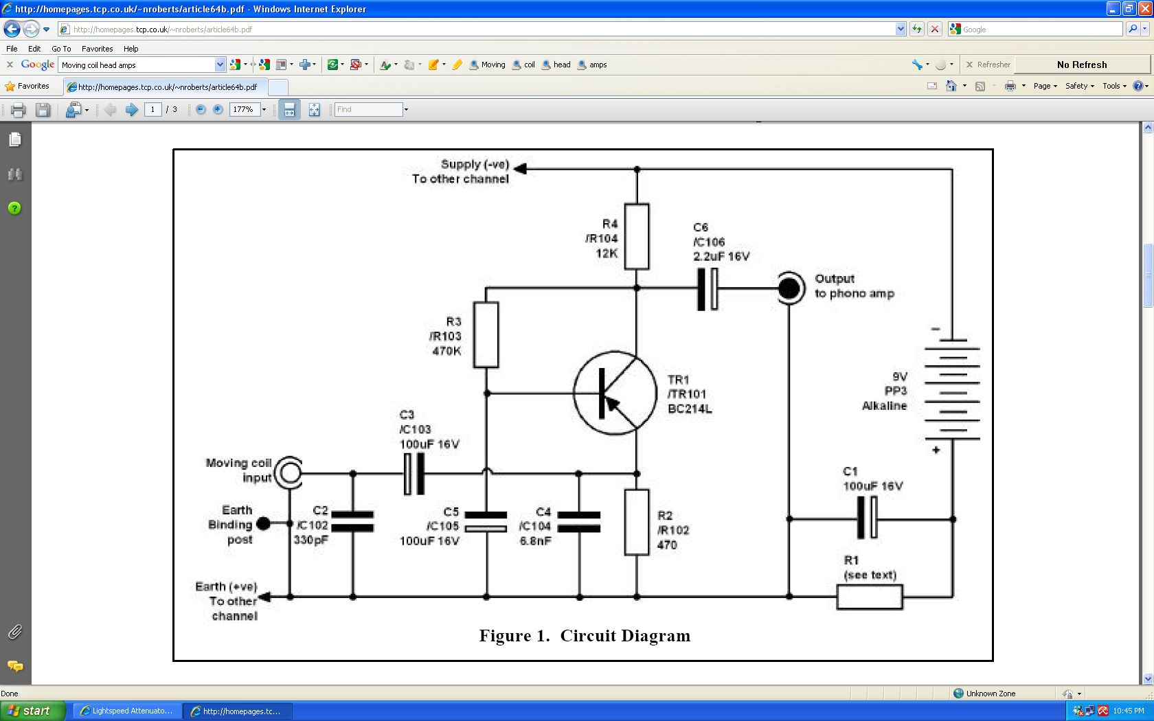

I should have been a bit more specific in that the one side goes to ground/shield on your typical MC active headamp (attached) this turns it into a single ended device.
