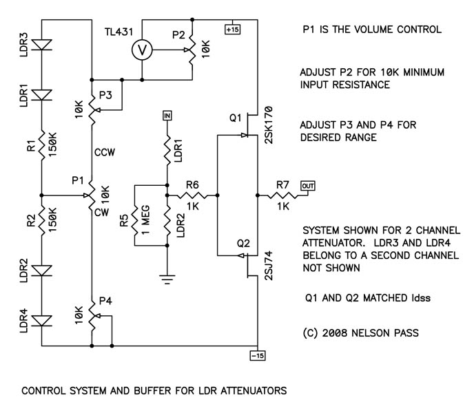

Has anyone put together the Nelson Pass version with the buffer? I made one and I've got a slight channel imbalance and I can't get my head around how to level it out. Any ideas would be appreciated.

Hi Andrew, thanks for the input. Nelson had Lightspeed version with a jfet buffer to help drive amplifiers with lower input impedance. It has +/- power supply so there is no provision to trim the ldr's with a pot to ground like George's original. He has a schematic somewhere in here I just can't point it out at the moment. I'll have to wade through to find it.
From Nelson for the Lightspeed Attenuator to use with lower input impedance power amps, but still rather high output impedance at 1k.
Whats good is that it's dc coupled.

While Nelson has provided a position for a regular pot to be in control of the volume, the LDRs values will still alter the volume. Have you implemented the circuit for the LDRs power just as George has shown us? If so you will have two 1k trimmers in series with two of the LDRs. Turn the system on, play some music, and change one of those trimmers til you get a good balance.
