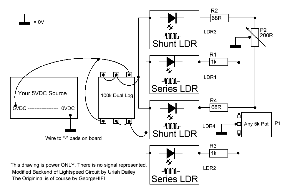

I like around 150R as well. In the little board I sell that is basically the Lightspeed backend I use a 200R pot for the Shunt LDRs. They reference ground through it with the wiper going to ground and each shunt tied to one of the other legs. Then between the outer legs and the LDR is a series 68R resistor. So approx 168R for each shunt. Works well and no burnt LDRs.

Uriah, could you explain the purpose of this setup -- is it intended as a control to balance the two channels? What about the series device?
Yep, its for balance. Series you need two pots. This way only one. Also when I match I cant match under about 200-250R so the 200R pot allows matching that last little bit without effecting the matching at higher resistances. If you match several hundred of them at high mA then you end up drawing a serious amount of current and not having a super accurate power supply. If I match at that level then I dont have to draw a huge amount of current and I have a super precise supply.

Varying Ground to each LDR for balance.
Here is a drawing further illustrating my grounding technique that allows balance with one pot. This is what's on the tiny board I sell on my site. Anyone can feel free to use it for their own uses as long as youre not selling my exact representation of it. Meaning, go build your own boards if you like.
