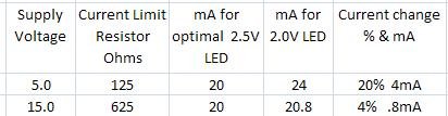

Folks, look at the attached bit of spreadsheet, it will demonstrate something that may not be well understood.
Make the following assumption: you have two optocouplers (LDRs!! 🙂 ) that you are using as a pair. Power-wise, they are not well matched -- one consumes the target 20ma at the standard 2.5V, but the other is at the outside of tolerances, and consumes 20ma at only 2.0V.
OK, now look at the consequence of using a low voltage like 5.0V to run this circuit, as compared to a more desirable 15 volts. These two LEDs will produce much different power consequences at different power supply voltages. The point is that at the lower supply voltage, the LED voltage is much more critical than it is at a higher voltage and with a higher value current limiting resistor in the circuit.
It appears to me as though the current mismatch problem would tend to go away if you would start out with a higher voltage supply and use a larger value resistor as a current limit.
The reason for this difference is that as a percentage of the total circuit resistance, the LED is a much higher percentage at the lower voltage with lower value limit resistor than it is in the higher voltage circuit. Thus, any minor change in the voltage drop across the LED has a much greater overall percentage effect on the circuit as a whole at lower voltages.
It seems to me that everyone who uses a Silonex optocoupler would be better off with a higher voltage regulated source and a higher value current limit resistor, since this would reduce the current differences between devices.
Is there a flaw in my math somewhere, or have I got it right?

Measured the batch of optocouplers I got from Uriah, spreadsheet attached.
Bottom line:
These devices have a voltage drop across the LED (@ 20ma) that runs from 1.879V to 1.956V, average 1.908V.
All devices except one measured below 40 ohms at 20ma.
The proper current limit resistor for this device is 150 ohms, based on a 5V supply with 1.95V dropped across the LED, and the remaining 3.05V dropped across the limit resistor. 3.05V across a 100 ohm resistor will deliver just over 30 milliamps, and 3.05V across a 150 ohm resistor will deliver 20 milliamps.
