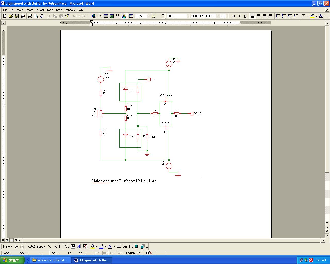

Uriah,
Nelson's design only attenuates about 35dB attenuation, unlike your "full range" units, and the buffer here isn't out familiar B1, but the complementary k170/j74 one - apart from that and the higher impedance range of the S3 ldes, it works in the same way, so operating them in parallel with variations of the 431 current distribution (ie balance trim) shouldn't present any problems.
Zum, for that imbalance, assuming matched devices, just measure the voltages at the led ends and if they're the same, check for a bodgie resistor, especially the pot.
And this one.
Cheers George

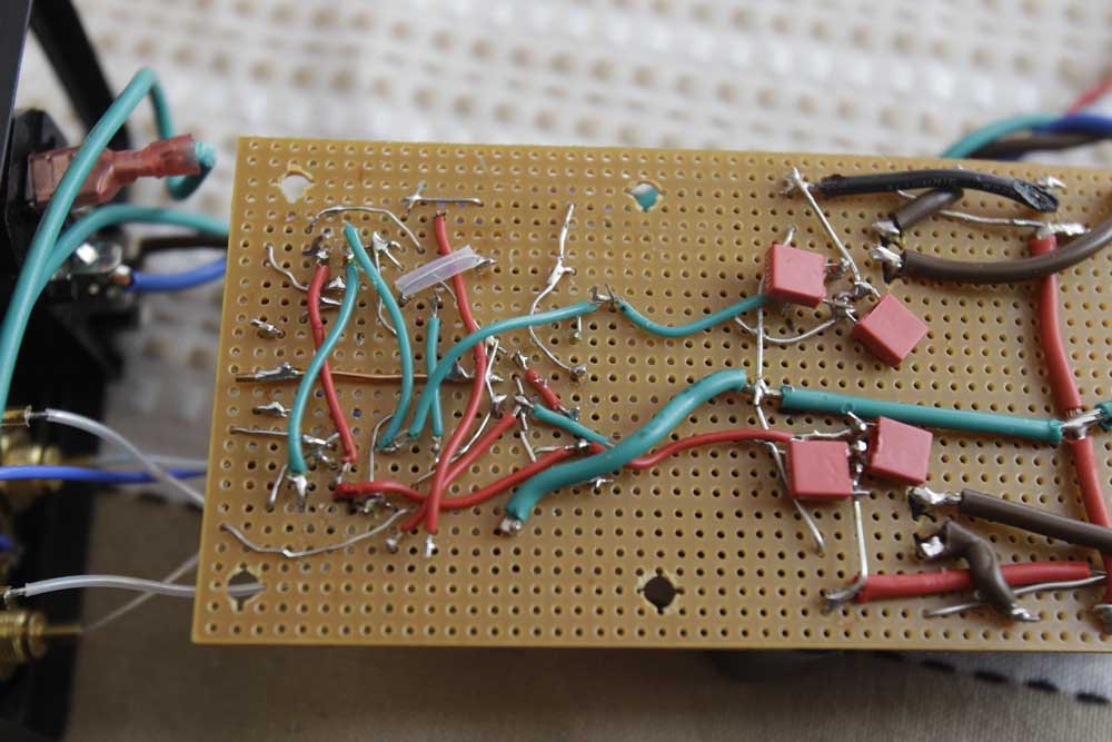

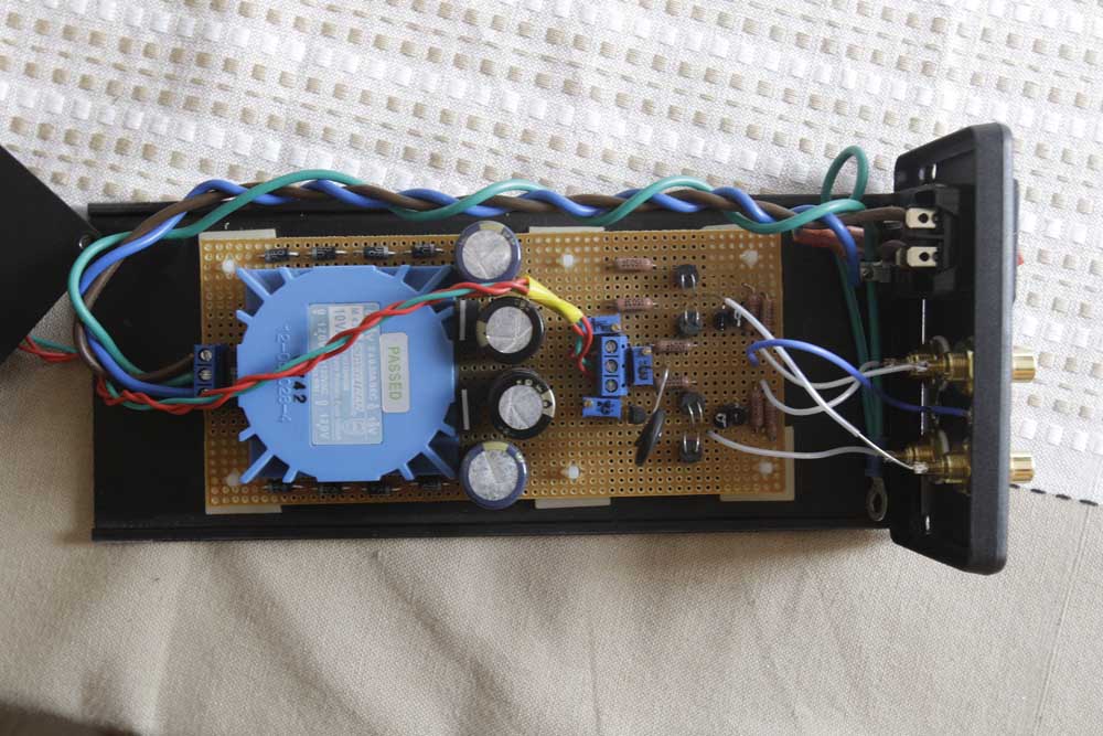

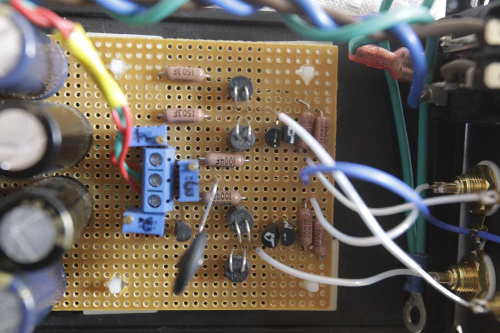

Uriah,
Here's some images. A bit of rat's nest but it works. I originally had the buffer on the output but have changed to the input to use with my CD player that has a higher Zo. Both ways I had the same imbalance.
Cheers
Rick

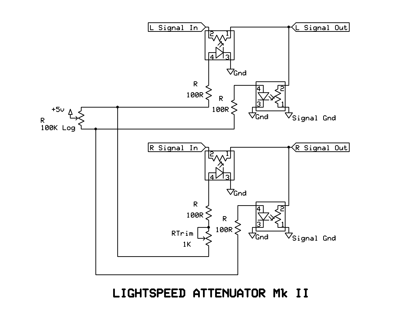

I have had a difficult time understanding the (admittedly simple) layout of the Lightspeed attenuator, particularly the purpose of the LOG taper potentiometer and the impact of using different values of pot. I finally drew it out for myself, and now I get it. In case someone else would benefit from a seeing it from a different view, here it is.

@Wapo
You need one more 1k trimmer if you would like to have balance control, or, you should explain in your schematic that the 1k is only intended to be on the loud channel. Also if you would emulate George's MKII you will need a dual log pot rather than a single gang.
Uriah
Uriah
Uriah, you are right -- there is more than one version of George's circuit in the thread. I can easily add/fix the items you point out, just give me a minute . . .
