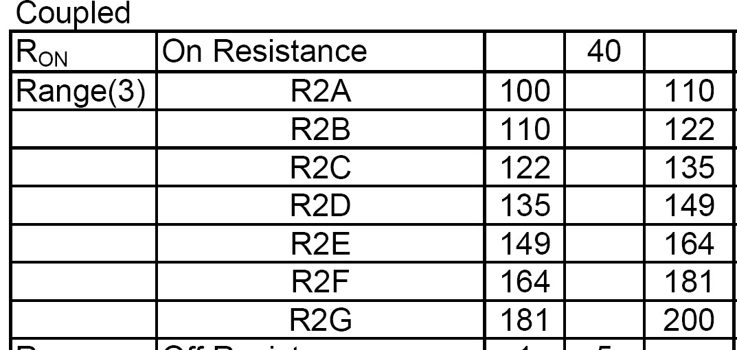

Hi there,
I'm not sure if this had been brought up, this thread has been so big...
The 6-channel Lightspeed attenuator I made drifted from the original setting.
The voltages across all those LDR's were set by multi-turn trim pots. I had done my best in setting their operation range and linearity but still not optimal. Tolerable and usable, though. It has been working like that for about an year.
Recently one side of the volume (3 out of the 6 channels) guadually faded out and eventually became quiet.
Components were not damaged, but during the re-adjusting I found several LDR's are out of match -- obviously in very large differences from others. I still managed to tune them into similar 'ratio' to maintain the attenuation consistency, but two set of the LDR's have only half the resistance of others.
6 for each side, all 12 LDR's share the same voltage source. I'm wondering why and how one side faded out (or drifted in 'group')...
Has anybody found this? Any proper solution? Thanks in advance. 🙂

Thanks Variac all sweet.
CLS, out of all the production stereo Lightspeed Attenuators I've made not one has had a drift problem you mentioned now over 5 years, because you have 6 channels it would increase the probability, also did you use
Silonex NSL32SR2S, as these are sorted and the only ones I use, also I get them from the same batch letter, and then do the painful matching, plus all 4 are matched together. Some here only match the series pair and then the shunt pair, this will give a very different gain curve when raising and lowering the volume. When all 4 are matched as in the stereo Lightspeed Attenuator, it gives a close to logarithmic feel to the volume.
Cheers George
Cheers George
Hi George,
NSL32SR2S, yes! But I'm not sure if they were made in the same batch...
I bought 40 of them and picked 12. I remember that the picked ones varied as large as 20~30% from one another. But I did get each pair as close as single digit %.

Hi George,
By same batch I mean the same batch lettering A B C D E or F it's marked on the side, attached is the data from Silonex on what each letter means in resistance in the on state.
