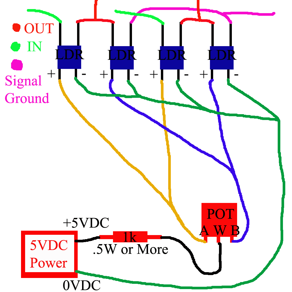

Not sure if LM336 volt ref has better thermo resistence than LM334, I am using VCCS and it's very stable.
Have you compared the sound for LDR in higher resistence vs lower?
udailey said:I dont think the double switch is necessary as the resistor will absorb still not allow any extra mA through.
The CCS can be built with an LM334 for a few pennies and this is a CCS that will go far below mA level into uA and pA. Using this will work. Absolutely. It however is not temp stable even when using a temp compensation circuit in high heat. This wont matter in your regular home ambient temp so still a good choice. Inside an amplifier case I would use very stable pots with low low ppm. Right now when I test outside in 100+F heat amazingly the regular trimpots are more stable than the CCS circuit.
The CCS circuit allows me even higher resistance than the trimpots of 1MOhm. Crazy. You can use the LM334 with a pot as the Rset and you are good to go. You will need two of these circuits. One for series one for shunt. You will not have balance control this way but I am sure you could figure one to put in there. Or use 4 LM334. Nice thing is LM334 ONLY puts a max of 20mA so you can not damage your LDRs.
You can use LM317 but still this is not the most stable in the mV range and that WILL effect the stability of the LDR. I like LM2757T but it operates at 52kHz which might might maybe be audible. However it has some family members that operate at MHz range and that will never be audible. 52KHz wont be audible but there are some that would probably argue that. Anyway, the LM2575 is super stable even down at .0001V. All day long I might get from 4.9604VDC to 4.9601 drift.
On the other hand the LM317Z is a TO-92 package that outputs 100mA max and needs no sinking. It also costs pennies. For under $2 you could implement LM317Z and LM334 to control the LDRs. Maybe $4 if you use 4 LM334 and an extra pot to control output voltage so now you are in complete control 🙂
Easy circuits to implement as they are all outlined in their datasheets.
Uriah

So far I have only been running tests on LDRs with LM334. Getting very lucky with using thermistors in combination with pots or thermistors with LM334. What I do is set them at 21k indoors and then put them on the porch at around 100F and see what the difference is in resistance an hour or so later. Next time I order I will try LM336. I have spent crazy amounts of money buying different parts to try with the LDRs and so far the most stable has been a trim pot with a thermistor.
Today I figured out my problem with the temp compensated circuit when I finally read over and over the math behind it. It would need a microprocessor because you can EASILY set it to a temp compensated value using the right math, not just the right circuit, but if you want to vary that resistance at all you have to do the math again OR it actually makes it more than normally susceptible to temp changes. No wonder. 🙂 But I have learned and keep learning a great deal with all the messing around and its fun. I dont know why its fun but at least with you guys I am in good company!
What I will try when my order of new wire gets in is to power and control it from indoors while the LDR itself is outside or in the oven and see how much of the problem is the temp co of the resistor and how much is the LDR.
Uriah
