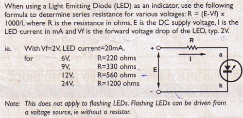

Between now and whenever you regulate down to 5V please NEVER turn the volume all the way up or all the way down. Whatever you used for a current limiting resistor/s was meant for 5V and now may be letting through more current than your LDRs will like. George isnt kidding about the LDRs not lasting long with to much voltage. Just like any LED, they will fry if given the chance.
Also, I have noticed that if you match under one voltage and you use another voltage they are not as well matched under that new voltage. LDRs purchased from me were all matched at 5VDC. If run current source they will also not match as well.
One man mentioned a while back, I forget who or what thread, that adding a 1k resistor in front of his control pot in series with the 5VDC extended the usable range of his LDRs. So now he can turn the control pot more to 2 or 3 oclock instead of the 10 oclock he was dealing with.
I have 96dB speakers. I can not turn them higher than 9 oclock with a gainclone either. This is one of the things we get used to using LDRs. One thing you can try someday if you see one for sale is a multiturn pot of the same value as your control pot, but for now, regulate down as right now you are using 40% more power to the LDRs as was intended, add a 700-1kOhm resistor in series with 5VDC to protect and extend.

Alazira. Thanks I will try that.
George. Is it a no-no to increase the values of the shunt resistors?
No problem to increase using 5vdc it just won't reach max or min volume, just don't decrease, this will blow the leds at max and min.
