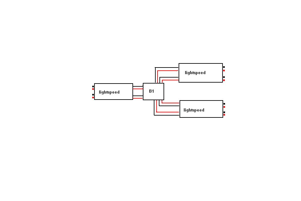

A bit quiet here
I thought I might do a preamp like this
With stereo LDR into a Pass B1 buffer
Double stereo out via 2 stereo LDR
At first I thought I would use "only" two seperate stereo outputs with seperate stereo LDR lightspeed
One to adjust woofers, and other mid/tweet
But might be a bit tidious in the long run, though I dont adjust volume that much
But maybe use use a 3. stereo LDR lightspeed
What do you think of this
Should I get a 3. set of LDR, or better forget it
Would the complication mean too much loss of quality
Its a special way to do a biamped passive speaker system
Reality is that over time most will probably use a digital filter fore at least woofers, in which case the above will be of less use
Alternatively I could do just one output with LDR att (woofers), and the other straight
There could also be one straight bypassed the B1
Lots of possible configurations

tinitus said:
A bit quiet here
Have you considered that the LSA is in fact just a passive potentiometer and there there are two places on the B1 to have pots wired into? You could just wire your LSA into that.
You would only need one stereo LSA then.
Uriah
Yeah, but what I wanted further is a way to control a biamped system
Not sure whether the passive LDR attenuator will like several stereo amps in paralel
I believe Pass has announced a FirstWatt special B2 biamp version, as well as a B3 with gain
And just now I see a B4 filter/eq
So it may be early days fore that
As always, this never seems to have an end :clown:

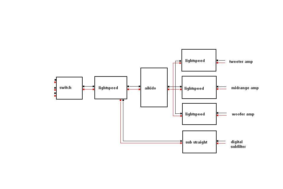

George, its a cool avatar
Maybe a bit over the top, but I hope this will be my Lightspeed/Aikido preamp, fore my future speaker projects 😎
A bit worried about the complexity and possible noise/microphonic issues, interference etc.
Will the Aikido be able to drive 3x lightspeed att
I might consider to do output with just 2x lightspeed
Will the main lightspeed controller be able to drive both the Aikido and the sub out
Any ideas about which issues I am facing with this?
