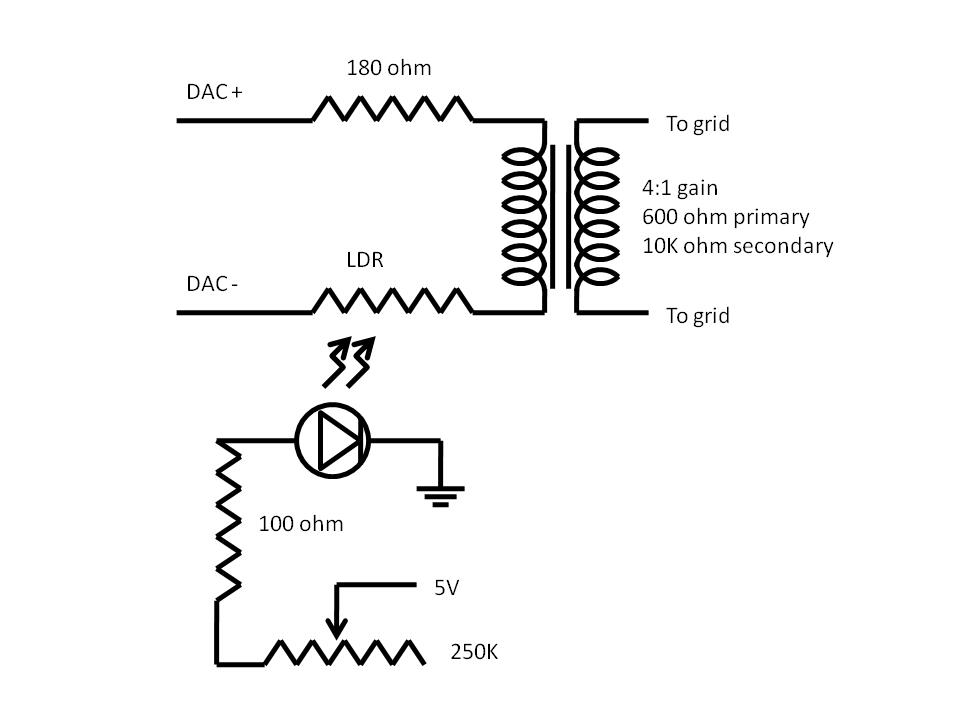

Odd question here. I've built a few of my own LDRs and they work fine. Now I'm looking at a minimalist push-pull tube amp fed directly by a transformer connected to a DAC. The DAC is a Cirrus Logic with differential voltage outputs, about 5v peak to peak. I'm looking at driving the grids of the tubes from the output of the transformer. I was noodling around in my head for a volume control and came around to LDRs. Does anyone have any opinions on the attached schematic? Back of the envelope calculations using the NSL-32SR3 datasheet says that I should get about 15v out of the transformer (good for driving an EL-34) and keep the input impedance at a minimum of 840 ohms.

Fenris said:Does anyone have any opinions on the attached schematic? Back of the envelope calculations using the NSL-32SR3 datasheet says that I should get about 15v out of the transformer (good for driving an EL-34) and keep the input impedance at a minimum of 840 ohms.
Hello Fenris
you can expect about 1.7 to 2.5 V rms from your dac, output resistance will be 118 Ohms (datasheet), loaded with 210 Ohm (180 series, 30 must be the "on" resistance of the cell). This impedance will be transformed 1:16, will be 3360, not 840.
This is just the loudest setting, with a lower setting impedance is getting too high to handle for the transformer. I would go with a second (series) cell, without transformer. Definitely not possible to drive the grids of an EL34. If the cells would be on the secondary side, impedances would be okay, but the cells have high distorsion at higher voltages.
regards
Andre
