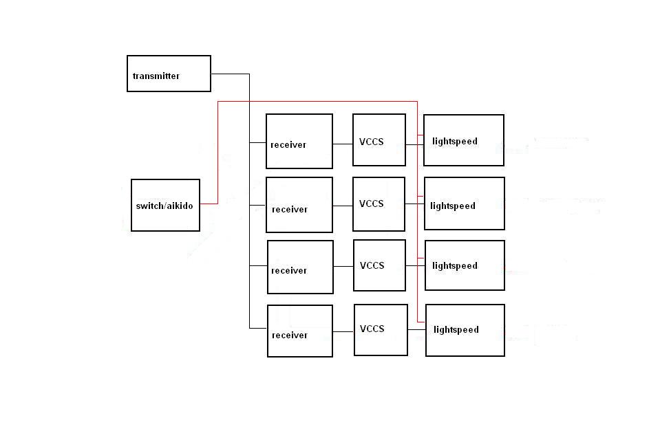

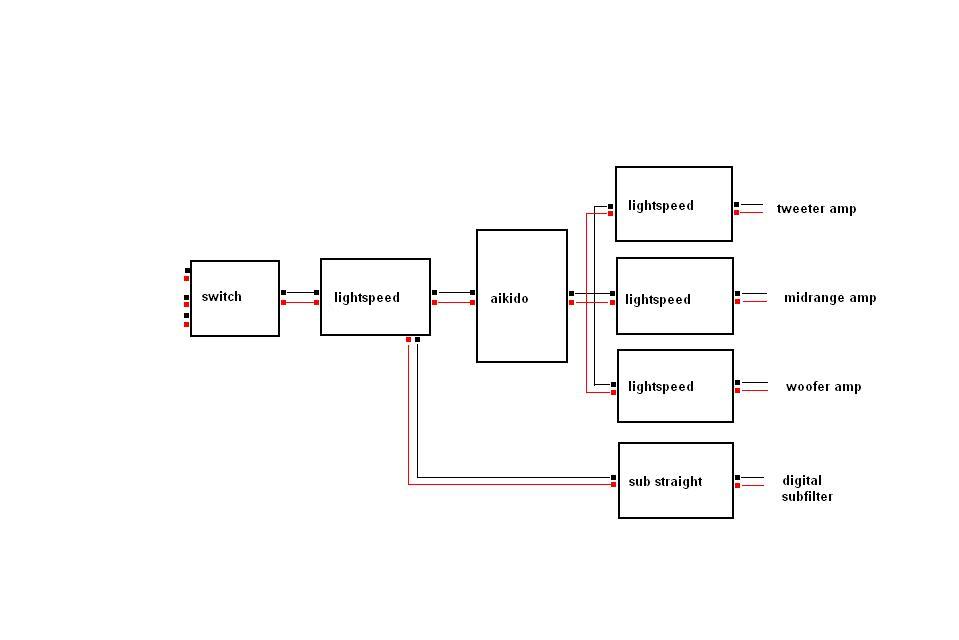

I had this in mind
Fore ease of indidual setting on poweramps, and versatility
Maybe even with mono pots, if possible
Though just remembered that George recommends to adjust LDR volume down below half setting, which supposedly would result in less wear on LDR
Not sure if its an issue to take very serious
But the LDR on my outputs would probably always be set on the high, which means the last half
Could that be wearing them down early 🙄
Or will I be facing other LDR related problems as well

I showed a fullblown preamp fore controlling a big triamped system
I will probably put it aside fore a while, and just do the simplest "passive", with 2 line in, and one out, which is all I need at the moment

Hang on :idea:
Does this mean I can drive 4x LDR(stereo att) simultaniously
And additionally still have individual fine adjustment of each LDR att
But I suppose I would need 4x VCCS and 4x receiver, one each LDR stereo att :hot:
The trick of this is that the LDR is ok to have on the OUTPUT of a preamp
And the gain unit could be seperate, and easily removed or changed
Well, a bit expencive, but also very interesting 😎

Hi Tinitus,
You will need a 15 volt DC supply to power the VCCS module.
You would need eight IR Receiver modules to run four parallel VCCS modules. Four receiver modules would have the same programmed address which would allow the transmitter to control all VCCS modules at once, and a further four receiver modules individually parallelled with the first four receiver modules, each with a different programmed address, would give you individual fine control. I can add further program addresses with a little track surgery on the transmitter and receiver modules. One transmitter module in the handset can control one or all of the modules by using a switch to set the address.
Paul
Thanks Paul
Gets complicated, and expencive, even if I would use only 3 LDR outputs
I will just build with single LDR unit, fore now
And take up the 3x output later
But its only good fore passive triamped speaker design
Adding say a digital/eq/crossover, and its all down the drain
Something I need to think about
