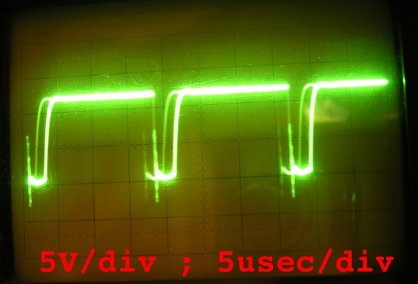

Tekko you are a real ringing master 😀😀😀

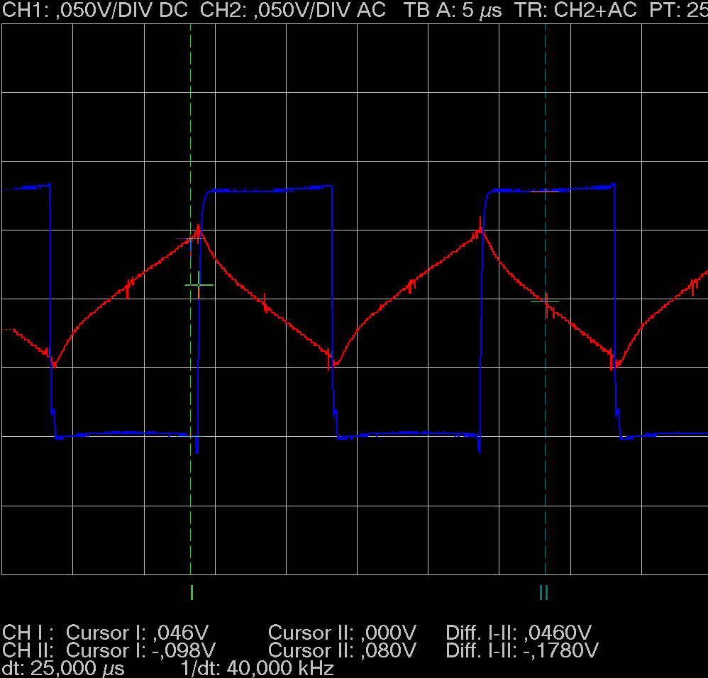

That's how my lower side gate waveforms look like at 5V/div (blue). Output inductor current waveform is also shown at 2.5A/div (red). I actually grounded the gate probe to the output of the amplifier and enabled AC mode, so there is some slight inaccurancy (my oscilloscope does not have floating inputs).
I don't expect any iron powder core with a diameter equal or below 50mm to store more than 10mJ, or should I?
I think so. It depends on how much degradation is allowed in inductance. If it can be 30 %, then it's OK. For example this: Arnold Magnetics A-438281-2 shoud be able to store at least 50 mJ. Maybe this is not the best solution, but possiple.

0.71mm diameter magnet wire gets too hot to be touched with just the +/-2.5A idle ripple current.

Tekko your waveforms always show problems such as strong gate drive ringing, asymmetric dead times, asymmetric duty cycle when idle and the like. You won't achieve reliable operation at high voltages until you solve each of these problems. Particularly, gate drive must be clean and dead time must be well defined and symmetrical before daring to try higher voltage rails.
Consider my prototype for example. Any cross-conduction or false turning on with 340V supply rails would destroy the IGBTs almost inmediately.

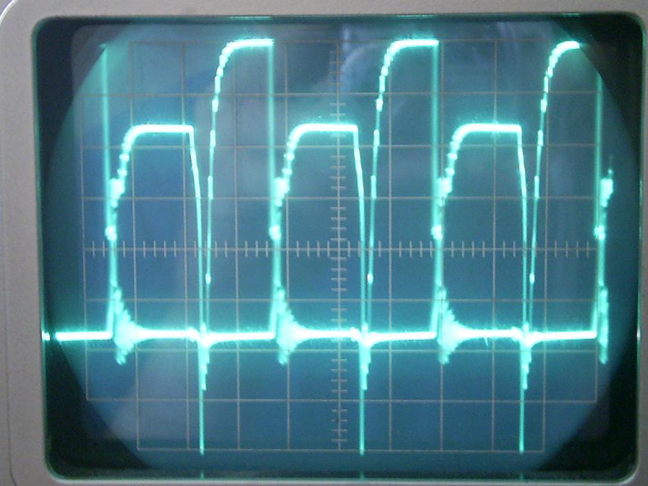

Eva, if i adjust so gate waveforms are 50/50 i get over a volt on the output.
Why the waveforms have diff amplitude is because high ouput has higher voltages than the low output.

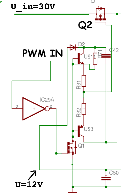

Does anyone has any ideas why the Q1 keeps blowing, when I apply some load to this circuit? It's a buck converter, not a Class-D amp, but the high-side driving is the same 🙂
The Q1 is a BSS123 MOSFET (Vdss=100V, Id=170mA, P-ch), thoose bipolar transistors are BCX 53/56 (i will post image from the mosfet's gate), and the Q2 FET is an FDP3632.
When the circuit is in idle, everithing is OK. When I apply a relative small load (the output current is about 10% of the nominal output current), then still it's OK. But when I load the circuit with a bigger resistor, to make approx. 10A, the BSS123 blows.
I tried soldering paralell the Q1 a bigger diode, becouse I saw some undershot on Q1's drain-source, but nothing improved, the Q1 blown.
I'm gonna try a diode between the U$3's base, and Q1's drain, maybe that will help.
What do you think if that?

Workhorse said:
Hi Toino,
Dont you see that the Schottky is protected from reverse potential by the Antiparallel HEXFRED diode with Vf=0.6V

Maybe... but the HEXFRED is much slower than the Schottky…
Could you teach a little more, please?
Oops, sorry...
That's an N-ch FET, as the schematic shows, I just "misspelled"...
Do you have any idea, what can cause that FET's death?

Danko,
When Q1 turns on, U3s collector base junction can become forward biased while the MOSFET is still conducting. The current through this junction and Q1 needs to be limited.
Rick
