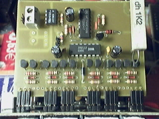

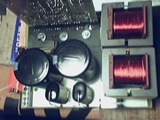

Eva,
Is that the controller section for your multi-kilowatt power converter? Would you be interested in posting pictures of the power section with the IGBT and capacitors? I'm interested in seeing how you did your layout as you have helped me with my troubles in the past 🙂 Cool project by the way!
Thanks!
-=Randy Knutson
Mankato MN
Thanks!
-=Randy Knutson
Mankato MN
Tekko,
IIRC I don't think she's building an audio amplifier, but some type of power inverter that converts 340AC to something like +/-130V 30Amps.
Its true that the IR2111 can only output 100mA but look at the picture more closely- she is using NPN and PNP transistors on the output of the IR2111 to increase the maximum current.
-=Randy Knutson
Mankato MN
-=Randy Knutson
Mankato MN
