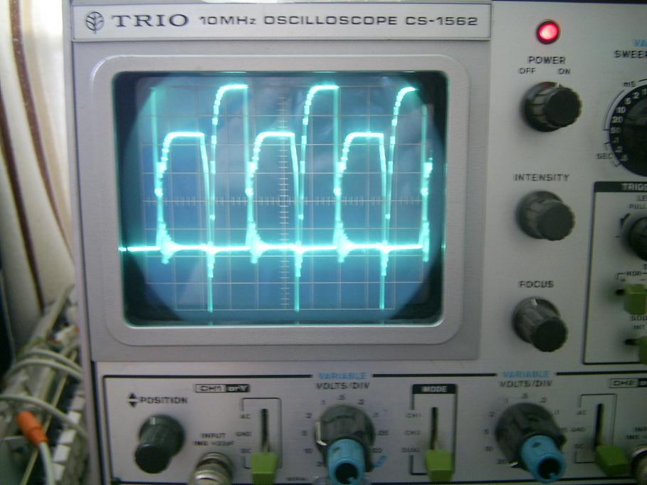

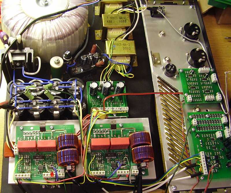

Now i have a working D-amp again!!😀
It´s too late to test it thoroly but it sounds good on the low volume i have now.
I´ll be back tomorrow with pics and scope shots.
