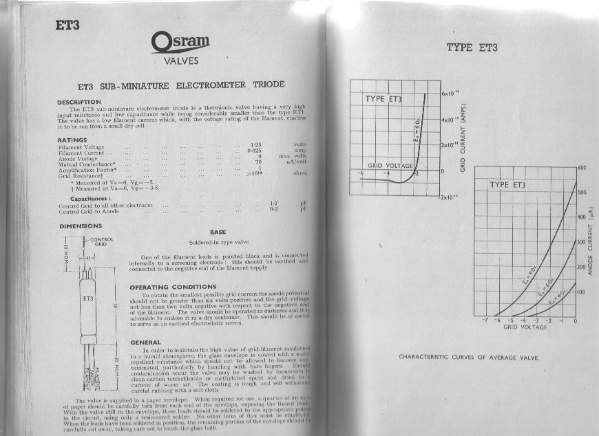

There is one documented application where ambient light does corrupt valve operation, though - Electrometer triodes!
See the GEC data for the ET3: 'Operating Conditions'
'valve should be operated in darkness'.
That's if you want your 10fA grid current, anyway.
I'll accept the word of a GEC/OSRAM data sheet as authoritative on that much.

I'm not saying you need worry about photons in a normal, practical amplifier.
The illustration is only there for those that don't accept the fact that the effect occurs at all - should anyone really be thinking so.
If you want to measure a photo flash event (in grid current terms), you must start with a grid current of, say, 10pA or less. Good luck finding some valves to fit that socket!

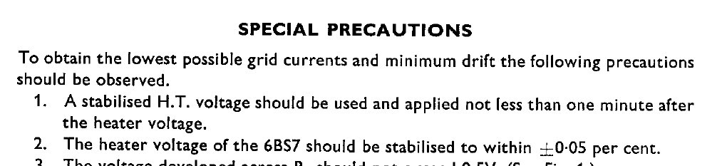

My diversion through electrometer triodes turned up something even more relevant, if we care to go back to the original question of the thread.
The attached extract is from the BRIMAR (Footscray, Kent) data for the 6BS7 pentode, a nice audio valve, that doubles as an electrometer tube, when selected samples were used.
See the precautions for electrometer use:
1. A Stabilised HT must be used and applied not less than 1 minute after the heater voltage.
The only reasonable conclusion we can draw from this warning being issued for electrometer applications is that grid current will not remain low if you ignore it.
The only explanation on the table for increased grid current in crash-started amplifiers is -
the van de Weijer effect.
A blob of emissive material splats onto your grid, for every crash-start.
