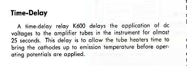

well, what about OSCILLOSCOPES?
Starting at the top, can Tektronix teach us anything? You don't need to look far.
See the 1960 Tek manual for the 551 scope with SS rectifiers and Valve amplification.
It reminds us that the best instruments need low noise valves and high stability generally. We are reminded not to replace tubes without a good cause, or put them in different parts of the scope. Why? Because you'll have the tedious job of recalibrating the scope.
Since tube noise and stability is important, do Tek care about HT delay?
They care.
"A time delay relay K600 delays the application of dc voltage to the amplifier tubes in the instrument for almost 25 seconds. This delay allows the tube heaters to bring the cathodes up to emission temperature before operating potentials are applied."
I suppose someone is going to stand up and say that the Staff of Tektronix were prone to superstition, or didn't know as much as you do.
Once again, it's your valves, and your money. Design at a level below commercial guitar amps as your model, or up with the best electronic instruments. There's no thermionic Police to interfere, so far as I know.

I looked at my Tektronix 545 schematic as I knew it had a time delay relay in it. The manual has the same claim that all tubes remain High Voltage off for 25 seconds.
The circuit is interesting in that they use the time delay tube to turn on a latching relay which de-energizes the time delay tube. This insures the 25second trun on delay if power momentairly drops out, and promotes the full 25 second delay. Without the latching relay de-energizing the time delay tube, it would be hot when power dropped out and the time delay would be considerably less.
That said, it appears to me that only portions of the High Voltage are delayed for 25 seconds.
-150V is delayed.
+100V is not delayed, and it's regulator is bypassed by K700 t horugh a 750 Ohm resistor.
+225 is delayed
+350 is delayed
+500 is not delayed, but it is stacked on top of +350, and it has part of it's regulator biased by -150, so it may come uppart way, but not to full potential.
