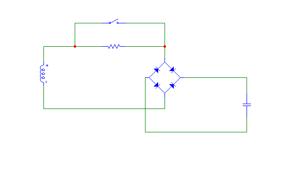

I've seen this somewhere too, in a nice commercial amp. The switch is a relay pole in that case. Guitar amps have used the same trick, but with a manual standby switch.
Not sure what happens at a low B+ though.
Sorry about the +/- indicators on the coil, that's micro-cap, not me 😀
