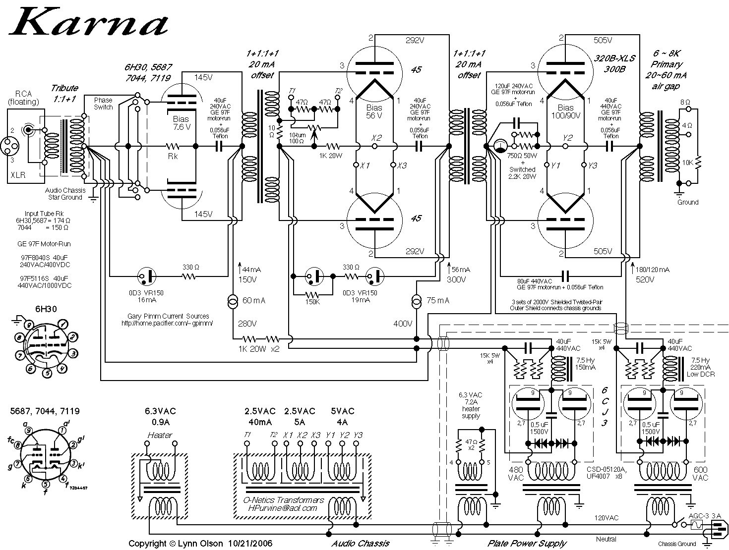

Can you please post a schematic of the way you use 6CJ3 as damper diodes?
Lynn Olson does this very thing, using solid state and damper diodes together, in his Karna 300 B amp. See the attached for a schematic.

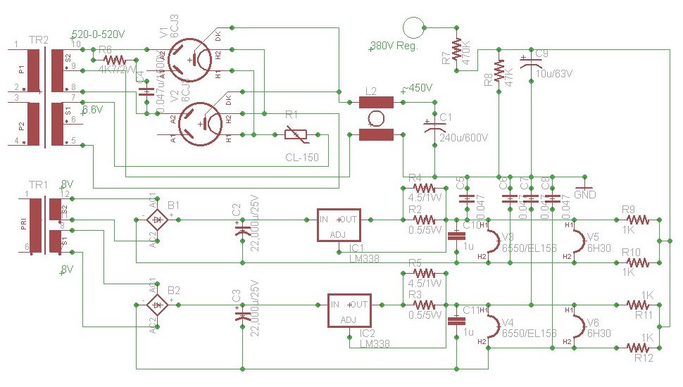

This is my idea for PSU for PP mono-block power amp having 2 6H30 tubes and 2 6550/KT88 or EL156.
HT is coming slow due to use of 2 6CJ3 tubes as rectifiers with additional CL-150 NTC Thermistor in series with the heaters voltage.
The amp tubes are being warmed slowly due to Constant Current Regulator. The current sensing resistor should be changed between 6550/KT88 and EL156, since the former heater current is 1.6A, while the later heater current is 1.9A.

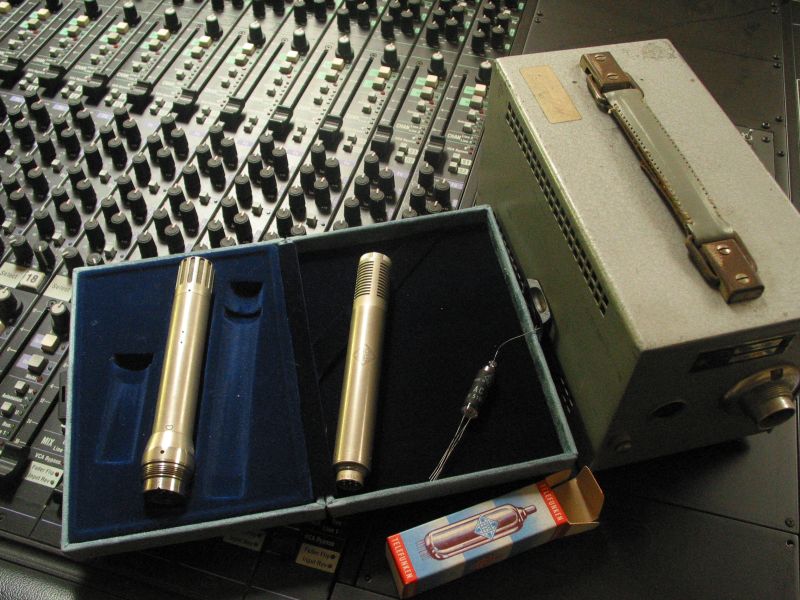

Like these?
On the left a Neumann KM254 with the German broadcast standard connector. They had to make the body of the mic bigger at the bottom to accomodate the standard connector which was used on all mics. The voltages were also standardized around the AC701 tube, such that a special U-67 was made (M269) with an AC701 instead of the EF86 tube.
They also were required to remove the Neumann logo plate due to advertizing laws forbidding "product placement" in broadcast TV. Somewhere there's a big drawer full of Neumann logos that would be worth a fortune today...
On the right is the Schoeps M221b which also uses the AC701 tube but has the standard DIN connector still available. Look closely and you'll see a Telefunken logo lightly etched into the body of the mic. That must have been OK because it's not obvious.
The AC701 tube has lead wires and is soldered in. The wire on top is for the grid, which is physically separate from the base wires because of the high impedance the grid circuit operates at. The tube spec is 50Mohms but they are used up to 200Mohms, with fixed bias. Obviously any grid leakage at all will saturate the circuit and cause all kinds of noise and distortion if there is any output at all. The AC701 is designed for very long service life under it's rated conditions.
The power supply on the right is the vintage unit made by Schoeps (or at least branded by Schoeps) for these mics. It looks a lot like a Neumann NKM. I also have some vintage modular supplies for these tubes. They have solid state rectifiers and apply plate voltege simultaneously with heater voltage...

Yep, that looks a lot like it! The 2 pair of Schoeps I used where not as directional, so not all the side vents. Can't tell for sure about the connector, but it was whatever the ORTF used back in the 60's. Had to build special cables for them. Power supply looks very familiar, too. Thanks for the pix. Are you still using these?
That is a power supply for really gentle treatment of valves!
only a couple of points about the schematic:
- rectifier snubber often works at 50 ohms nominal (select from 10 to 100 Ohms if you can measure the turn-OFF region of the rectifiers)
- current regulation of heaters is very kind, but regulating two in parallel may give problems with sharing. Could current-reg the two EL156 in series, and the two 6H30 in a separate series string, or separate regs for each (they're hardly expensive)
Thanks, Rod.
I'll make 3 heater regulators, 1 for each of OP tubes and one for the 2 6H30 in series. The power trafo is custom made, anyhow.
Once the amp will be built (it will take a while), I'll be able to measure with a scope the turn off region of the rectifiers. How do I calculate from it the value of the snubber resistor?
Thanks, Rod.
It escapes calculation really, unless you know the inductance of the secondary, and the storage charge in the rectifiers.
Kurt, (Zigzagflux) is the expert here. We try to measure the very short turn-OFF current as the rectifiers go reverse-biassed. Making a current probe (a little toroidal ferrite core with a few turns on it, and a single well isolated 'primary' turn, through which the output of the rectifier flows. Measure the 'secondary', loaded with 50 ohms on a scope at 500ns or so.
Adjusting the resistor value can minimise the little bump in the tur-OFF waveform.
Your power supply is very like the design I actually use. I use a separate mains connexion for heating, which is ON a minute or two before the HT - current driven heaters take a while to reach temperature.
