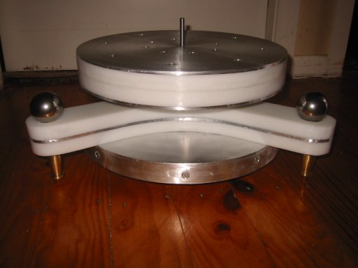

Hi all i have read most post with great intrest and got a great deal of inspration i had been toying with the idea of building a table for so time, after reading i decided to give it a go.
So the first thing i did was get a local engenier to make me a bearing i have ended up with a very close copy of the Teres Audio Bearing cost on this came in well under US$80 the outer portion made out of Bronze the inner out of Stainless
The platter and plinth are made out of layers of 4mm marine grade Aluminium and 19mm plastic chopping board all of these materials where scrap no cost
The spikes are maid out of modified brass plummig fittings cost less than US$12
The steel Ball Bearings dont do anything other than look cool
Any opinions good or bad are most wellcome.
