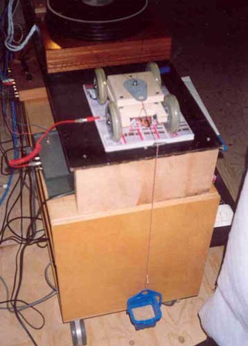

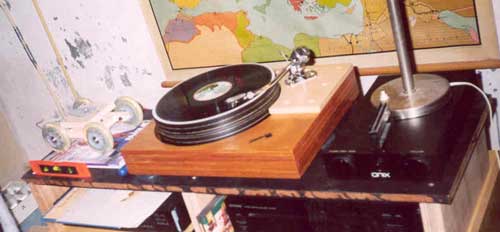

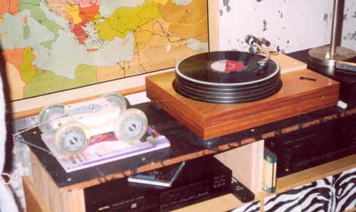

Music has been played on the DIY TT!!!!!!!!!!!
It has taken some time but it works. And as far as I can tell it works very well!
I hear things my Thorens TD125 never delivered.
At the moment though, it is a bit difficult to give you a serious estimate as to what this thing can do because the rest of my system contains a few too many questionmarks. Especially phono and power amp aren't up to scratch at the moment. I have taken (non digital) pictures. As soon as they are processed I will put them up here.
