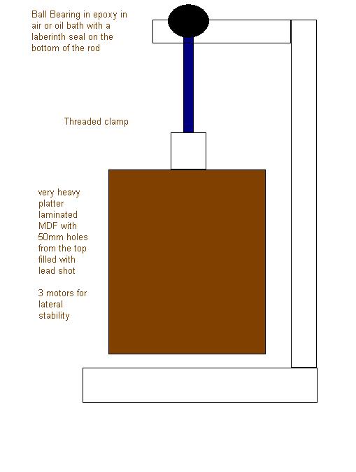

So far everyone has been looking at the platter and bearing issue from the bottom.
My thoughts are how about suspending the platter by the clamp in free air, much the same was at the Shroeder tonearm!

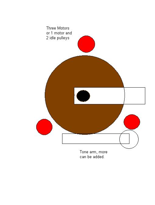

To keep the platter from oscillating, use three motors or 1 motor and 2 idle pulleys. And possibly magnets as well.
The only problem is the top bearing, but I think a big ball bearing in an epoxy air bath may work.
It would be time consuming to change records, but rests could be made 6mm below the platter and as the clamp is unscrewed, it lowers onto the rests.
The platter would have to be perfectly balanced and very heavy but it would be in the DIY KISS principle. And it would be cheap to build as only the platter has the work in it.
Any thoughts?

IT HELPS.
A good pic always helps.
Thanks Mark.
Not very practical I think though,you need to do a lot of work to change records that way.
Do you see any major advantages in doing it that way?

I have just finished reading all the thread. Lots of work has gone into this project and congrats to all who have built something.
As to my design, It would take the same amount of time to change records as any turntable with a clamp. The platter would have to stop rotating, unscrew the clamp, pivot it away, put on a new record etc.
With three pulleys, stability would not be a problem as the shape of the platter would not induce gyro precession. It would act like a rod. And above all it is simple.

Interesting concept. Build it and try!
I am wondering though about the play you have between arm and platter. Even if the platter will run stable it is not rigidly connected with the arm. Or did you solve that already?

No, the arm it is not connected to the platter, one would have to build it to see (hear) how it sounds? Once it is set up, I don't think this will be a problem. The belts will have to be rigid and no stretch, braided fishing line would be good, flexable, stronger than steel and no stretch.
Also the VTA will always be constant no matter how thick the record is, this may be a plus.
Please, keep up the comments, negative or positive as this design is definately outside the square!
