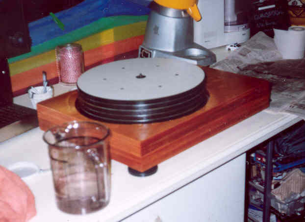

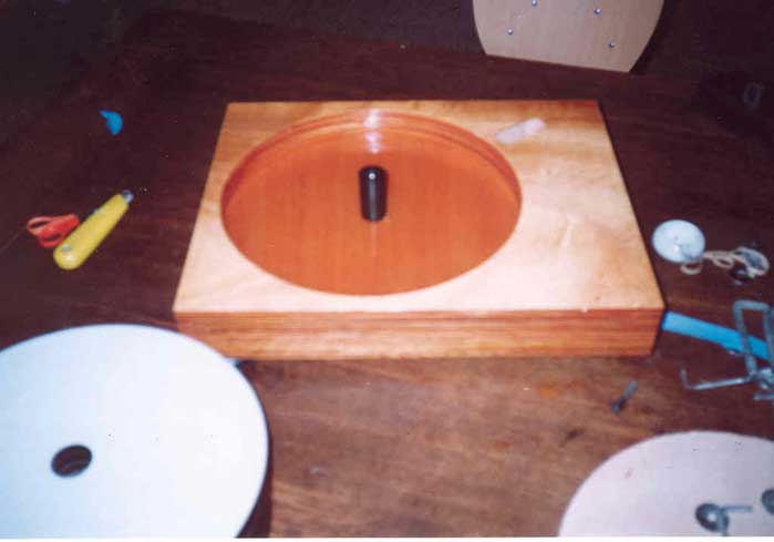

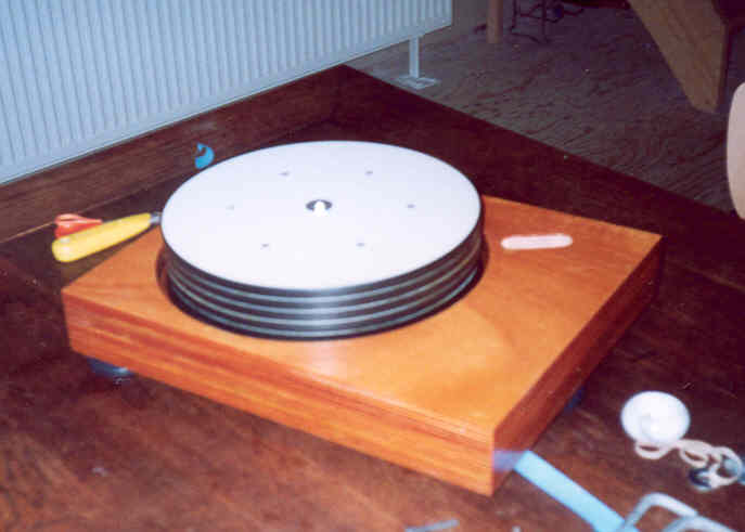

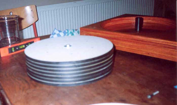

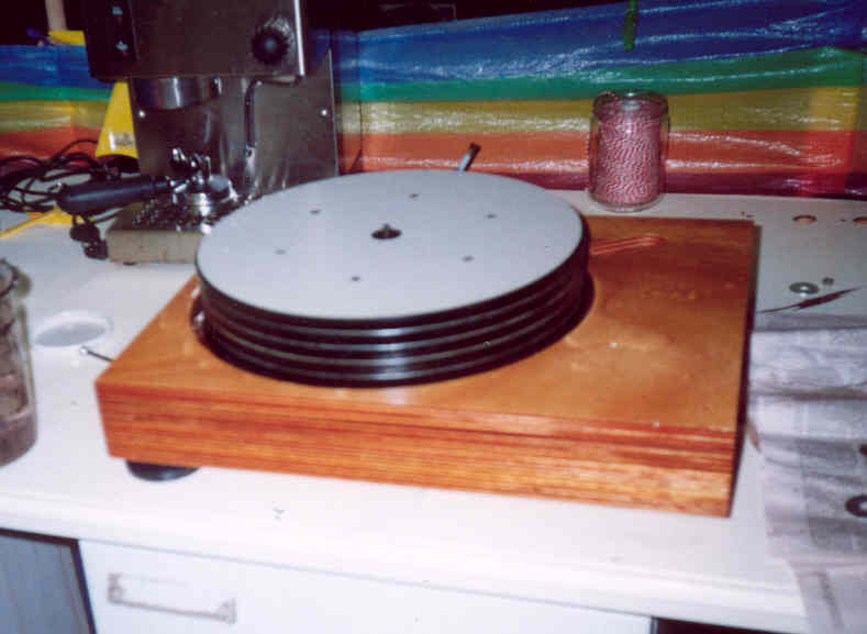

It has taken some time but at last I have a few pictures of my unipivot proto
Well, I have seen the DIYaudio TT . When it's done we can all fly in to visit and hear it! Congrats! Somehow I really think getting rid of the sleeve bearing might pay off! It certainly has simplified the construction! The massive center post is encouraging too
Peter, do you have a plan to get the platter very round? I'm tring to think of a clever home method. I wish you could just clamp a high speed drum sander next to it and rotate the platter- but since it tilts, that won't work....hmmmmmm Probably best thing is t o finish the whole thing, then take the platter to a machine shop for a final turning. Congrats again!!!

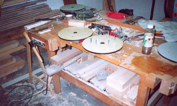

The discs I used for the platter were made on a big CNC-router at my work. It is normally used to make tabletops. So they are nicely round to begin with. To ensure that they are glued together as concentric as possible I used the six holes in each disc. I put a rod in each hole during assembly. this worked very well. All in all the platter seems to be just as round and well balanced as my Thorens platter. But I agree that to make it really round you will have to turn it :spin:
