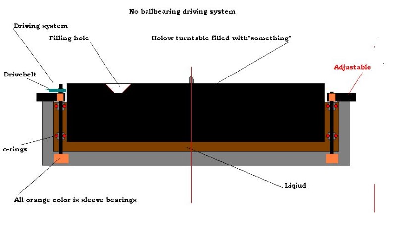

One thing i would do if i build a Ladegaard: i would feed the air to the slider, not to the rail. As i do it with my LT-1.
Of some peculiar reason haven't I noticed that you have a homepage nor your tone arm project. How far have you come?
Nice drawings, Illustrator?
leiade, do you mean that the dish shall float? If yes, not possible if the fluid is very heavy (mercury?) or the dish is light.
Also small O-rings as coupling between belt and dish, isn't this concept long gone? Too much wow?
Floating turntable
It depends, use archimedes formula and it will work,O-rings will not be the missing link it depends on the material used, O-rings with esoteric material can be find however very expensive.
Also small ring magnets of Neodymium will be used to lift the whole assy'.
The ring magnets can be mounted under the turntable and as this way be a type of decoupling.
Remember that many turntables used a perifier driving system some years ago, very often it was a kind of intermediate wheel with a sleeve bearing no damping liquid was found around it as it is in my "thinking".🙂
When the assy' is adjusted and started I can't see what kind of forces that can start wow in this design.😎

Floating turntableII
One thing I forget do you see the adjustable passive drive to the right this is the fine tuning device.😎
The floating Turntable III
This is my last comment as I can't write Turntable 4 in the Roman way on my computer.
Of cource we must use four or more of the passive fine adjustment O-ring counter forces.

Originally posted by peranders Of some peculiar reason haven't I noticed that you have a homepage nor your tone arm project. How far have you come?
Peranders,
it is still in the design stage, about 97% completed. But in the meantime i closed my jaws around designing a mechanical version of it, LT-2, no air bearing, completely different look but 100% same geometry and parameters collected with the LT-1 can be used for LT-2 and inverse. LT-2 design is 100% completed.
As i have very limited funds at the moment, LT-2 will be 1st. But i intend to make both a product. You may understand, i am not particularly eager to discuss possible products in public. Once they are placed on the market, this may become another matter.
Drawings are plain AutoCAD. Construction drawings, i work from those, i draft everthing in 3D. What you see are screenshots.
leiade,
nice idea! no, i don't tink this TT will have too much rumble.
Your friend added a magnetic bearing. Maybe you consider to add a Teflon/ruby ball axial bearing, couls ake your life easier.
