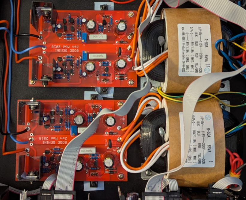

Thanks Vunce. I had a single Sparkos +/-15v PSU before the GG's. Going from one to two PSU's is probably not a fair comparison, but I prefer the GG's. Likely placebo, but it seems the stage is wider/deeper, with the sounds coming less from the speakers. The very low end also seems better. I have a vivid imagination 😉 and will be making more of these.

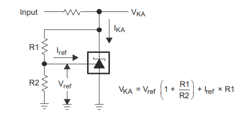

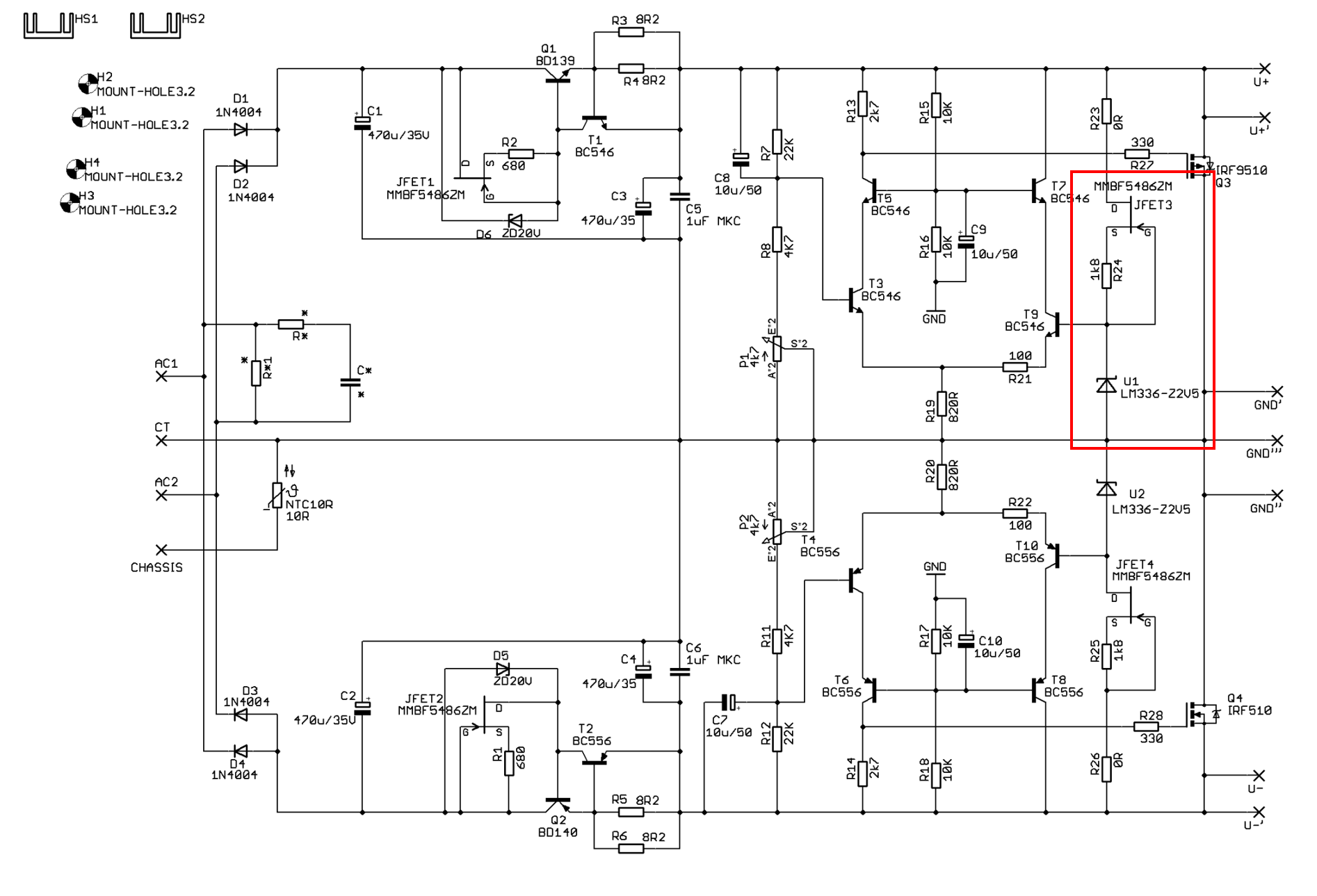

Can I 'buy' a clue? Starring at the Shunty cookbook but can't figure out the current through U1 in GG. I suspect JFET3/R24 handles it but don't quite grasp it. Yet.
So, pure guesswork on my part. Trained in bio-stuff not EE 😖
Voltage of the shunt set by:
Where Iref is from red square:
Apologies for cluttering the otherwise nice GG thread.
there is no need to fiddle with voltage reference
first thing first
what's load current, rail voltages and what programmed current is?
first thing first
This GG would be for the D1 I/V. So, load ~40mA and rail voltages +/-30V.
So, I would think programming the GG to 60-70mA would be plenty, say 10R for R3||R4 / R5||R6?
For the 30V, I am looking at increasing R7 but can't get the math right.
Lastly, C1-C4 would increase to 50V or more.
