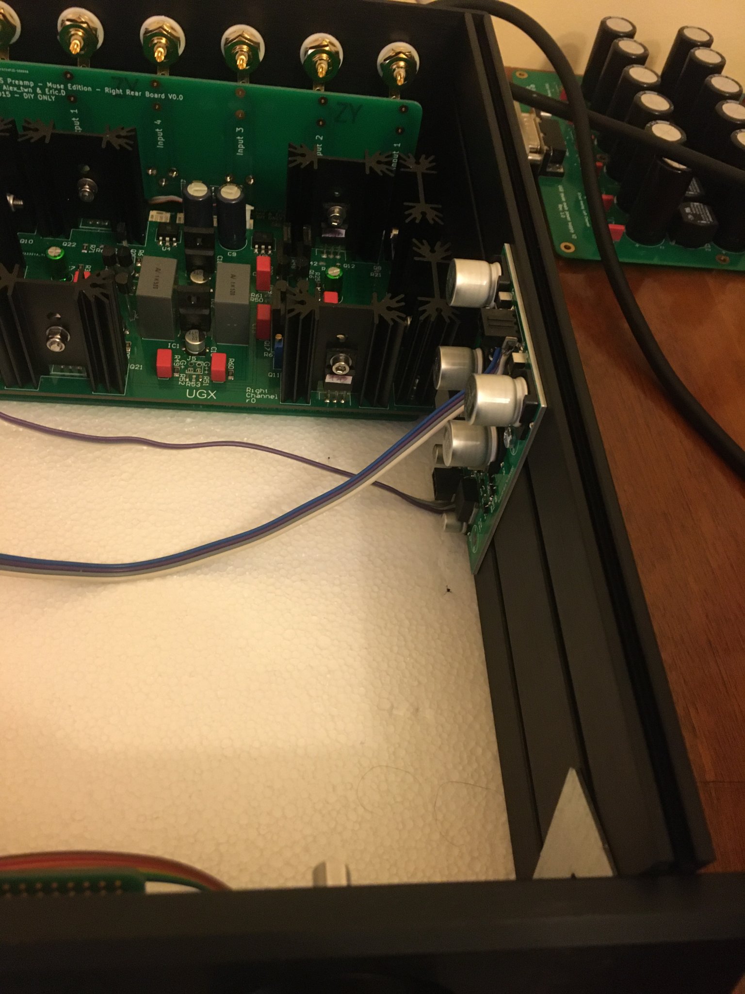

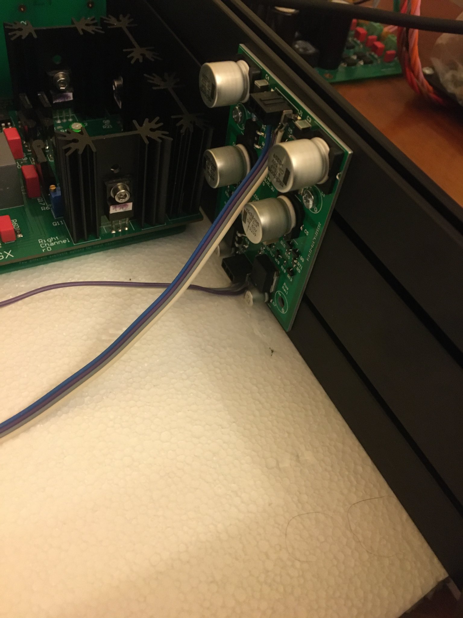

I can’t say the same thing about my regs.heat still not too high
They get 35v on the input and 28v on the output with 260ma current on the ccs for 150ma load.
I attached each reg on the lateral panel of a modushop 2u 28cm slim line enclosure and the panel gets pretty warm, I think it’s in the 40-45c range, this with the load connected. Having everything on an aluminum pcb keeps the temp on the pcb components close to that of the heatsink.
Please see the attachment.

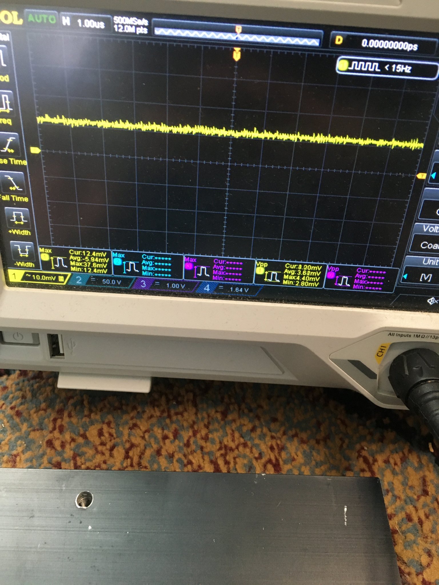

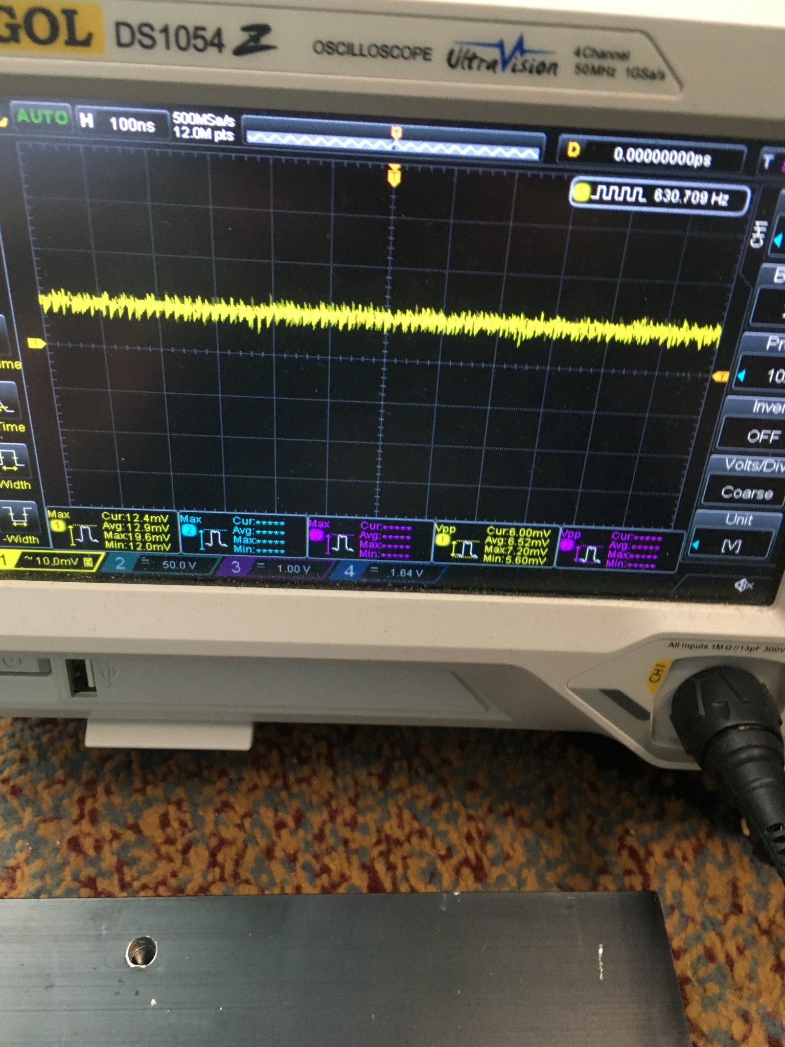

I managed to implement the Salas shunt without having oscillation in the circuit, tested with and without a load. Same as you say, I had to take care about how I routed gnd node and also output node. If interested I can share a print of the pcb. I didn’t get Salas permission to share the gerbers on the forum.pcb strategy and routing
I attached some printscreens of the shunt when powering the load.

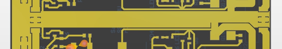

In the attachement is the GND, I used a similar approach for V+ and V-
