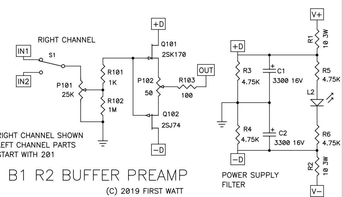

Gemini is wonderful! I'm creating a main board to easily swap between different preamp circuit. Main PSU will be GGSR. For B1R2 Pass buffer, should I keep PSU filter or could I wire directly GSSR to +/-D at Q102/102?
Zen Mod Official Court Jester Joined 2003 zenmod.in.rs/ Paid Member 2025-03-22 2:15 pm #143 2025-03-22 2:15 pm #143 Abx74 said: wire directly GSSR to +/-D at Q102/102? Click to expand... A Abx74 Member Joined 2011 2025-03-22 3:53 pm #144 2025-03-22 3:53 pm #144 OK thanks mighty ZM ! A Abx74 Member Joined 2011 2025-03-23 2:43 pm #145 2025-03-23 2:43 pm #145 Is it useful to put a "big" MKP capacitor (like 10 or 20µF) between GSSR and +/-D ? Zen Mod Official Court Jester Joined 2003 zenmod.in.rs/ Paid Member 2025-03-23 3:41 pm #146 2025-03-23 3:41 pm #146 naah Prev 1 … Go to page Go 6 7 8 First Prev 8 of 8 Go to page Go You must log in or register to reply here. Share: Facebook X (Twitter) LinkedIn Reddit Pinterest Tumblr WhatsApp Email Link
