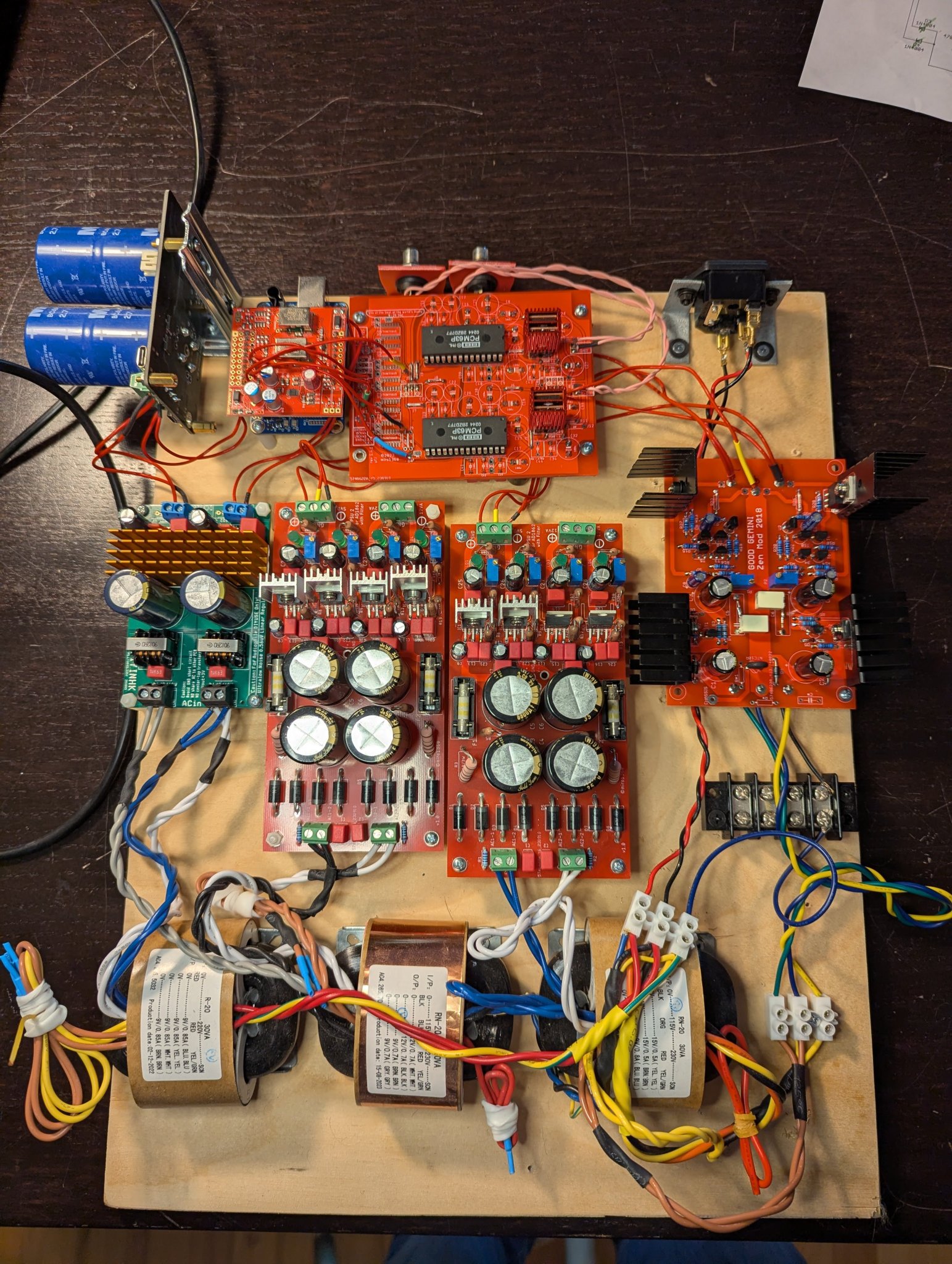

Update: Loving the sound of the Good Gemini! It replaced a Miro PSU2 (LT1963/LT3015) and in this position I slightly favor the GG shunt.

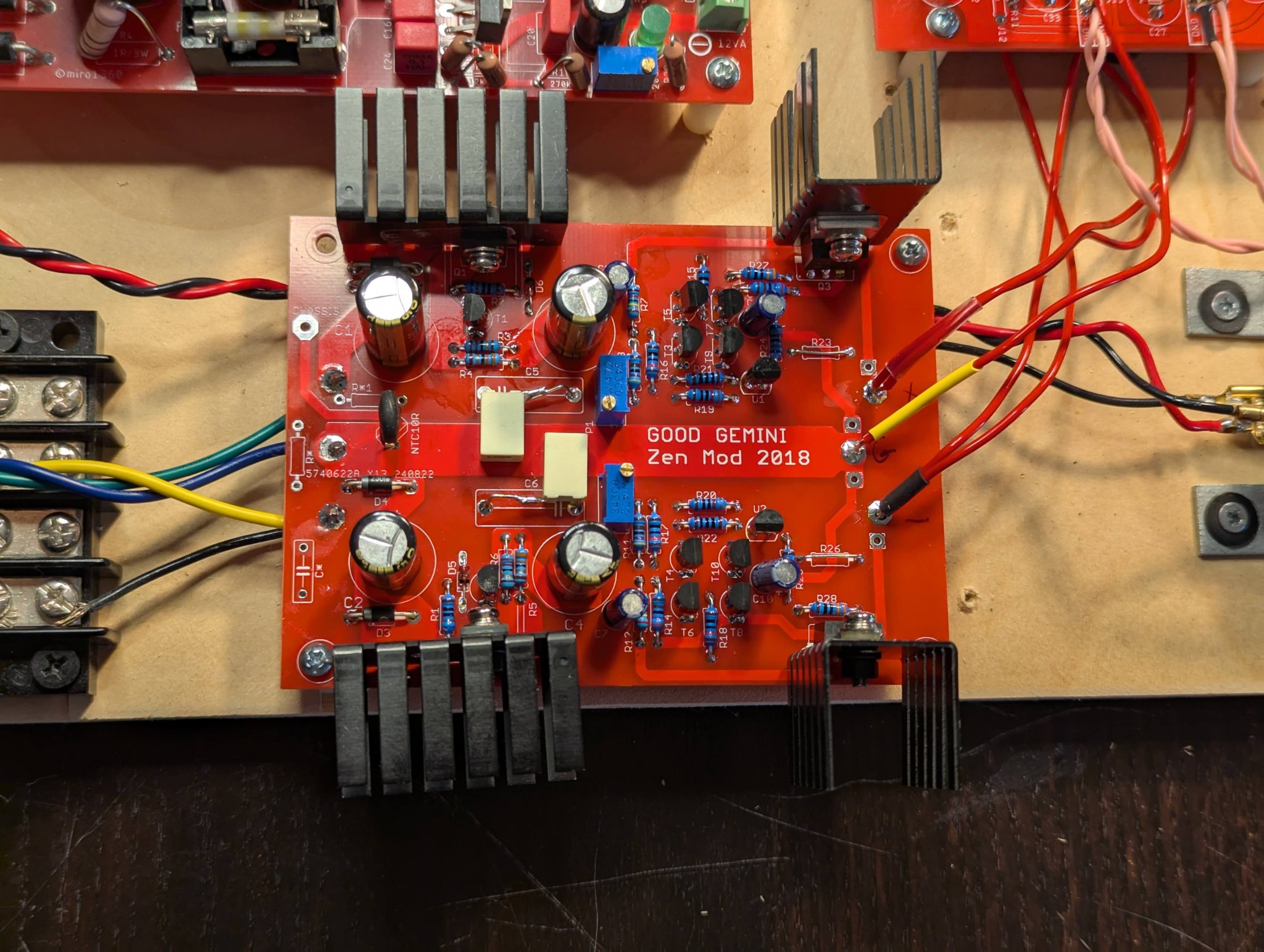

Quick question. Thinking of using GG shunts for a DCG3 pre-amp. It draws about 170mA/rail @17V. Would programming the Iq to 190mA or 200mA provide sufficient overhead for the shunt to function right? Maybe setting R3/4 and R5/6 at 5.6R and 7.5R.
taking in account that load is pure class A...... say that 210mA of programmed current is absolute minimum
reg itself is needing just few mA for function ( error amp, references) but from practical reasons, say that 20% of overhead is OK in this case
take care of dissipation .... as final criteria - use thumb or temp. meter
Thanks ZM. Will shoot for ~230mA with two 5.6R. Do you think the bottom plate of a 330x350mm galaxy chassis would be sufficient for keeping two GGs cool?

what's intended ( necessary) voltage of secondaries, and then working down ... voltage sag across CCS mosfet etc
for shunt mosfet - it's easy - rail voltage *(programmed current - load current)
so, 17V*(230mA-170mA)= 17*50mA=0W85 ..... relatively small TO220 hsnk is OK
say that your goal is 17Vdc at rails
let's see 18Vac secs
ZM's Thumb of Rule - with heavy loaded, mult. factor is in best scenario *1.25
so , you can expect 18Vac*1.25=22V5 after diode bridge
means 22V5 prior CCS mosfet, 17Vdc after
volt. difference is 22V5-17V=5V5 ..... almost covering or just covering even scenario of -10% mains voltage sag ( just proper engineering praxis to allow that)
5V5 and programmed current of 230mA..... measly 1W265 per series mosfet
even medium sized TO220 htsnk will cover that

Which is the lowest vdrop that you would use on this ccs ZM? Without including the mains variation.
Quick question. So, the 18vac trafo is actually 22.5vac with the load of the shunt. Per ZM's logic above, this means something like 11.5v voltage drop and 2.7w heat dissipation for Q1/2. The heat can be managed but is this too much of a voltage drop? Most days, the pre amp runs 12 hours...so would want to make sure it has longevity, even if it means getting two lower voltage trafos.

Thanks ZM. The heat is manageable. It is in a temporary layout (=mess) for now, while I figure out how to organize the pre amp. Are 10 cm power wires between the shunts and DCG3 OK, or too long?
