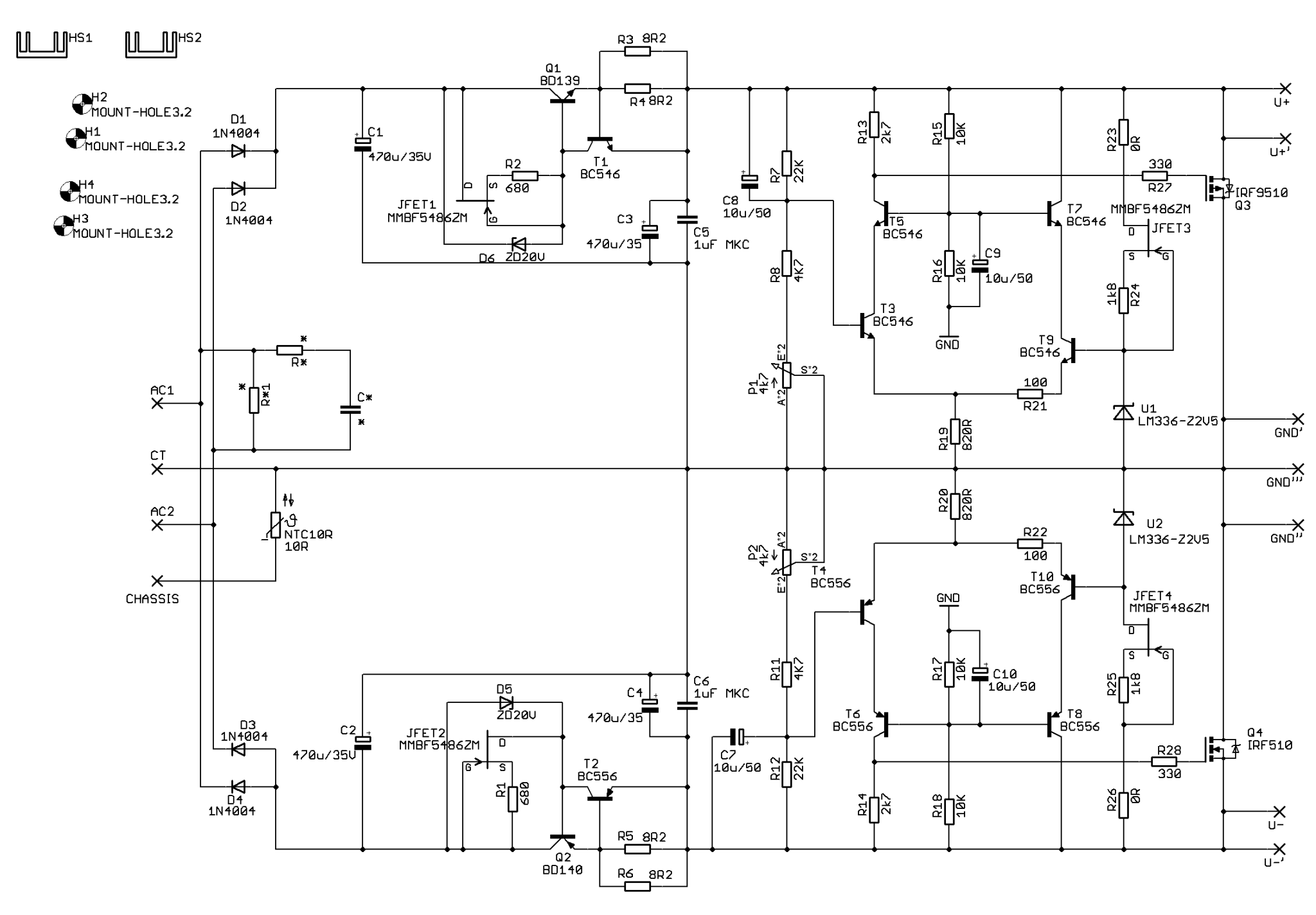

Finally got around to putting together a GG for powering opamps in a DAC. It was spec'ed following the schematic below but tops out at 14v. Ideally, it would be 15v so likely need to tweak a couple of resistor values?
Thanks for the swift reply!
I don't know if I quite understand the calculation for the current. R3/4/5/6 are 8R2. Could mean that at 14V current is ~300mA?
OpAmps are Burson v7v and from the datasheet, it seems they draw as little as 10mA.
Pardon my ignorance ...
T1 maintaining 0V65 across (R3//R4)
same, T2 with (R5//R6)
so, programmed current is 0V65/resistor group
say that you have 2 Bursons, sum being 20mA
reg circuit itself is needing few mA to work
programmed current in reg must be Load Iq (Bursons) plus overhead current (burned in Q3, Q4)
in this case, minimal overhead must be at least the same as load Iq
so, programming for - say - 50mA (per each rail, logically)
0V65/50mA=13R
so, say, R3= 22R, R4=33R
same for R5, R6
in case of 4 Bursons, shoot for 80mA of programmed
0V65/50mA=13R
same for R5, R6
