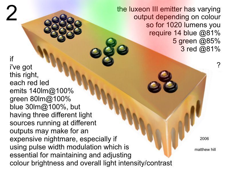

Surely if you're using colour filters, you'd be filtering out most of the available light when using white LEDs?
By using an array of red, green and blue LEDS, would you not get maximum efficiency for each LCD panel by bypassing the filters?
By the looks of those pocket projectors, RGB LEDs give an excellent colour gamut too.
bad terminology again, by pre coloured i meant red, green and blue leds, i agree, probably the best way to go, as you may have seen previously in pictures i've done, you may need different amounts on each channel, as below...

I thought so! I just saw the picture, and assumed you'd gone back to using the filters. 😎
I've seen your other designs on this forum and on the other forums. Excellent pictures btw, what software do you use to do the 3d look?
RGB LED's are definitely the way to go as you should get maximum efficiency plus the ability to control the colour balance. RGB is also ideal for DLP projectors (if I can ever figure out this colour wheel software!)
I can get the RGB channels to switch in a pre-defined sequence which means you can set the timings of red, green, and blue to match the proportions of these colours on the original colour wheel. (You can also add white if your original colour wheel has a white section.)

yeah, i love the idea of being able to skew the colour balance @ the leds (by brightening or dimming a channel individually), very cool, plus, being able to adjust overall brightness at the same point would be ideal, i can imagine being able to leave the projector settings at 50% red, 50% green 50% blue and 50% bright, and doing those adjustments independantly of the projector software
something instinctively informs me that adjusting the brightness at the lamp, will improve contrast, i can't back it with sound theories, i just think it'll turn out that way
as far as pwm controls go for muppets like me, i'd like to see a dial for each channel, like a volume control...if it could be done and would be cost-beneficial, perhaps there could be analogue dial/controls, with rotational travel describing output to obviate the need for output displays...i.e. with the dial turned full anti-clockwise you'd have zero brightness (or close to zero as pwm allows), fully clockwise turned dial being full power*, and midway between the two points 50%
*although it may be important to limit 'full power' to 80-90% max, for led junction longevity
