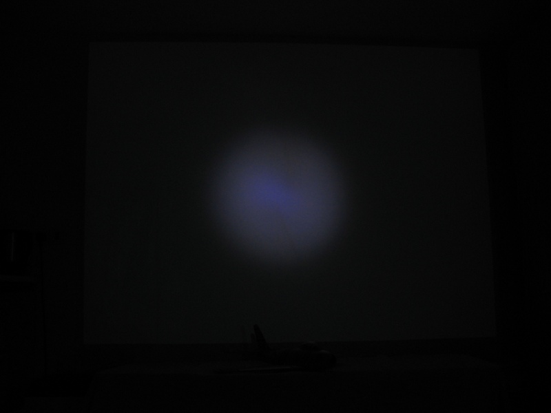

here's a picture of the 'bright spot' generated on my blacked screen image from one of the leds i have...

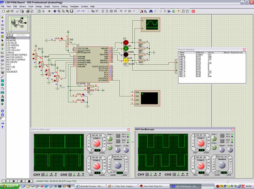

Hi everyone,
OK, so I'm getting more enthusiastic about using LED's.....
I've designed a basic PWM circuit around a PIC chip.... At the moment, I have four PWM outputs working and can probably go to eight or more with no problems....
The speed isn't too great at the moment, so the highest switching frequency I can get when using 20MHz crystal is only around 200hz. This would likely cause problems with sync on projectors, but this is a work in progress at the moment and just to see if I could do simultaneous PWM in software.
If you wanted a higher frequency, you might be better off with a dedicated PWM chip. The PIC chip does offer things like a serial interface and ADC's etc.
I've attached a screenshot of the design. You can see the four separate PWM waveforms on the oscilliscopes. The duty-cycle on these outputs are set by the four potentiometers connected to the ADC channels of the PIC.
To add the other PWM outputs, you'd need some way of setting the duty-cycles on each output. Once I've added the serial routine, you would be able to set all the duty cycles via the serial port to a PC. The PIC would then store these values in non-volatile memory (EEPROM) for when it next powers up.
This would be ideal for colour balancing with an RGB LED array.
You don't necessarily need the potentiometers, it's just an example of how they would work. The serial interface work of course give ever-so-slightly more accuracy, because the duty-cycle values would then be digital. Potentiometers wouldn't really drift more than "1 notch out of 256" anyway.
The LED's in the screenshot are also just for testing. The idea being that you'd put a MOSFET on each channel, then use each MOSFET to switch (dim) an array of LED's.
MOSFET's can switch fairly huge amounts of power, but you'd need a small heatsink on them.
Any suggestions for the PWM board are welcome. I'm not an expert on this stuff by any means, and many of the ideas for the software routines are from Interwebnet sites.
What would anyone want to add to the PWM board? Would most people be happy with just serial control, or would it be an idea to add buttons to control the PWM outputs? You could a small LCD screen, but this is slight overkill, and would add to the costs.
