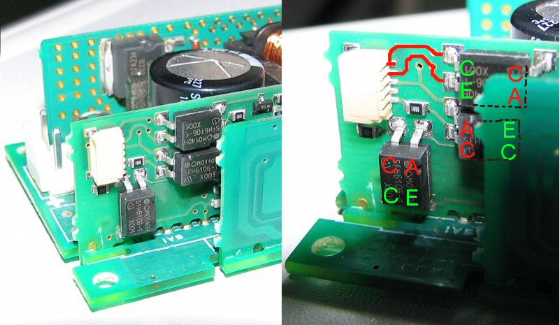

i really think it's working !!!
an hour and a half now, and seemingly normal lp250 operation, except for the lack of heat and light !
shining a bright torch in the light engine opening reveals a murky but changing image on my palm in front of the lens
the two terminals marked by OzOne in red, or the corresponding wires need to be linked together, then the lamp psu/ballast can be removed and not needed
