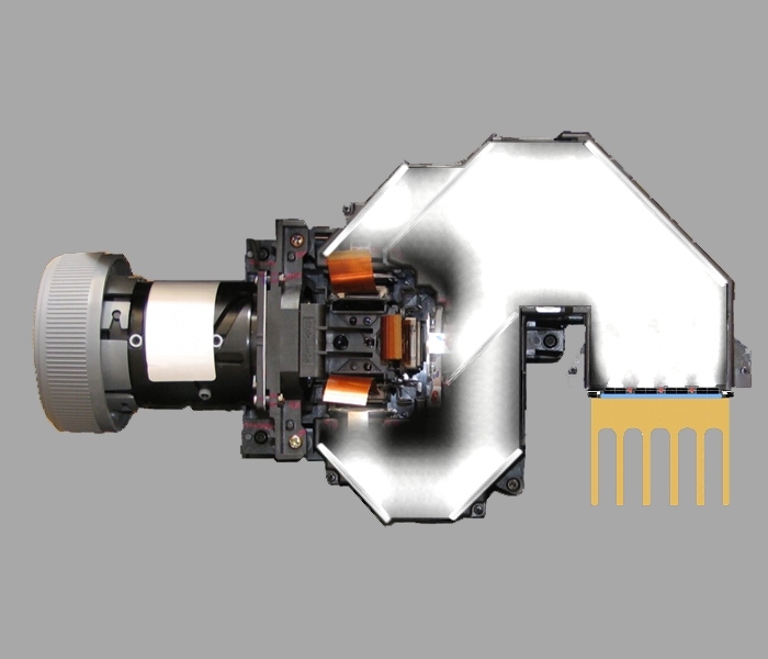

below is a picture of the complex path the light from a white led would have to take, negotiating filters and possibly polarizers and losing much of the output

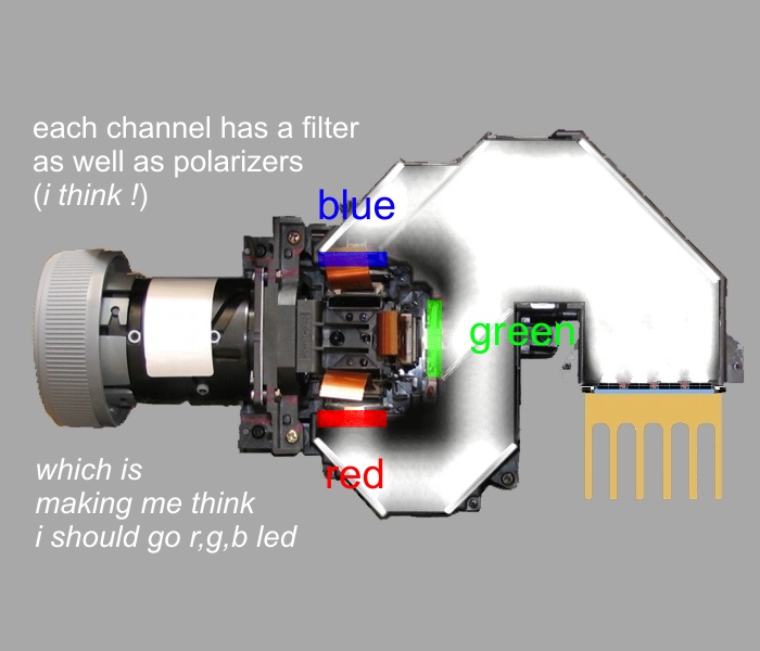

I cant really tell how your projector works by the diagram. Can you tell if there are green, red and blue filters in place already? That would be the only situation that would give you the option for what you are planning.
If thats not the case, and the light from the original bulb was just reflected 3 ways, then maybe just do the same setup as you have except with white LEDs for all 3 sections instead of colored ones.
Basically its kinda hard to give advice when we have no idea how the projector is projecting through those LCDs and what each of the LCDs is displaying, so maybe work on figuring that out more before deciding what to buy.

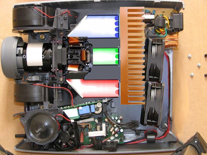

okay, i've seen photos of the inside of sanyo z4 lcd front pj, and it has in order...the lamp, what i have been told looks like a shatter guard, then there's what looks like a polarizer or uv filter of some kind (has weird rectangular sections within it), then a mirror to reflect blue light somehow (with polarizer ?) to the upper lcd which has a blue filter that should be removable, at the point of the blue mirror, yellow and red light continues on until yellow reflector which sends light through green filter to 'green' lcd, and finally the red goes through a red filter to the final 'red' lcd
i now think that my best option might be to use the three rgb colours from start and rip out the filters/polarizers etc

Looks good man. I think actually going red-green-white might work well, as the filters after the white would probably reduce ouput significantly. Thanks for the linky too, its cool to see how these commercial projectors work.
Anyways, I would recommend red&green&white for best efficiency, although you might have to play with the resistor values to get a more accurate overall color balance.
Keep it up, the plans look great.
