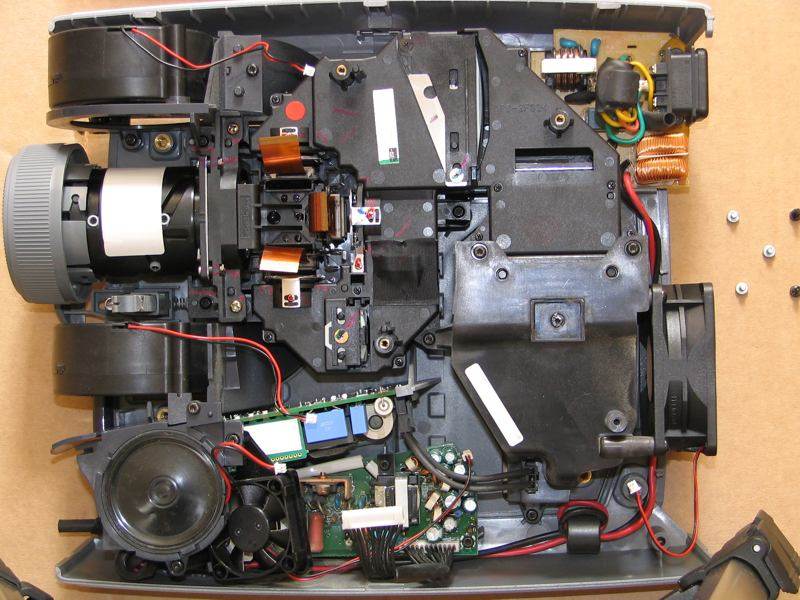

i took the first tentative steps toward taking my lp240 apart...(you can read more at av forums uk )

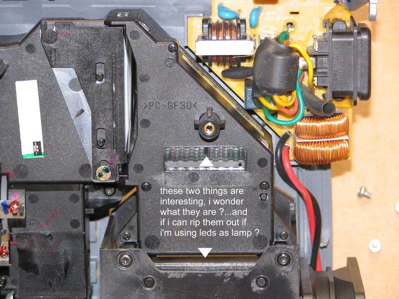

Those two things you point to in your photo of the lamp assembly look like plastic lens which help focus/disperse the light so that it is as even as possible. I am just guessing, but I think that is probably what they are for and I would not imagine that you can do without them entirely, or at least, not without something that performs that function in some fashion. Also, in all likelyhood, the dispersion pattern of whatever LED lamp setup you come up with may be different than the dispersion pattern of the bulb that the projector is designed to use right now.
Anyhow...good luck in your project 🙂
