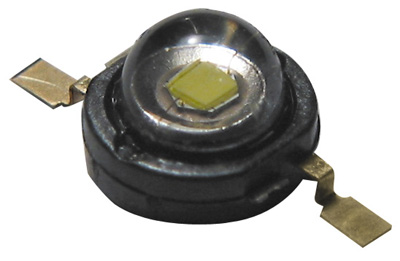

using luxeon III emitters (80 lumens each), i think i might be getting somewhere close, as 16 of these will fit into the required space and emit 1200 dimmable lumens
my (a bit vague) ingredients which i am told may be slightly cheaper than i expected here (don't know exactly how much cheaper)...
*the leds have dropped in price*
16no lxhl-pw09 $3.45/£2.06/£2.42inc vat each?????£40
plus dimmable power supply/drivers ??????????????£40
plus ancilliaries/heatsink ??????????????????????£60
total ???????????????????????????????????????????£140
price is something along the lines of an estimated £140/$200us
heres a link to the Luxeon III Emitter - LXHL-PW09, White 5500K, 80 Lumen, Lambertian led http://www.lumiledsfuture.com/produc...cfm?familyId=7

hi stelleg151
i wonder if you could supply a link to your 130000mcd leds...are they the same luxeons ?
thanks, matt

I think starting small and building bigger is a great way to go. I was suggesting the use of the Luxeon K2. It has a lumen output of 113 at 1000mA (3.42V). So that's a little under 3.5W. I've been trying to find the mcd rating for these LEDs, but the results were varied.
To quote www.superbrightleds.com:
The Luminous Flux (lumens) from a light source is equal to the Luminous Intensity (candelas) multiplied by the solid angle over which the light is emitted, taking into account the varying intensities in different directions.
